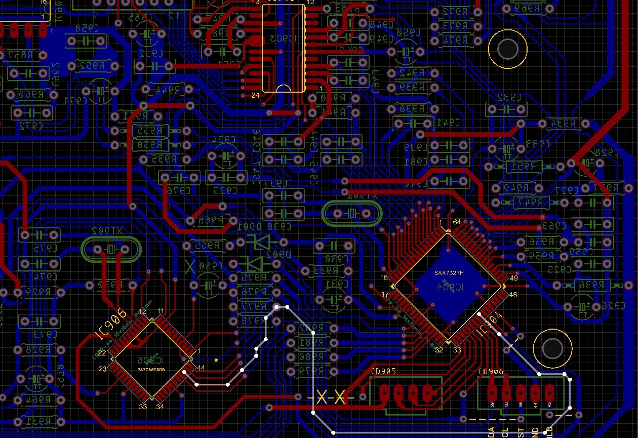

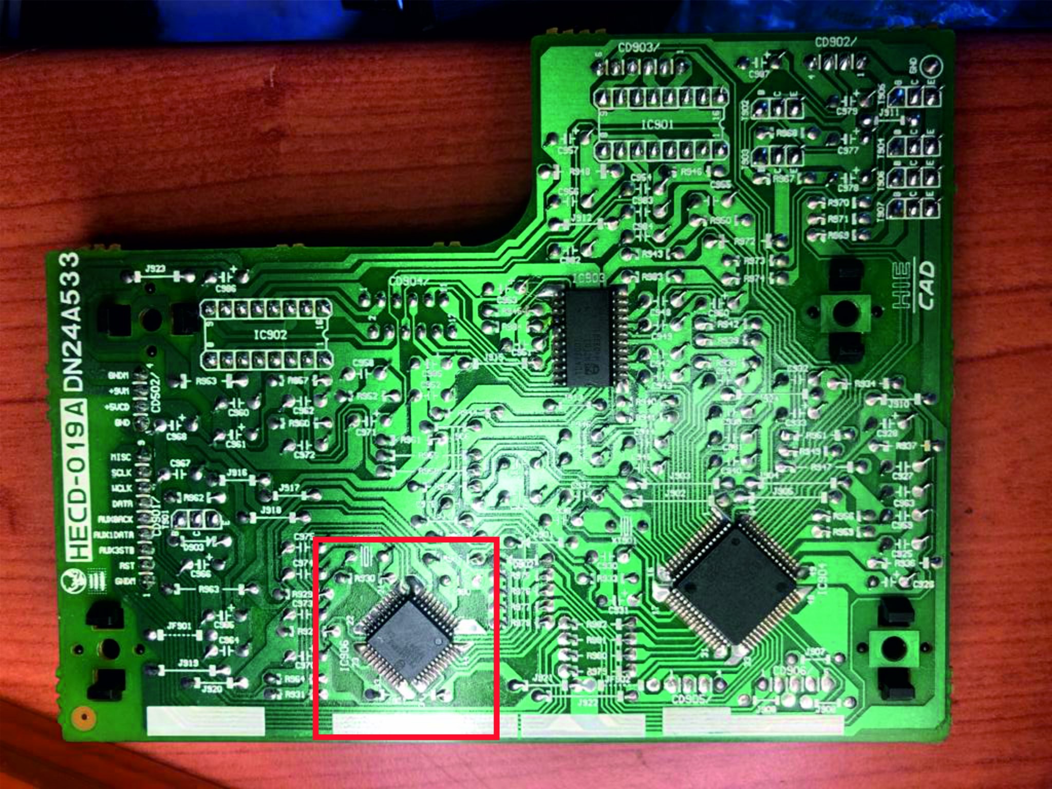

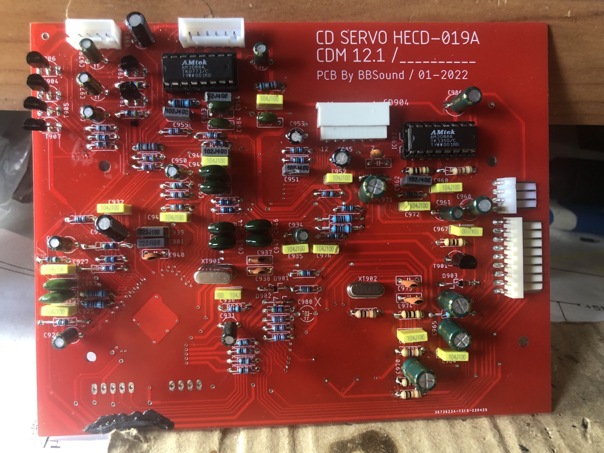

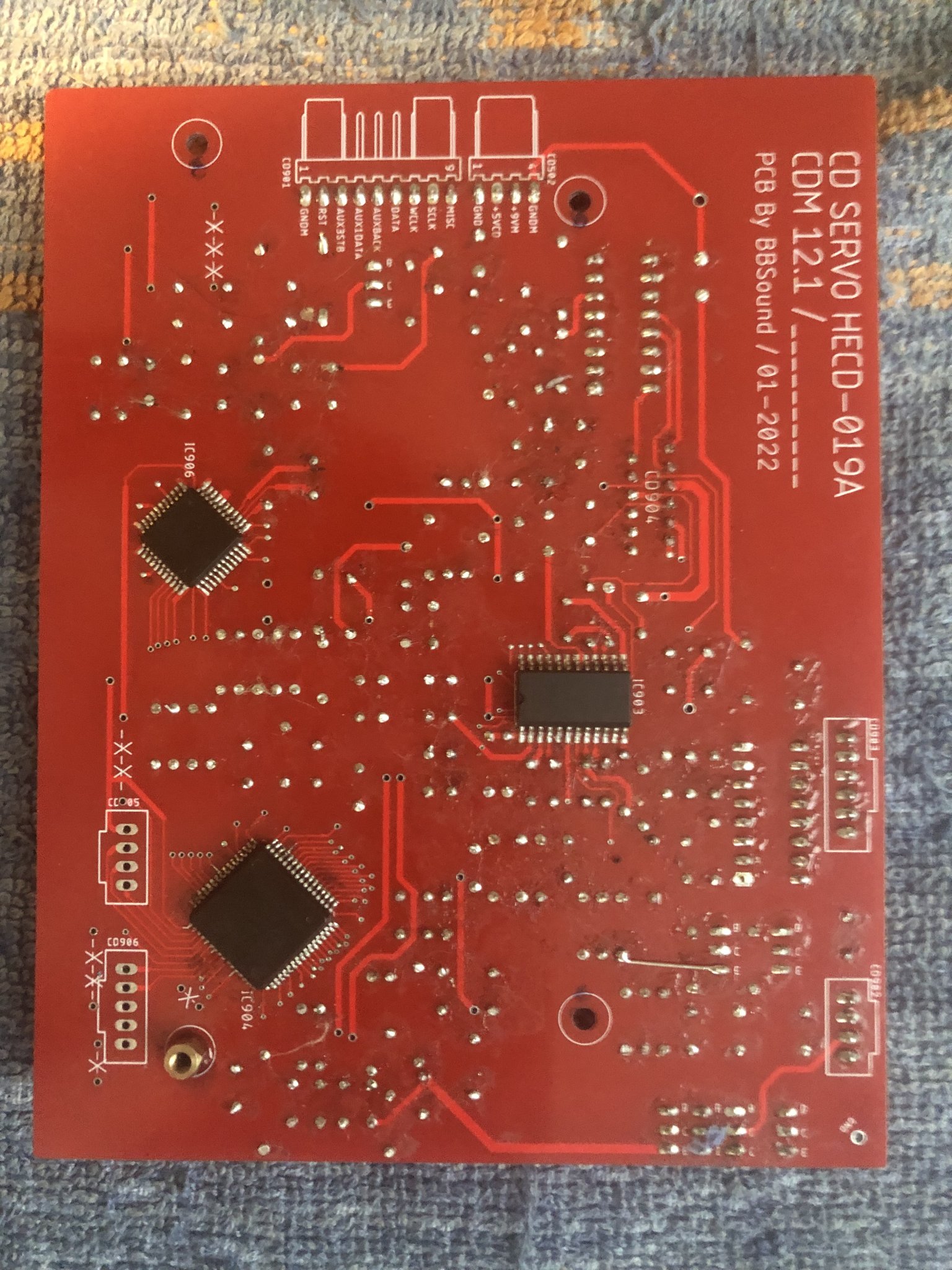

I cloned the HECD-019A servo board for the tested and working Philips CDM12.1 mechanics.
Now I find myself with a problem.
I had to remove the P87C58 micro controller from the original board because the LQFP44 version is not for sale, I was able to find the PLCC44 version chip that I mounted on the new PCB but it does not work and therefore to make the prototype board work I had to remove it from the original board .
Now a doubt arises, does anyone know if this Philips controller, the P87C58 has a part of memory and therefore must be programmed?
Thanks for your help!

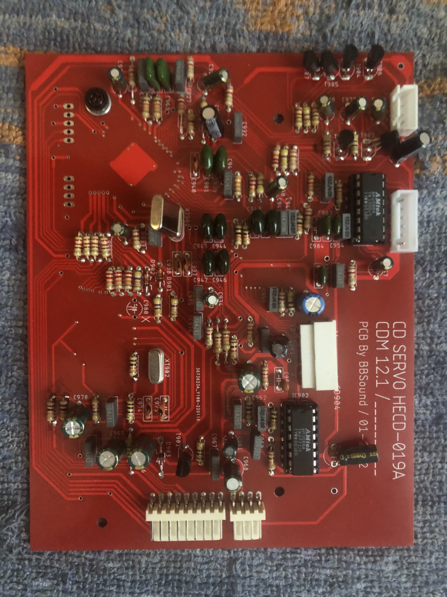

because I am designing a customizable cd / dac player with both tubes and transistors with this mechanism which in my opinion is reliable and "cheap" and easy to find the laser, based on a simple and functional Audio Fidelity CD A3.5 project and firmware copyable to a Pic 16F88 that I have already done.Just a question : why ?

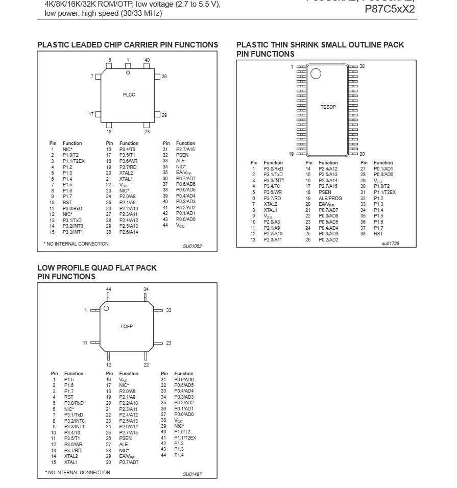

The problem with the servo controller of the mechanics is this 32K Philips P87C58 eeprom, as well as not being easy to find in the LQFP format I found it in PLCC version with different pinout and mounted respecting the pins but it doesn't work.
My question is if this P87C58 is programmed or if it initializes and only serves to store the axial parameters of the laser and the CD reading data.
Unfortunately the wiring diagram of the mechanics is not available on the web, this is the reason for the question.

I forgot to say that I would have ordered the Eeprom 87C52 which would be the 256k version, the P87C58 is instead 32K, the format and the connection pins of the two Eeproms are identical LQFP, they differ only for the memory.

Yes, it needs to be programmed. The previous VCDs of Philips have mask rom program versions, but their pins are different. Their models are OM5234/OM5284, marked CDT612 or CDT713, which are all DSA protocol interfaces. There are many such boards in China, because VCD was very popular before DVD! Without this control chip, your board is useless. Ten years ago, there was a forum in China called CNDIY CLUB. They had a project (not open source) that used MCU to directly control SAA7324, but that forum was closed a few years ago.

I have a problem that I can't solve, the philips marked Eprom P87C58SBBB. We need to find a way to copy the internal storage otherwise the project doesn't work. Better said, it works in case the Eprom Philips P85C58 is unsoldered from an original servo board and the Eprom soldered on the new board that I copied. The card I cloned works with all the chips I bought new.
I found a supplier who has a lot of P87C58SBBB in stock, so finding the philips Eprom is not a problem.

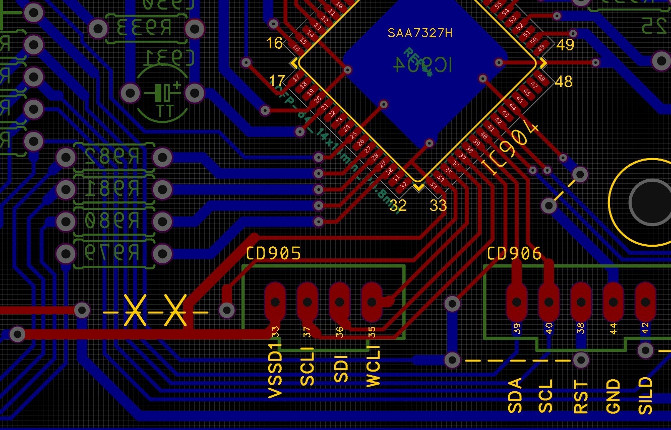

1. you must connect 4 channel oscilloscope or logic analizer to pins 39, 40, 41, 42 and may be, 43 of servo SAA7327.
recording bus exchange while playing.
recording bus exchange while disk starting
recording bus exchange while power on servo initialising and autocalibrating
recording bus exchange while rewind and track change.
Its look difficultly, but its the good way.
2.I use simple Arduino IDE and Arduino UNO for starting. In finish, i use ATMEGA32A for control the servo. My scetch is free for use.
You must read SAA7327 datasheet paranoicaly from page 28 to page 48
all command on page 46 in table 17

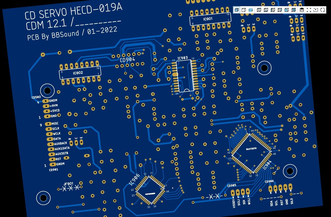

regarding the pins connected to IC904, the SAA7327 as you can see on the PCB project that I created by copying the original servo PCB there is a connector with 5 pins connected to the CHIP at pins 39 40 38 44 42 which however exclude pin 43 which is not connected to nothing.
pin 41 does not go to the connector but directly to pin 42 of the IC906, the Philips P87C58 Eprom.
