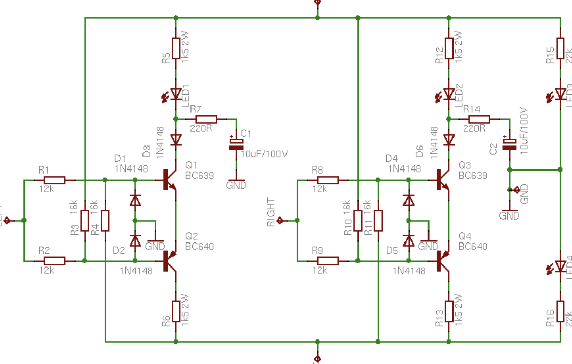

Clipping indicator schematic needed
Another very good, very simple one is the Leach clipping indicator.
2 transistors, some resistors and a few caps.
There’s a layout on this site The Leach amp 200W amplifier

At what levels should the clipping indicator turn on? For a bjt output stage and +-45V rails should the indicator turn on when output reaches about 40V?is this a good point?
In principle, with "decent" clipping detectors like the ones presented here, it does not matter: the indication is relative to the supply rails, and will adapt itself.
All you have to do is to decide how close to the rails the output is allowed to go before it is considered as clipping.
The margin is adjustable, thanks to the resistors in the Leach circuit, or the zeners voltage in my circuit.
If you chose a too small margin, the LED will never light, because the amplifier will be unable to swing close enough to the rails. This depends on the amplifier, of course: a MOS amplifier might need several volts.
