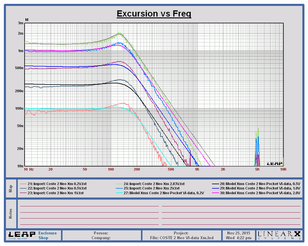

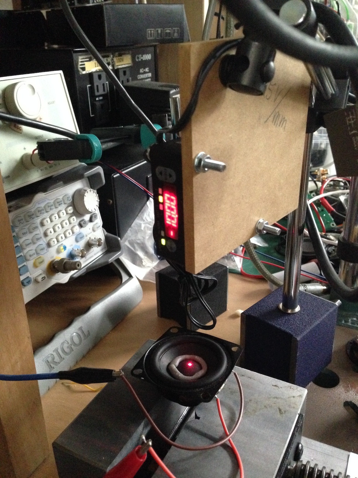

Today I compared simulated excursion to measured excursion. The LTD driver model was created in EnclosureShop (ES) using VI-data obtained CLIO Pocket. Pocket was not in loop-back mode for impedance measurement. Its output was connected to an amplifier and input was used to measure voltage across driver and the current shunt, respectively. The current shunt was a 1 Ohm, 1% power resistor. Impedance was calculated using math function in Pocket's software. Different driver levels were used to obtain a set of impedance and voltage curves.
Impedance and voltage data were imported to ES to generate a LTD model for the driver under test (an inexpensive 2" full-range as shown in the picture). CLIO Pocket was also used to measure analog output of an laser displacement sensor for excursion data. The curves below show simulated and measured excursion data. They are closely matched. The model nicely predicates increased Q for higher driving levels.

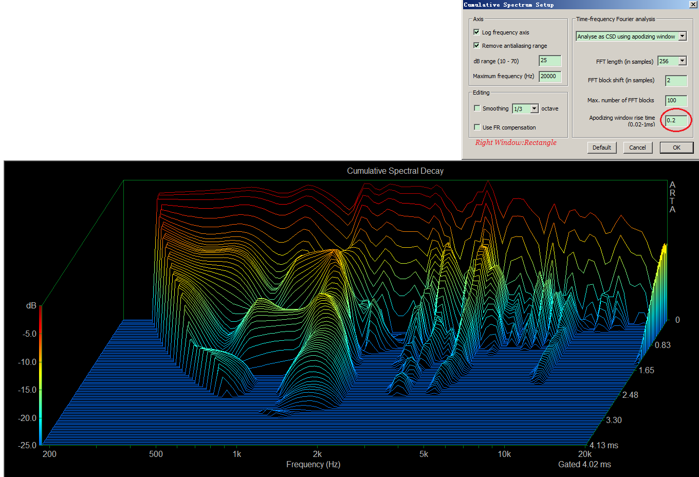

Hi,Panson
Recently I realized that the CSD plot in REW is sightly different than that in Arta.
Here I upload the images and IR wave file that can import and view them carefully.
Unfortunately,I have not accessed the clio pocket so no chance for me to compare with them for accuracy.Furthermore,I didn't know about clio pocket whether .wav file can be imported.So if you got the time,you could make some comparisons between them on the CSD functionality.
Yes,the core functions in Arta and REW (also Clio)such as Tansfer Function,IR response,TS Parameter extraction,Distortion measurement are nearly the same
that makes no concern of the divergence,just each man has his merits in different aspect. Usually be in conjucated with several tools you will know grasp the peculiarity they own.
Panson,if you get the information then I am willing to hear from you,thanks!
