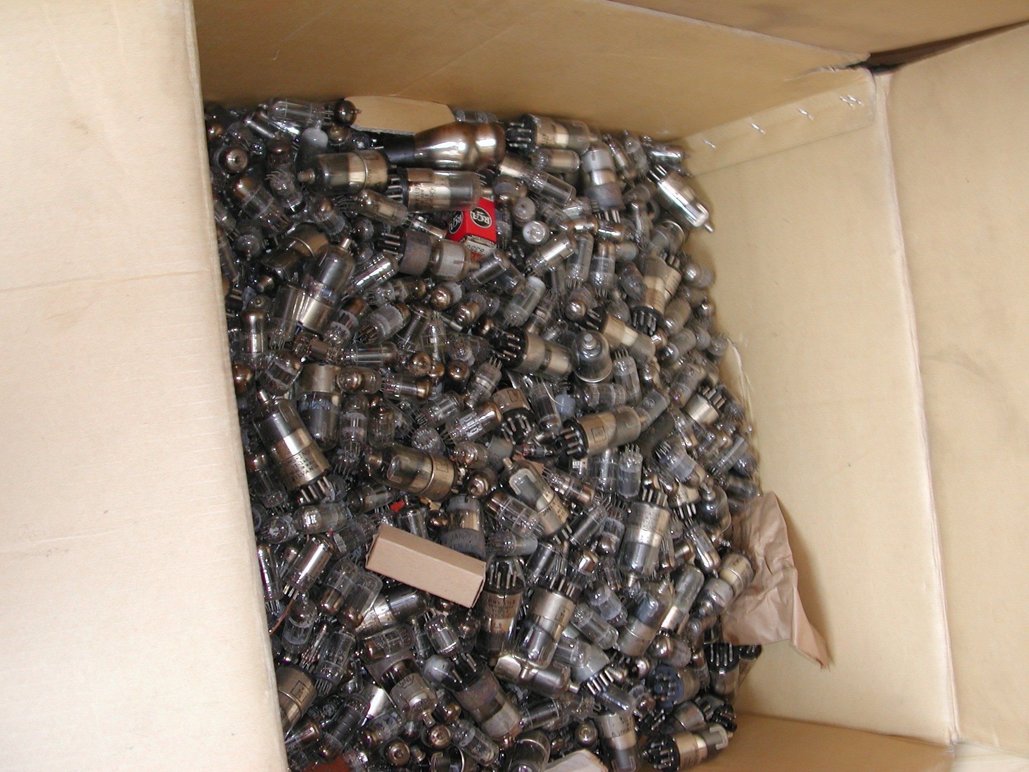

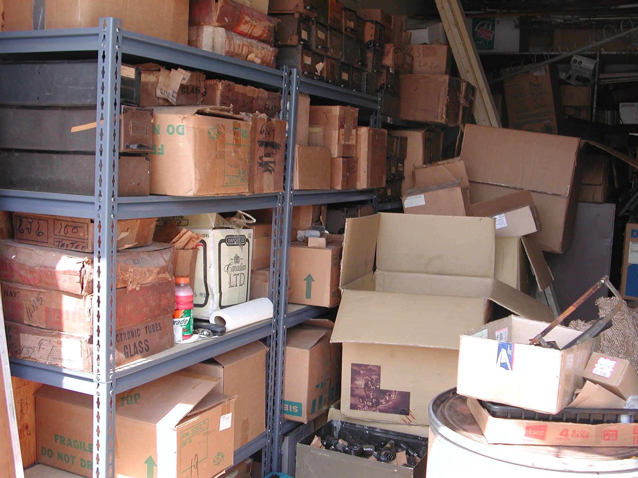

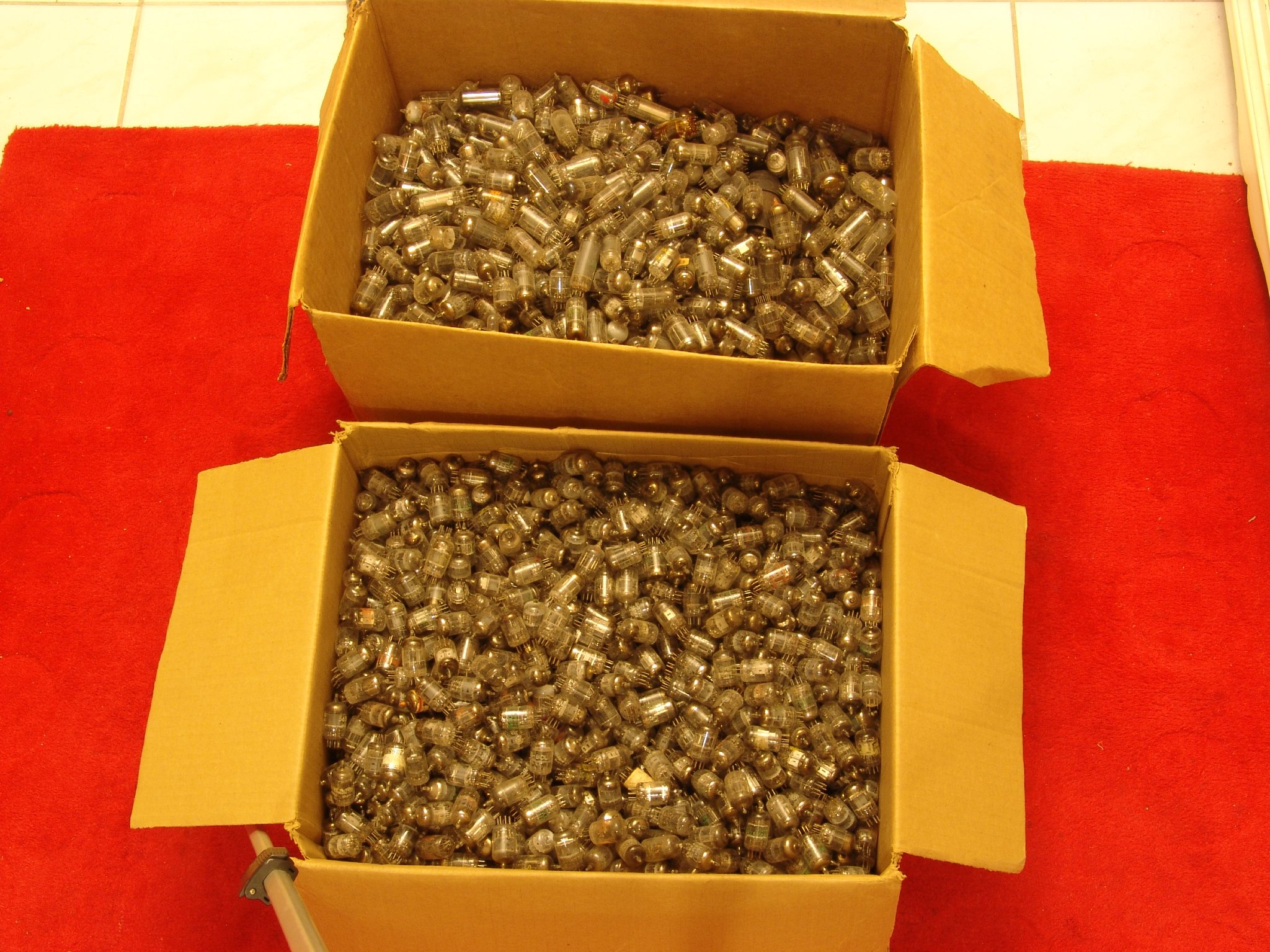

I once had 20+ boxes like these, but in much worse condition. The large round drum is full of tubes. All had been stored in an abandoned warehouse in Florida with all of the windows broken for at least 15 years. Vagrants, vandals, homeless and druggies had used the place for their misdeeds over the years as there were broken tubes and excrement (bird and otherwise) everywhere. I moved them all 200+ miles to my little warehouse and it took me about 5 years to clean and sort them all and then sell, trade, give away, or trash the stuff I would never use. There were quite a few useful tubes with nasty pins. Some could be saved, but some like the octal 7193 in the picture were beyond help as the pins had been crushed and broke off when straightened. In most cases the cleaning was accomplished with some WD-40 and a toothbrush after straightening the pins with needle nosed pliers and a plug in pin straightener. Some useful but nasty looking tubes had to be soaked in a solvent first, usually alcohol or mineral spirits.
There were some gems hidden amongst all of the dirty rocks, and a few oddities. Ever see a tube with a spare heater inside? What are the odds of finding TWO of them?
You found treasure alright, but not without a price. One thing though, after dealing with that many tubes and pins likely you found the best way for you to clean them. Usually it is a one by one sort of job. Trying not to take off the tube printing/label would be a concern of mine.

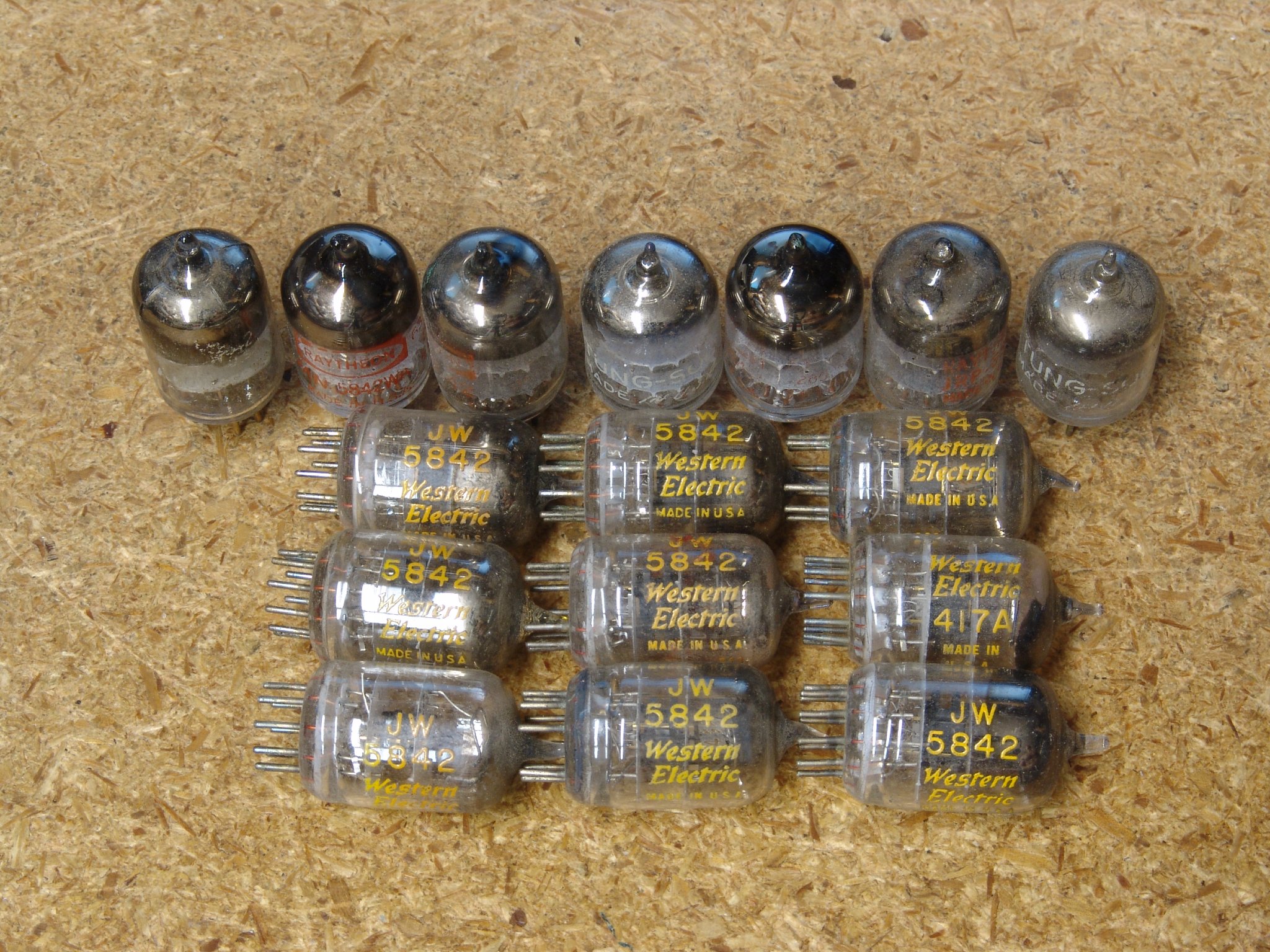

Fortunately, most of the tubes with some monetary value like the Western Electric tubes in the picture were relatively clean and good looking. The needed minimal cleaning and the logo printing survived. There were also about 20 Raytheon 5842's that were not so nice. Some of them are completely naked now due to the effort and solvents needed to remove some crusty brown coating that covered many of the tubes. They all work in a test amp though, and for me, that's all that counts.
The tubes that had remained in closed boxes for their time in that warehouse were mostly clean, but unsorted. Most of the boxes had damage from water, rats, mice and roaches, and humans. Some had completely disintegrated, spilling their contents on to rusty corroded shelving or the concrete floor. Many of these went directly into the trash dumpster outside. It seems that some of the human inhabitants in the building liked to smash most of the big tubes. There were dozens of broken 833A's 211's, 845's, and 813's along with a few biggies like 4-400's and a 4-1000 or two.
Someone in the team originally contracted to clean up the warehouse so that it could be demolished spotted "hazmat" and declined the job......after removing several truckloads of vintage aircraft parts. I got 4 consecutive weekends to take what I wanted before the "hazmat' team that could remove the mercury from all the smashed MV rectifier tubes showed up.
Looking back now, I probably spent more in warehouse rent to store all of those tubes than they are worth, not to mention all the time that went into sorting and cleaning. They were however the catalyst that kickstarted Tubelab, so maybe it was worth it.

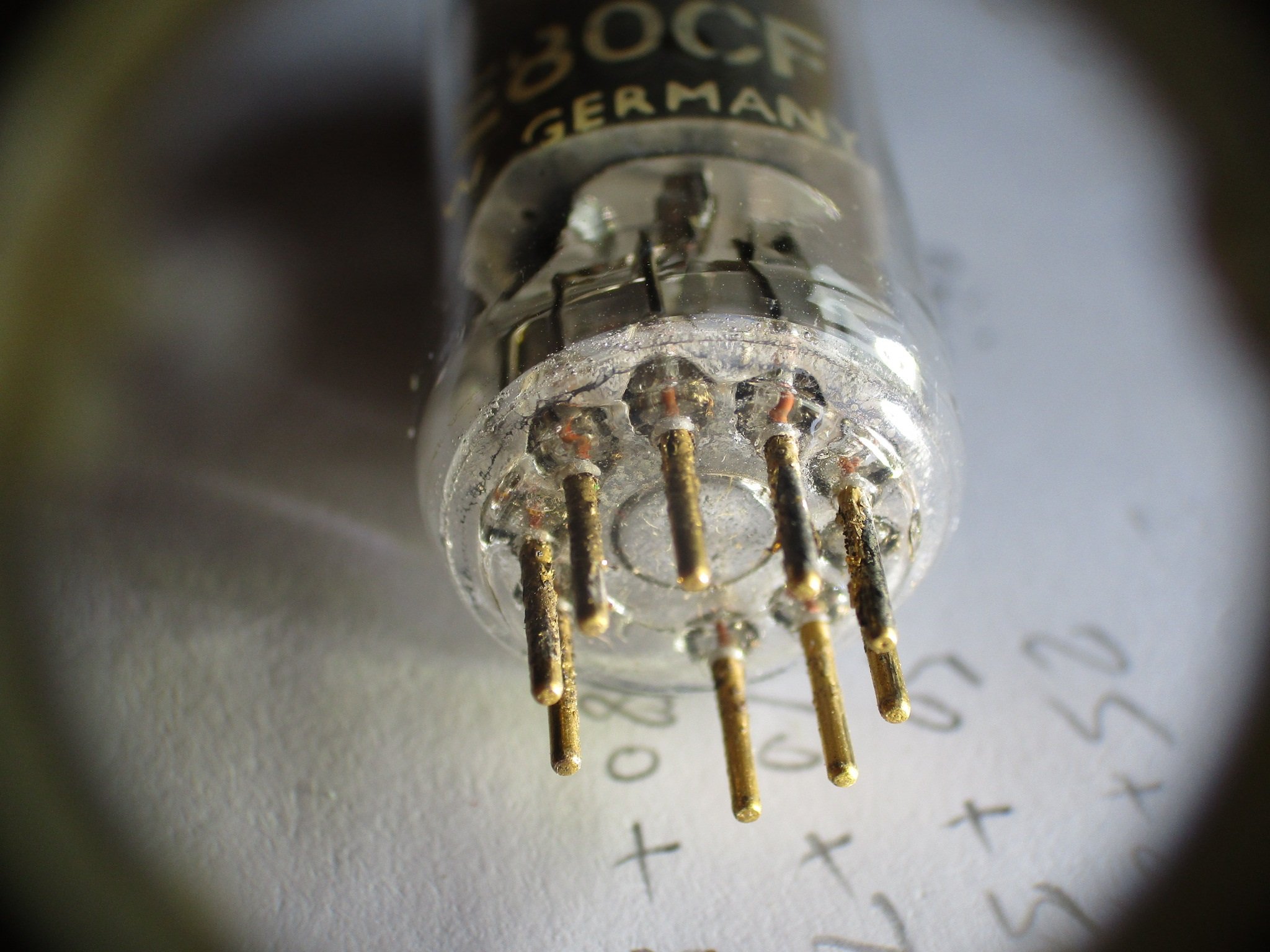

Had a phono repair come in the other month and quickly found the issue was corroded & pitted pins of an E80CF tube which is mean´t to have more value than it´s equivalents, now basically written off. I find this pitting odd as gold plating should be immune to all common solvents etc as Philips/Valvo did use gold plating, not any other metal.. However, the previous owner or someone in the past obviously overly hard brushed til much was plating was removed, so we get an intermittant heater and very noisy anode connection.
When this 1969 made tube finally made contact, the emission was as good as new. Sadly the only way to guarantee proper operation is to carefully solder the kovar pin ends with fresh; with the tube upside down held in a beaker of water just covering the pin/base to quench the solder heat ...not without difficulty.
