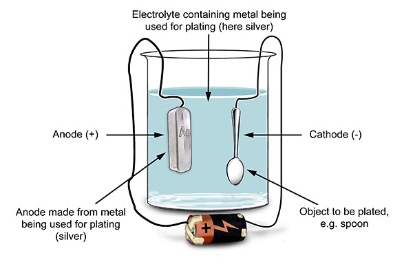

Gold pins wise, the possibility of dissimilar materials creating electrolysis in a moist environment is outside the scope of storage, which all recommend indoors and dry. More likely is traces of potassium cyanide or sim used part of the plating process, and not properly cleaned after.
