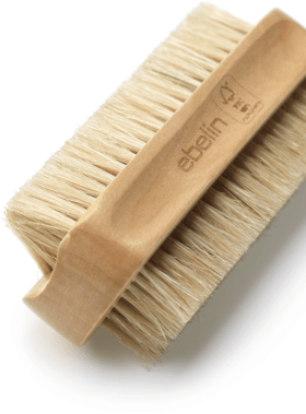

Tip: for very dirty PCB's a SOFT tooth brush (a new one) and the iso will work wonders. Even better are the brushes for cleaning finger nails especially the version with SOFT natural fibers like the ones as sold under the Ebelin brand name in Germany. Please see the picture. Take care to work as ESD safe as possible also with old analog stuff. The least one can do is to touch a PE connection and to not wear any fleece or static buildup clothing.

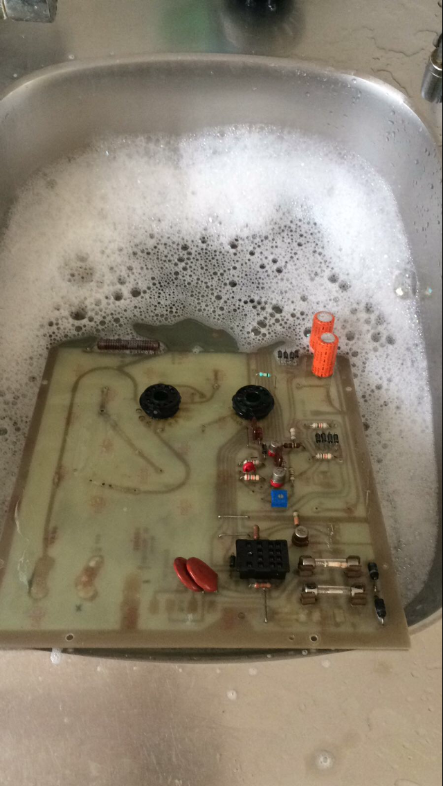

I used to repair VCRs with sandwich damage. I only used clean water and detergent. Just make sure the PCB is dry again before applying power.
