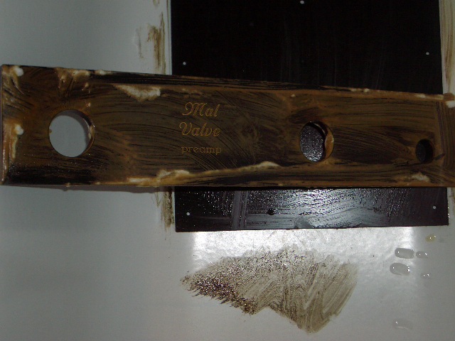

Yes, it can damage some paints, especially on old surfaces. This of course
depends on the time of exposure mainly - check it out on the bottom or
somewhere else appropriate. It will not destroy imprints, colour codes etc.
most of the time.

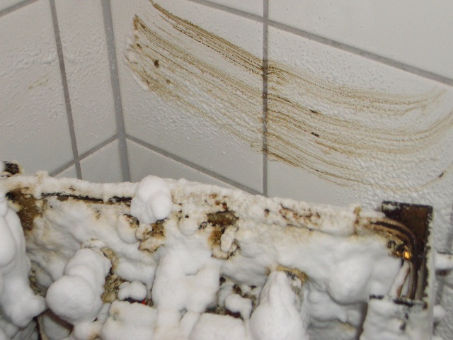

Outside surfaces can be cleaned in a nice way applying some of the substance
and using it with moist cloth.
Buy the cheapest no-name can of cleaner, the brand names contain nasty
perfumes. Take off cover and bottom plate for a good access to the innards.
Best place for application is in the bath tube.

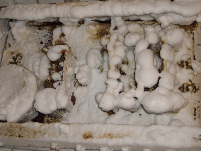

After spraying leave the cleaner do its work for about half an hour or more,
but not too long, foam must still be present. Clean with the shower head and
strong water beam, temperature set to maximum, then let dry in hot sun or
on the oven.
I tried this first with a cheap old stereo receiver just to be sure. It looked like
new inside after application.

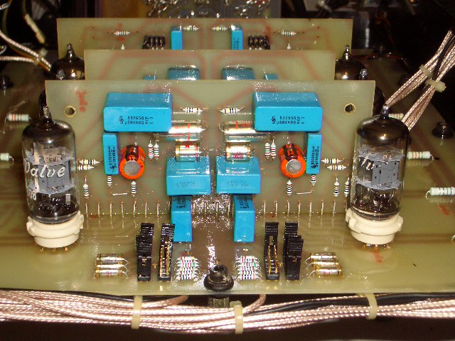

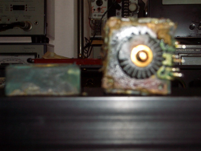

The sample pictures show a tube preamp which has no air vents at all.
Somehow smoke came in through minor tolerance slots and all the particles
remained inside the case. You see I applied it to the open ALPS pot even.
