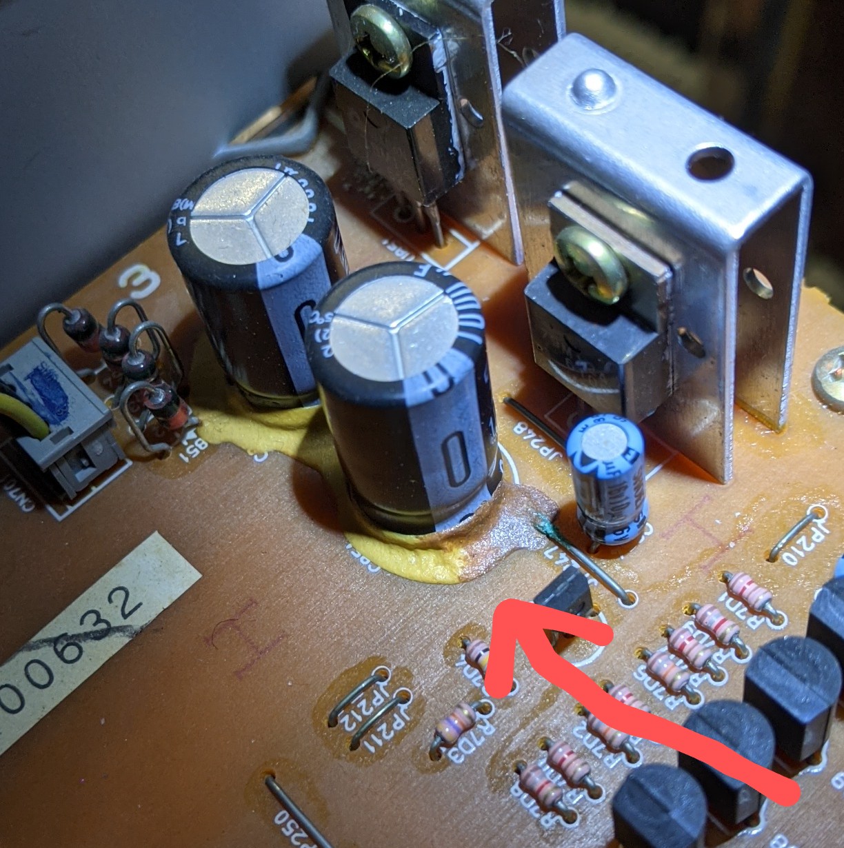

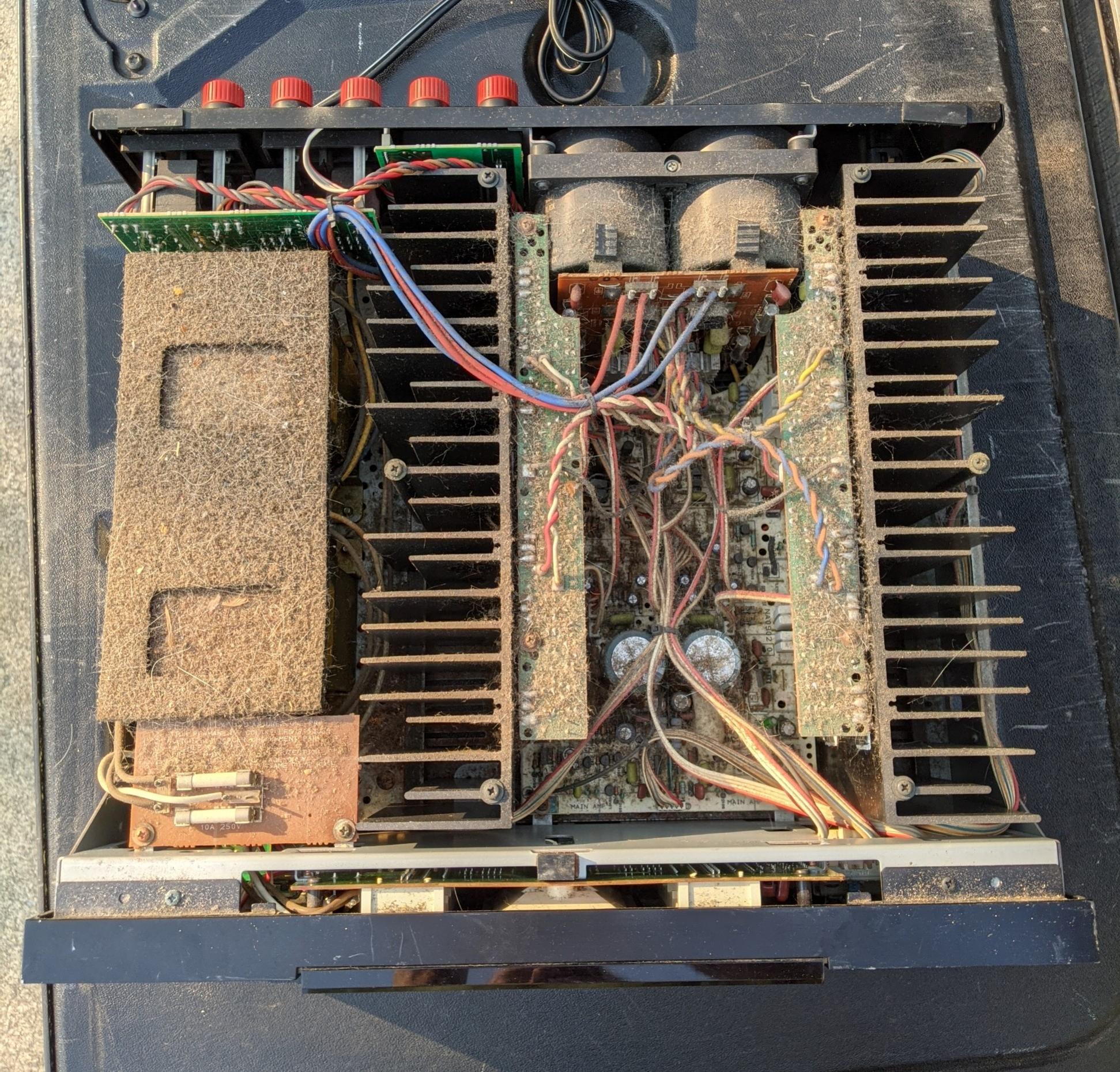

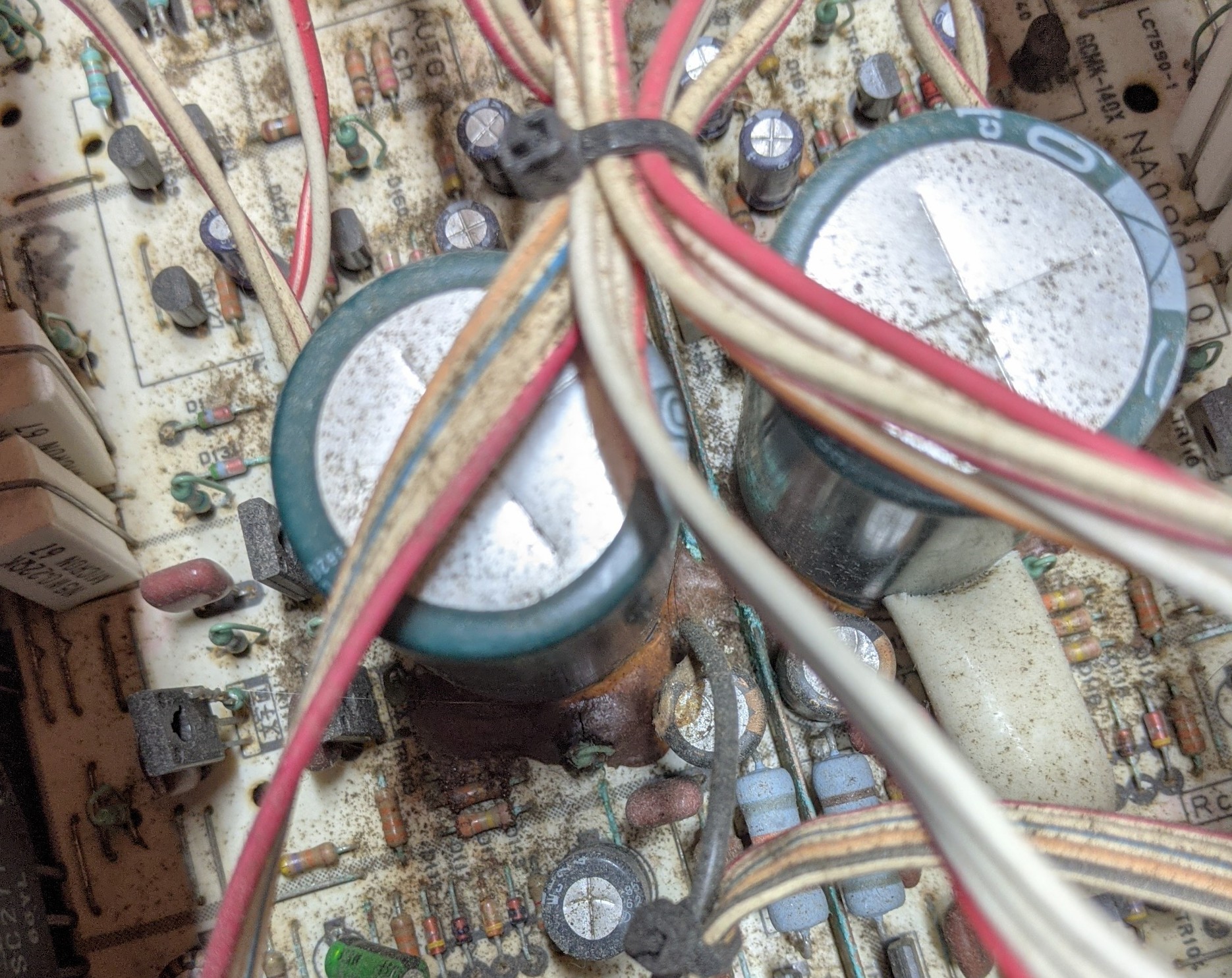

Hi all, I just picked up an abused Yamaha M-85. Here's a photo of the inside. I have since vacuumed and blow out the inside as best that I can but the main board, in particular, is still grungy.
My first thought is to spray it with isopropyl alcohol, maybe try to get a small brush in there for a light scrub, and then flush out as much of the filth as I can with more alcohol.
Is this the best way to go about it? I don't want to do any more damage than has already been done by the glue that was used to hold the larger caps down.
Thanks for your thoughts.

Whew! hose that baby off! I'm thinking a small brush, like an artist's paintbrush and a vacuum cleaner. Be sure brush has no metal parts that could short a still-charged cap to someplace sensitive to that.

I've used an alcohol dipped paper towel wrapped around a small flat screwdriver to scrape boards like that off. Very slow, but doesn't involve any ocean voyages in the supply chain. 70% isoprophyl alcohol worked fine.

I have cleaned last Year my vintage Pioneer amp and used IPA and a brush.
I've put the board vertically (pots and switches facing up) and let the fluid down while gently brushing the dirt down on a towel.
I've noticed that on some power resistors or "fusistors" the color bands were washed out. (Those usually marked with a triangle on the schematics).
They were fine but I've replaced them.
Pots and switches were lubricated again after re-assembling.
Be careful with sensitive things like analog VU's, Relays, tuning capacitors and the likes.

Remove that cracked brown glue under the main capacitors. Some folks say it becomes conductive.
"conductive" , no, but corrosive to copper, even painted traces, to wires and some components.
