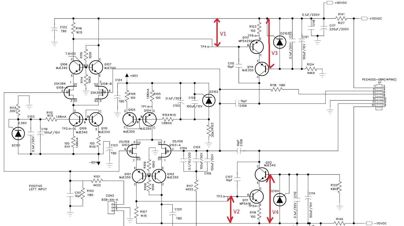

I would have a further question to the voltage levels you are mentioning.
As you say V3/V4 should be arround 2.5V , measured between + / -95V VDC and the base of the Q112 / Q114 transitors.
If i understand it right the voltages on the collectors of Transitor Q114 and Q112 are routed out via the connector pins 3/4 and 11/12 to the
VBE MPS2222 Transistor Collector / Emitter and also thrue the 210Ohms (CA301) resistors to the gates of both 10N20 and 10P20 Mosfets.
What voltage should i measured on the Collectors of T114/T112 and on the Emiter/Collector pins of Q1 MPS 2222 Transistor?

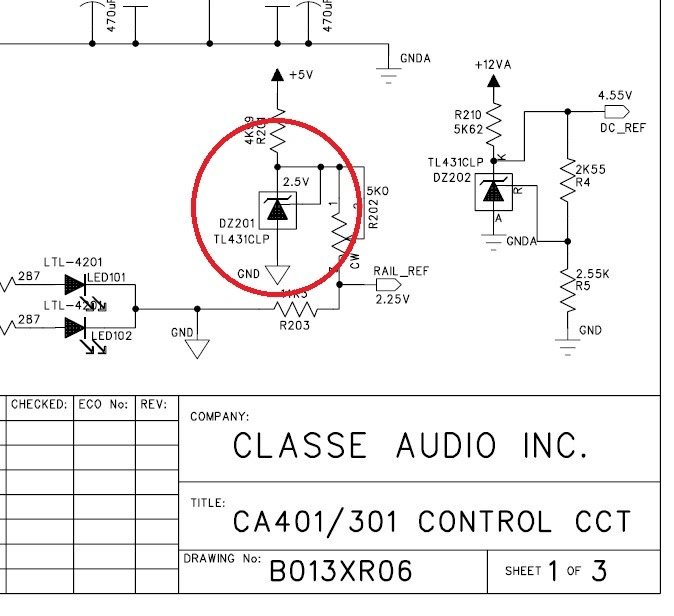

I have also a question on the TL431CLP component.
Can i use this Programable Reference component 1:1 at the place of DZ103/104 without any change on the other circuit elements ?

1. The purpose of testing V1 and V2 voltages is to confirm the first input and driving transistors are ok or not. Reading V3,V4 voltages is to confirm the parts DZ103/DZ104 ok or not, if all voltages ok then these parts are ok.
2. You should check what exactly the parts on your PCB for these DZ103/104, are there any part number on them, are they three pins same as TL431CLP, or they are just TL431CLP, you need to find out.
3. The voltage measured on the Collectors of T114/T112 is just the MPS 2222 VBe circuit voltage +Dr -Dr, you can get the voltage range simple by VBe circuit calculation with the resistor R2 (383 Ohm) and R3 VR( take half resistance value of R3 to calculate). Or you can just carefully to check it from the other good channel.
Hallo Patrick
thank you very much for the further help and clarifications.
I have dismantled the complete left channel of the CA301 amp again and will now setup the channel outside of the amp chassis
on my workbench, so i can do the measurements on the GainsStage PCB.
The components DZ103 / DZ104 are marked as AS431 Precision Shunt Regulators.
From a short comparision of the datasheet paramenters the AS431 seams to be compatible with the TL 431.
I am anxiously looking forward to what failure i will find and whether i am able to fix the issue.
With best regards Ernst

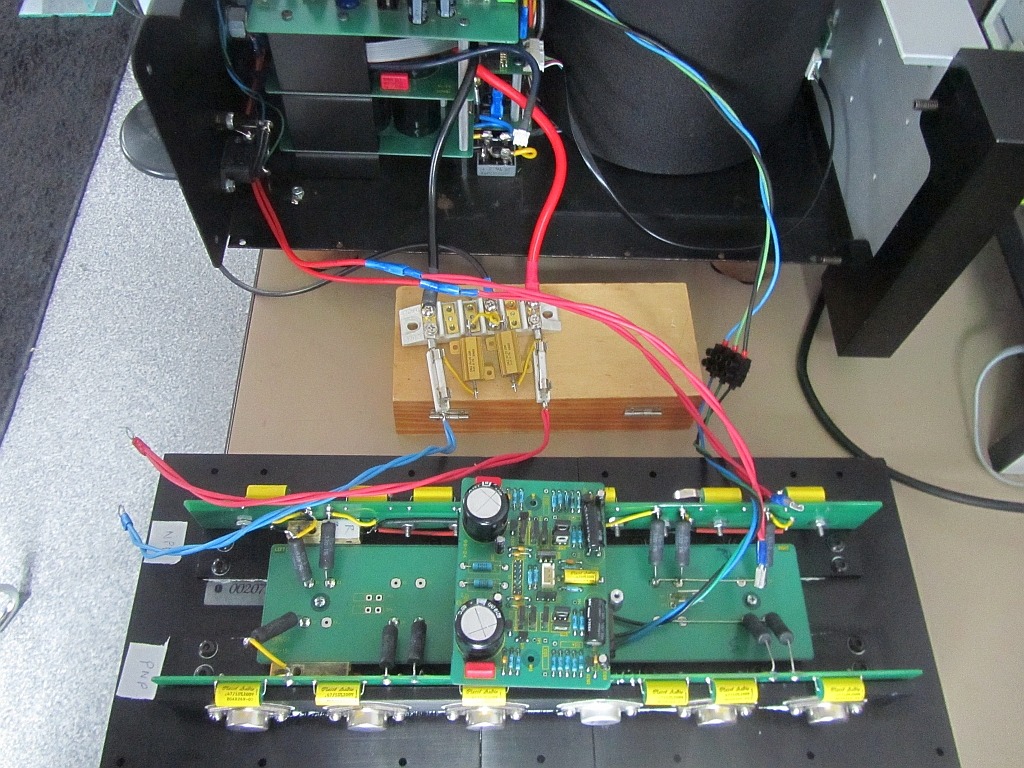

Hello Patrick
i have in the meantime made-up a better test cableing so i can measure the defect channel on my workbench.
Picture attached.
I also added 2.2Kohm resistors from the +/-power rails to ground for a faster discharge of the powersupply.
Courious to see how far i will come in find and fix the problem.
Best regards
Picture attached.
Best regards

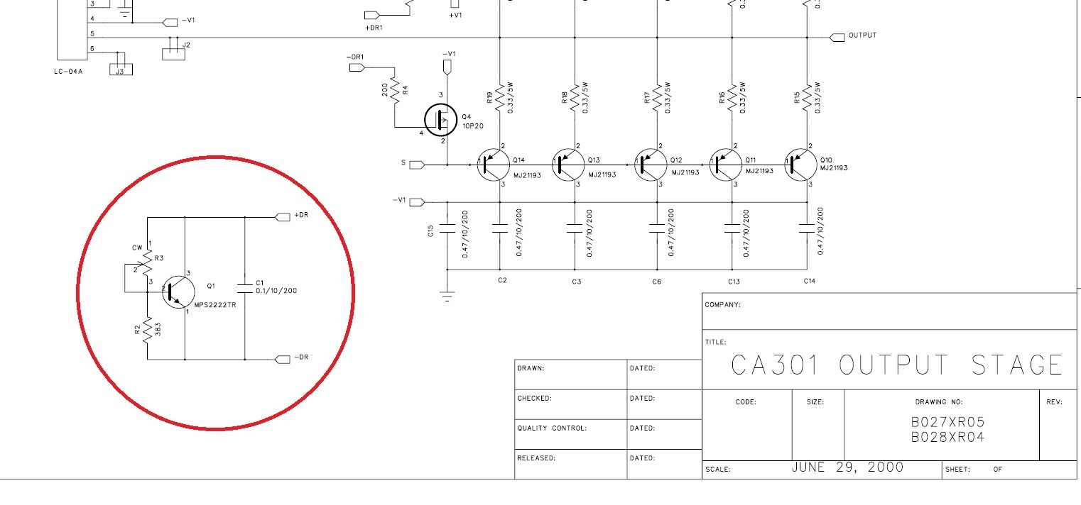

Careful to check again the connections between the different sides after we replacing a part in a double sided PCB
Hallo Patrick
i have ordered and received the transistors MJE340/350/MPSA18 and the AS431.
Was not able to find the MPS4250 so i strived for a equivalent and found the 2N5087 ? which i used.
I carefully replaced all the old components on the PCB.
I switched on the amp and measured as you recommend the Test Point voltage situation aginst +VDC / -VDC.
Here is what i found.
TP6 3.57V
TP4 2.91V
Base of Transistor Q114 was 1.37V may be bit low ?
TP5 3.81V
TP3 3.08V
The Voltage across (+DR -DR C/E) on the VBE Multiplier MPS 2222 Transistor was now adjustable and
i adjusted it similar to the working right cannel value at 2.2V.
So i thought i am a happy camper, but nothing at all happed to the Bias current, still 0.00Amps
Hmm i am puzzled.
Via the 14Pin connector both voltages +DR1 (pin 3/4) and -DR1 (pin11/12) are
routed to the Diode/Zener/ 3 Resistor circuit to become
SS1 connected to the Base of the NPN transistors (i measured 0.05V to ground) and
S1 connected to the Base of the PNP transistors ( i meassred -0,45V to ground)
Could it be that either the Diode D1 or the D4 3.3V Zener going to SS1 are defektive ?
Looks like that i have to find the problem with the missing voltage on the Base of the NPN transistors.
Any hints where to look ?
Thank you very much again for reeding above description and you help and effort to finally
find the issue.
Best regards Ernst

Dear Ernst,
1. Your Test Point voltage reading seems not correct, according to service manual, TP4 should higher than TP6 by 0.6V ( Q113 VBE voltage), so as TP3 > TP5 0.6V. If the Test Point reading exchanged, it seems the voltages reading are ok for the input circuit.
2. The cascade transistors Q114 and Q112 base pin should be around 5V reading which provided by the AS431, if the reading is no correct, pls. check each AS431 and the resistors connected to them R124 & R120 ok or not.
3. Pls. check each power output transistor's emitter resistor is ok or not, otherwise you can't measure Bias voltage on a opened emitter resistor.
4. When we are checking the Bias voltage, we should measure voltage between +DR1 & -DR1, SS1 & S1, not to the ground. * In normal condition, SS1 & S1 voltage should be around 1.2V for the power output transistors to Bias correctly ( when NPN & PNP turns on, each VBE is around 0.6V)
5. Diode D1 and Zener Diode D4 form a clamp voltage protection for the driver MOSFET in +DR1, so as D2 & D3 do the same in -DR2 , you can simple test them ok or not by a multimeter.
Please study and test you amp circuit again
