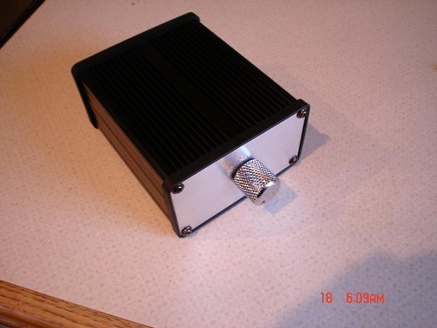

This time I'm stugling with myself, doing the same kind of DIY chassis or buying a nice chassis.
Hi Daniel, you may find something here to help make up your mind! 😉
Take it from me, the pods are ideal for the class-T amps!

thanks for showing me your chassis. They look great. I like woodworking and the pod would be fun to build, but I want a chassis that will contain both the amp and the PSU. So, I'll buy the $10 case I saw last Friday and make a nice front plate with wood or maybe with some black Plexiglas. I should be able to make it detachable. This will allow me to make a few front (Plexiglas) of different colour & change it from time to time.

I could try the Pod for the next project. I'll post some pictures and comments about the autocostruire kit in a few weeks. Here is a picture of my last project :
I like the wood front, gives an organic feel to any project.
Can we see pic of the internals?

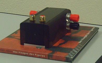

See my attempt at making the smallest case for amp3, and having shortest length of cable to sockets. Top is acrylic, side wood and bottom aluminium, which also serve as heatsink. Sorry, pic is not very good. My inablilty to take a good pic, not the camera's fault.
Thierry.
Acrylic and wood looks nice, particularly dark wood.
