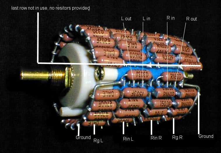

It seems to be stereo because on the second page of the assembly instructions it shows two in and two out pins, but there is only one ground... is this OK?

This is stereo attenuator

First step doesn't have series resistor, just 1 paralell to GND, thus 22*4+2=90

The attenuator is aprox. 40-45mm in diameter. There are two ways of assembling.
1. as shown on DIYFidelity site http://www.diyfidelity.com.au/product_info_more.php?assembly=attenuator_assembly2.php&products_id=32
2. as per picture below. This way you save few MM in diameter.

There was a very thorough discussion about these Dale-based attenuators a while back when everyone was making Gainclones.
A lot of folks got really excited about them because the offered very good performance for the price. As people started buying and using them, though, many discovered that the switch would often produce loud popping/ electrical switching noises when switched (and not necessarily at all rotational positions) that, when amplified, was sufficiently annoying that they eventually switched to something else. It was even determined that the switches were make-before-break types, so the culprit was thought to have been contact damage from excessive heat when the technician assembled them.

Popping noises
The noise is generated from a voltage transient being generated and fed to the input. This can be caused by 2 things;
1) There is DC present on the volume controls input,
2) The switch opens up while switching between steps.
1 can be fixed by tracking it down and eliminating the source. A quick and dirty solution would be to add film caps into the path before the control.
2 can be fixed with a good replacement that doesn’t open up or a 27k res. can be added from the output to ground thus preventing it from ever opening all the way.
Roger
