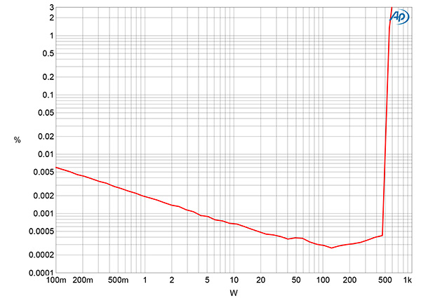

Here is measurement of Lyngdorf MXA-8400 class D amplifier on 2-ohm load:
https://www.stereophile.com/content/lyngdorf-audio-mxa-8400-8-channel-power-amplifier-measurements
Over 500 W continuous on 2 ohms! From class D amplifier!

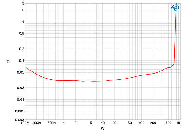

Another example: JMF HQS 7001 class D amplifier (from https://www.stereophile.com/content/jmf-hqs-7001-monoblock-power-amplifier-measurements):
Over 750 W continuous on 2 ohms! From class D amplifier!

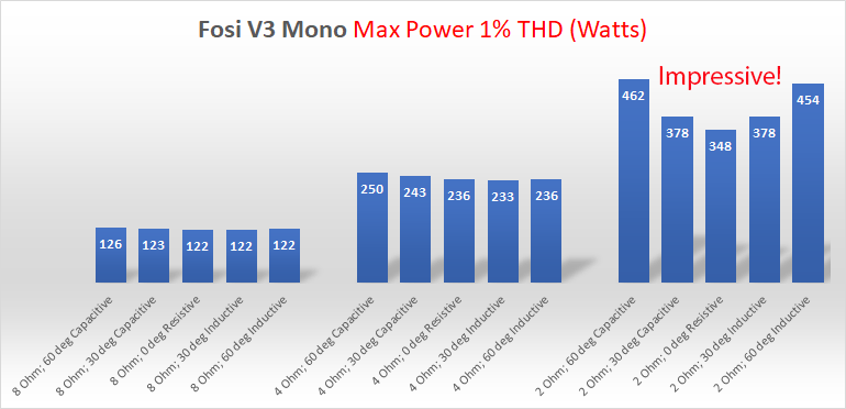

$3350 is too expensive for you? How about $140 Fosi Audio V3 class D amplifier:
https://www.audiosciencereview.com/...ds/fosi-audio-v3-mono-amplifier-review.53474/
348 W on 2 ohm load (236 W on 4 ohm and 122 W on 8 ohm)! For just $140 on Aliexpress or directly from Fosi Audio.
So, which class of operation has problems with 2 ohm load?
