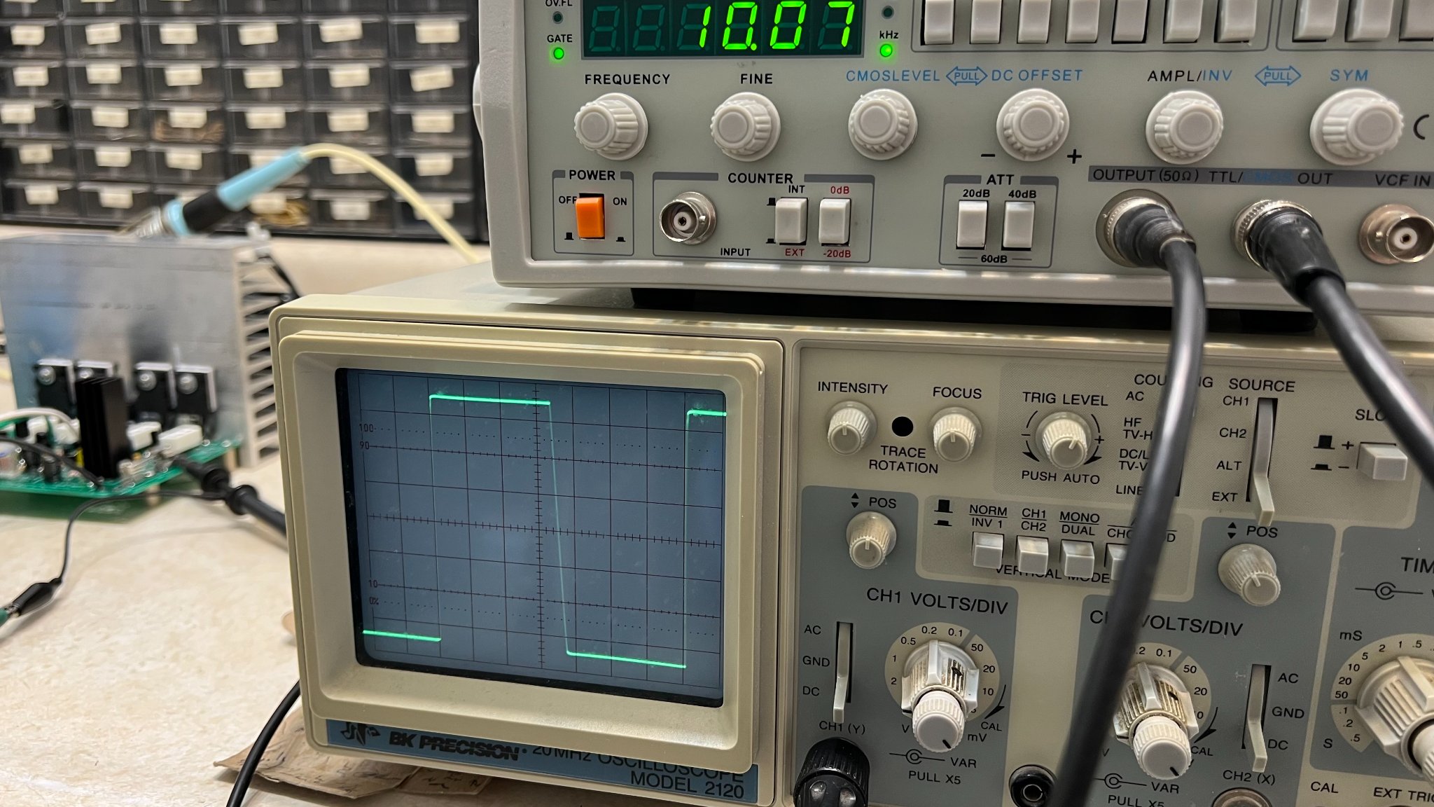

When you put a 10 khz square wave into a class D amp , garbage comes out. Square wave tests have been the benchmark of good audio performance. That explains why many concerts bring on listening fatigue. That effect where the sound seems really good at first, but then you want leave after half an hour. Class D is cheap and light weight , that is the entire point of it. I have tested some good class AB designs to full power with 10 khz square wave with clean output. Of course, zobel networks must be disconnected for such testing. The double die lateral mosfet amp in this example is on 10 khz , scope at 20v/div. note the rise time. This could not be done with class D even a fever dream.

What has a square wave to do with audio??
If you do what every amp tester does, low pass input filtering at say 30kHz when testing with square waves, class D is just as fine as class A or AB.
BTW on your scope pic, your amp is slew rate limiting on the fallng edge. It doesn't do this well, but it is unreasonable to require it anyway so no harm done.

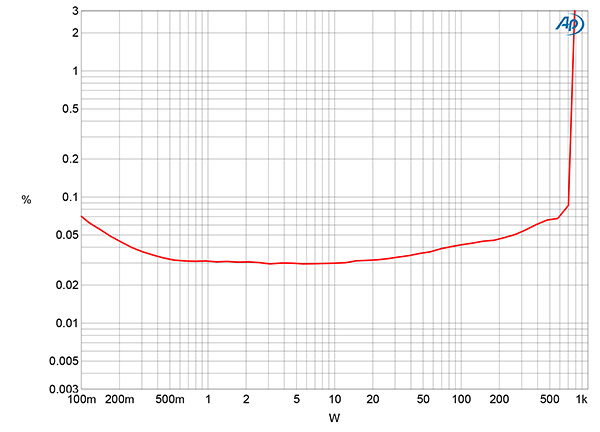

Here is measurement of Lyngdorf MXA-8400 class D amplifier on 2-ohm load:
https://www.stereophile.com/content/lyngdorf-audio-mxa-8400-8-channel-power-amplifier-measurements
Over 500 W continuous on 2 ohms! From class D amplifier!

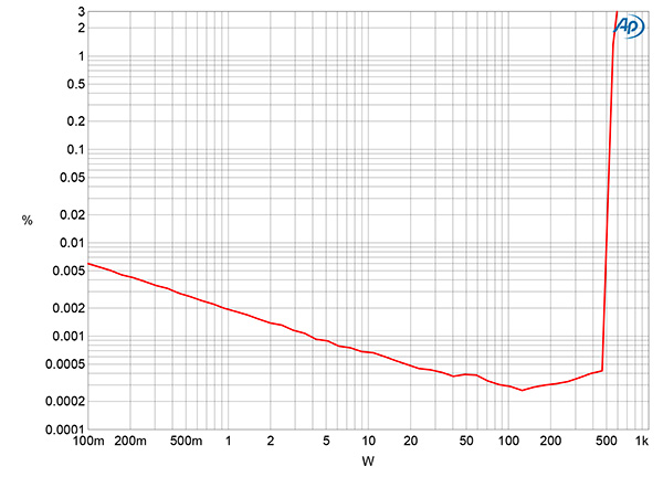

Another example: JMF HQS 7001 class D amplifier (from https://www.stereophile.com/content/jmf-hqs-7001-monoblock-power-amplifier-measurements):
Over 750 W continuous on 2 ohms! From class D amplifier!

That’s just not that big an amplifier. The 200 watt per channel class is where class D is in a sweet spot. The voltages can be supported by 200V silicon, and you can force the required currents through a low inductance transistor package. When neither of those is true anymore you start having to make compromises.
