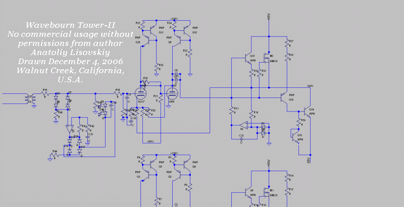

Wavebourn said:I am going to try my Wavebourn's version of a Smocking Amp.![]()
C1 and R1 needed for stability (to prevent oscillations)
Output power from a SE amp that equals to max plate dissipation is an interesting idea.
Oh, I get it now.
The SS amp does low frequencies primarily, and the SE tube amp does high frequency corrections thru a tiny xfmr.
Should work. But don't expect to get SE sound out of it because the low frequency second harmonics won't get generated in the SS amp unless it's design badly.

It's because of "tiny transformer". Why it needs to be tiny if we speak of less distortions? Let it compensate on the whole range of frequencies! Anyway the compensation in your approach (output in series) will never be ideal because of complex impedance of a real speaker that depends on frequency.
Here is one more version, more "tubey":
"It's because of "tiny transformer". Why it needs to be tiny... "
Well, I thought you had mentioned something about getting rid of the xfmr or using a tiny HF one. But sure, a large one will work for the full frequency range. But it is an air-gapped one for SE.
"Here is one more version, more "tubey":"
Hmmm, but then the output xfmr has to handle the full power, not just error corrections. And it will have to be air-gapped still.
The idea of putting constant voltage across the triode is useful for enhancing PSRR as in George's design, but it causes the triode to operate just like a pentode in common cathode configuration. This means 3/2 power operation with lots of distortion unless it's used in cathode follower mode (as George does use).
So I don't think this is so important as a primary goal. A better goal would be to get the triode to operate at constant current at all times, but variable voltage. This would give lowest distortion in common cathode configuration (MU), and is the more usual configuration for SE amplifiers (well P-P ones too).
So a load compensating modulated current source plate load for the triode would seem more useful. Probably won't save any power though, which was the original design goal for class G or H.
This could either be in a P-P totem pole configuration with a Mosfet on top and tube on the bottom, or a center tapped xfmr with tube on one side and modulated Mosfet current source on the other. Or it could be done in SE mode with a modulated Mosfet current source in parallel with the tube. The last approach however facing the penulty of needing a choke or air-gapped xfmr.
This "solution" was Yundt's solution for the parallel amplifiers case by the way. You can parallel a current output amplifier and voltage output amplifier without them fighting each other. The current amplifier then gets programmed by feedback or design so as to either minimize current variation or zero out current altogether in the voltage amplifier. You do still want to use a clean amplifier for this though.
The usual class D attempts at this suffer from the noise filter on their output reducing their output Z badly. Then the voltage amp has to fight the filter cap., requiring high speed and ultra low Zout again.
We could try putting a class AB (to save power again) SS current output amplifier (Hi Z output) across the tube amp secondary and monitor the return current from the tube amp so as to try and zero it with the SS ampl. Then the tube amp could operate at zero current variation in the tubes for best accuracy. Triodes would be fine in this case, the lower the tube out Z the better.
Anyway it has to handle the whole output power if we speak of constant anode voltage. Actually due to high output impedance your tube amp don't correct tiny errors; SS amp supplies a voltage to the tube output stage that delivers the whole output power.
By the way, I am going to try an asymmetrical output stage. i.e. triode and pentode in P-P configuration, but it is the different story...
"Anyway it has to handle the whole output power if we speak of constant anode voltage. Actually due to high output impedance your tube amp don't correct tiny errors; SS amp supplies a voltage to the tube output stage that delivers the whole output power."
Well the SS amp is supplying power, since they are in series. The SS errors just get "ignored" by the tube amp, showing up as tiny variations in the plate to cathode voltages on the pentodes (so no effect).
"By the way, I am going to try an asymmetrical output stage. i.e. triode and pentode in P-P configuration, but it is the different story..."
I suspect this will give you something close to SE sound. Are you going to supply complementary drive to the pentode or just use it as a CCS?

I'm seriously thinking of such triode-pentode design after a tremendous success with transistor voltage follower loaded on a voltage to current converter (you call it modulated CCS, right?)
But in this case it will be a triode loaded on a pentode. Except such an advantage like SE triode character it will use smaller and faster PP transformer than needed for a SE amp of such quality, plus some extra power from a pentode side...
Imagine a Concertina splitter with cathode directly coupled with triode's grid; a trimpot in anode and a capacitor from anode to pentode's grid.
I particularly hate to calculate things out accurately, preferring to just adjust parts after a few SWAGs in the dark. This often results in burned resistors or worse. This of course gets impractical with complex circuits. Also explains why I use $0.50 TV tubes for prototyping.
These have been my design methods for years. I have recently adopted the "model it in LTspice" method to weed out the stupid ideas and get first pass SWAGs at the component values before graduating to the toasted parts stage of development.
See this thread for a picture of an all tube version of a modulated B+ amp that passed the simulation stage, but vented the magic smoke when tested in the real world.
http://www.diyaudio.com/forums/showthread.php?s=&threadid=114021
