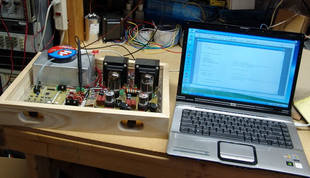

I experimented with this scheme back when Broskie wrote it up. I found that the output impedance of a tube amplifier changes with the bias current leading to distortion if the bias is varied dynamically. Of course this can be cured by adding negative feedback. There are also some time constant issues. I lost interest in the scheme as he presented it shortly after these initial experiments. The hardware I developed during the past year is certainly capable of many dynamic biasing schemes, and I will no doubt be experimenting along these lines in the future.
The autobiasing scheme presented in the original Broskie article is "backwards" from what I believe is needed. A class A amplifier dissipates the most power when it is sitting idle. The peak to average ratio in most music is 10 to 20db. This means that most of the time an audio amplifier is operating between 1% and 10% of its rated power, and that is assuming that the volume control is up all the way. The scheme that Broskie presented would see little use in normal listening situations. What we need is a way to reduce the power dissipated at idle, but be able to crank it up as needed to produce the high power transients. The easiest solution is of course class AB, and even class B operation. It is well known that these methods extract a sonic penalty and are not useful for SE. I have built a nice sounding class B screen driven P-P amp that was about 75% efficient at full power (80 watts). No unusual tricks were employed. Each output tube dissipated about 4 watts at idle.
I am exploring the classic "class H" method of varrying the voltage applied to a cathode follower in step with the audio signal currently. It should be possible to vary the current through a common cathode stage in a similar manner, but I havent gone there yet.
