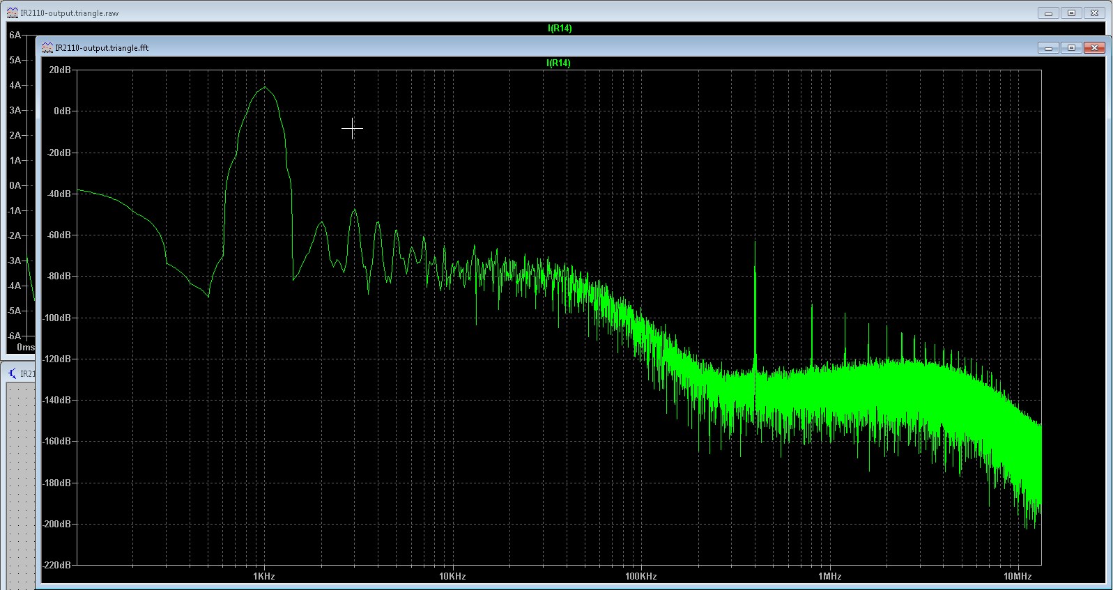

The chip I did use is lowest 15nS.
I have downloaded a .lib for ltspice but have no part .cpy I need to now how to make, I think just a square with the pin names from the .lib will do.
Then I can spice more precisely.
I did see the Gan mosfets are also in to220? but the induction of pins and pcb traces does get nasty very quick.
What Gan did you use>? the abcense of the body diode is a really gainer, these is even more important then the speed.

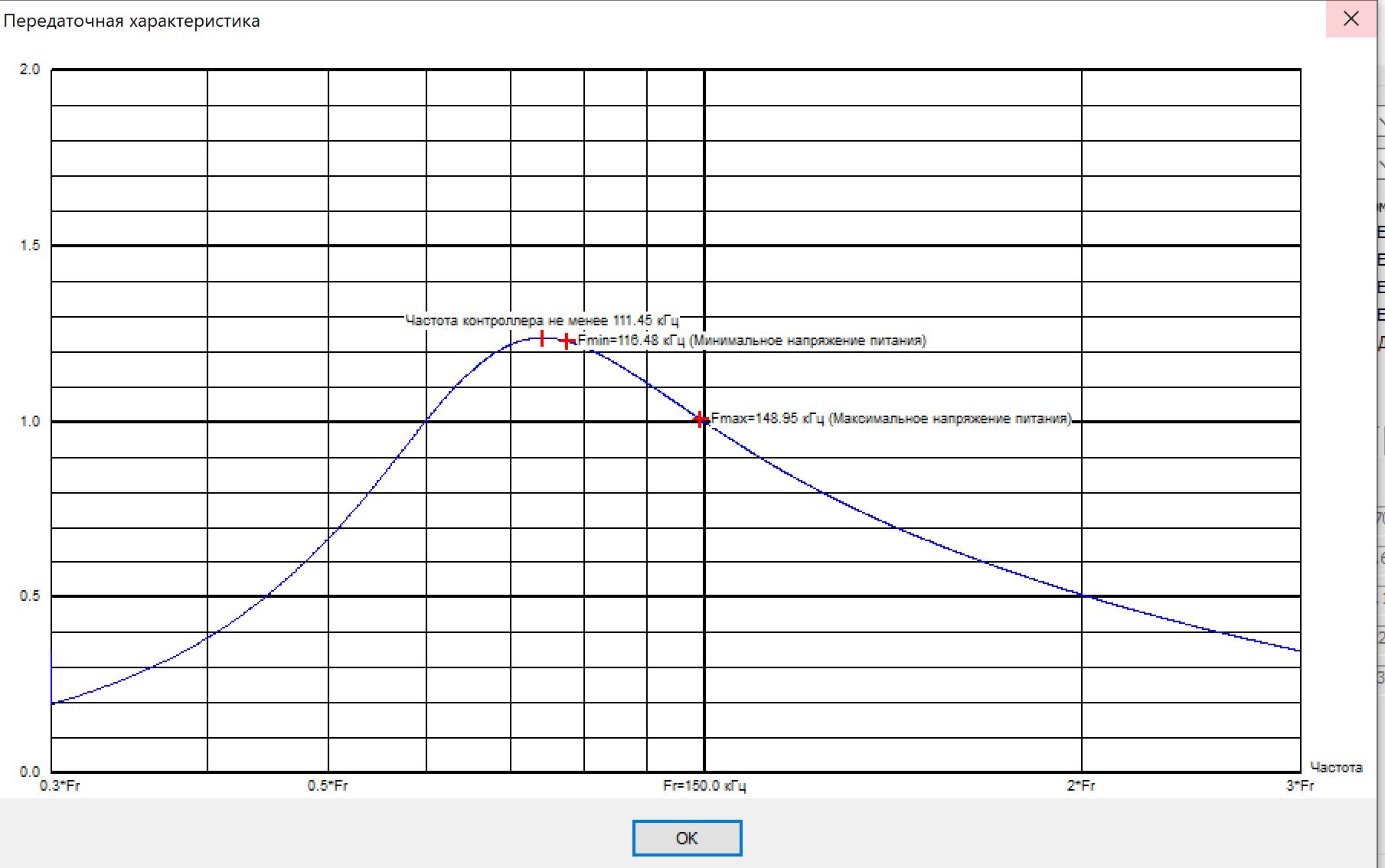

I have now work on a circlotron autobias system and a hybrid, for that hybrid I have need that LLC smps, butbecause I need multiply voltages calculation of transformer is difficult without a program.
An russian guy did excellentIT 7300 but have also from him a version for resonant who is not whole english.

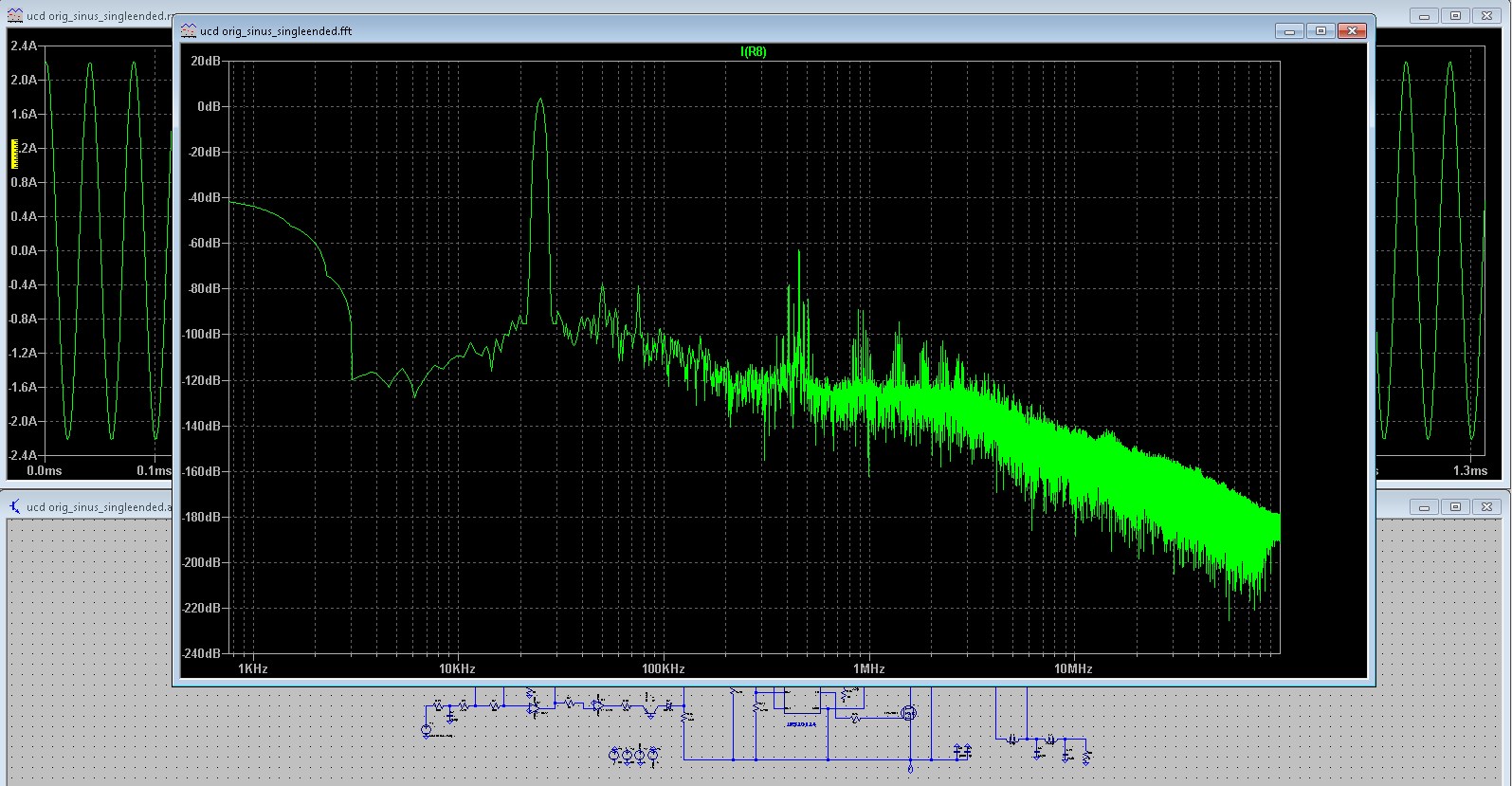

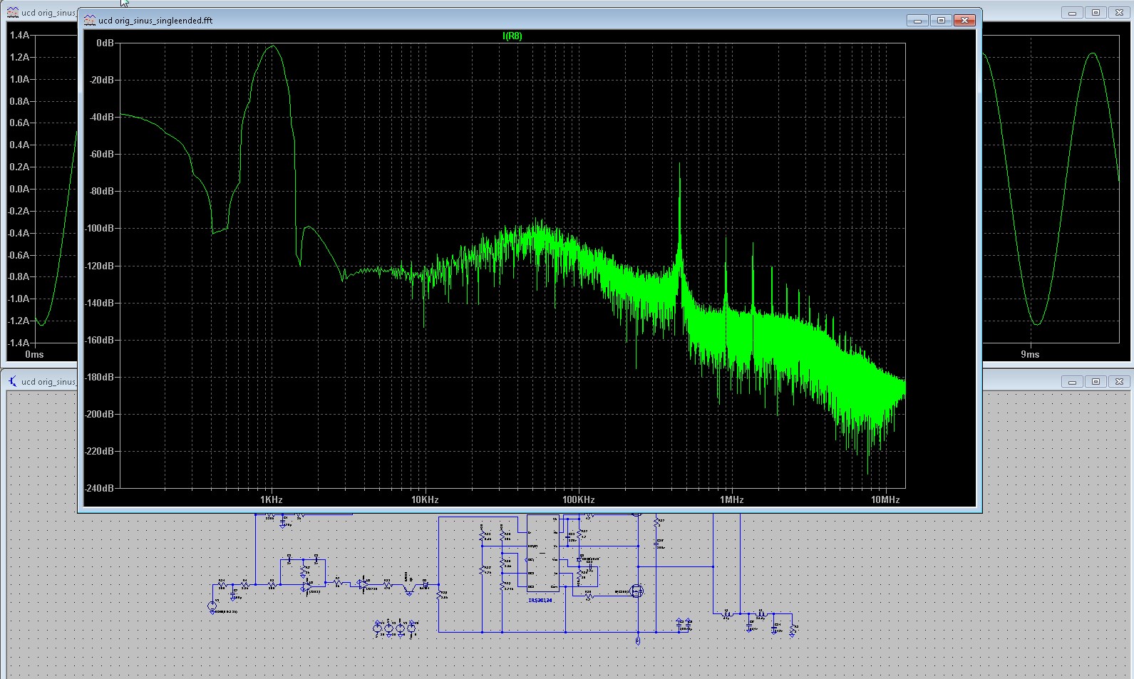

For the comparator I do use a version who has 3 nS speed.
open loop with Gan did on sim twice as good distortions in compare with normal mosfets.
With a three level 1Mhz (mosfets do 500 Khz three level does double that) switching amp I get -120dB on 1 khz anbd -80dB on 25 Khz.
in real live ? I do not now but will set inductions in series with mosfet pins to simulate pcb traces and watch them.
