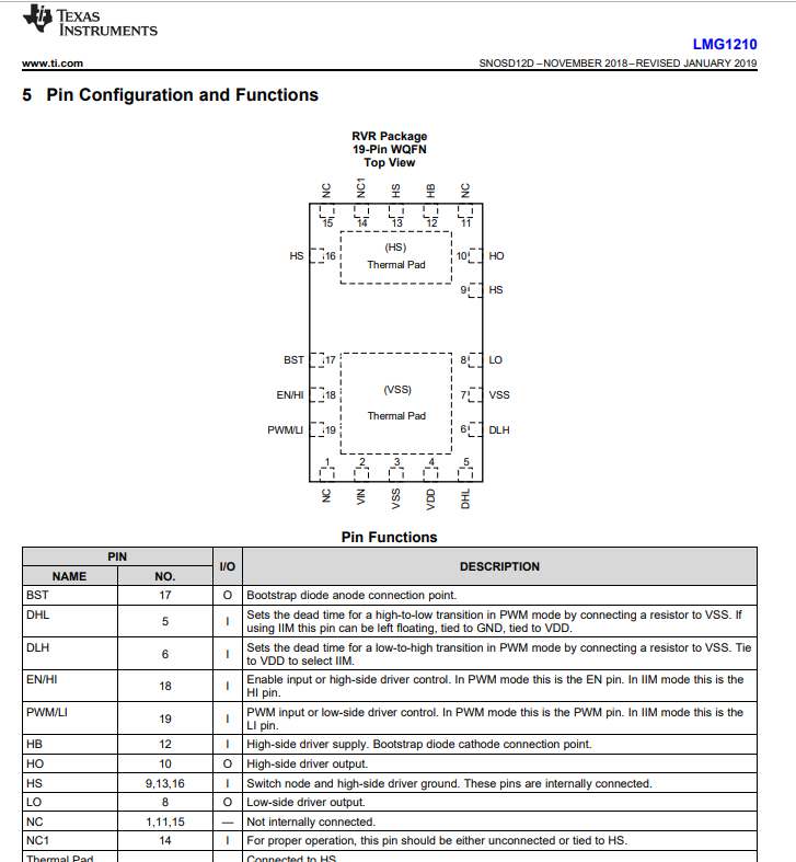

Look at LMG1210 from Texas Instruments. This is a new GaN half bridge driver with 200V rating. I am considering it for my own project.

but LMG1210 chip accept only PWM Input.

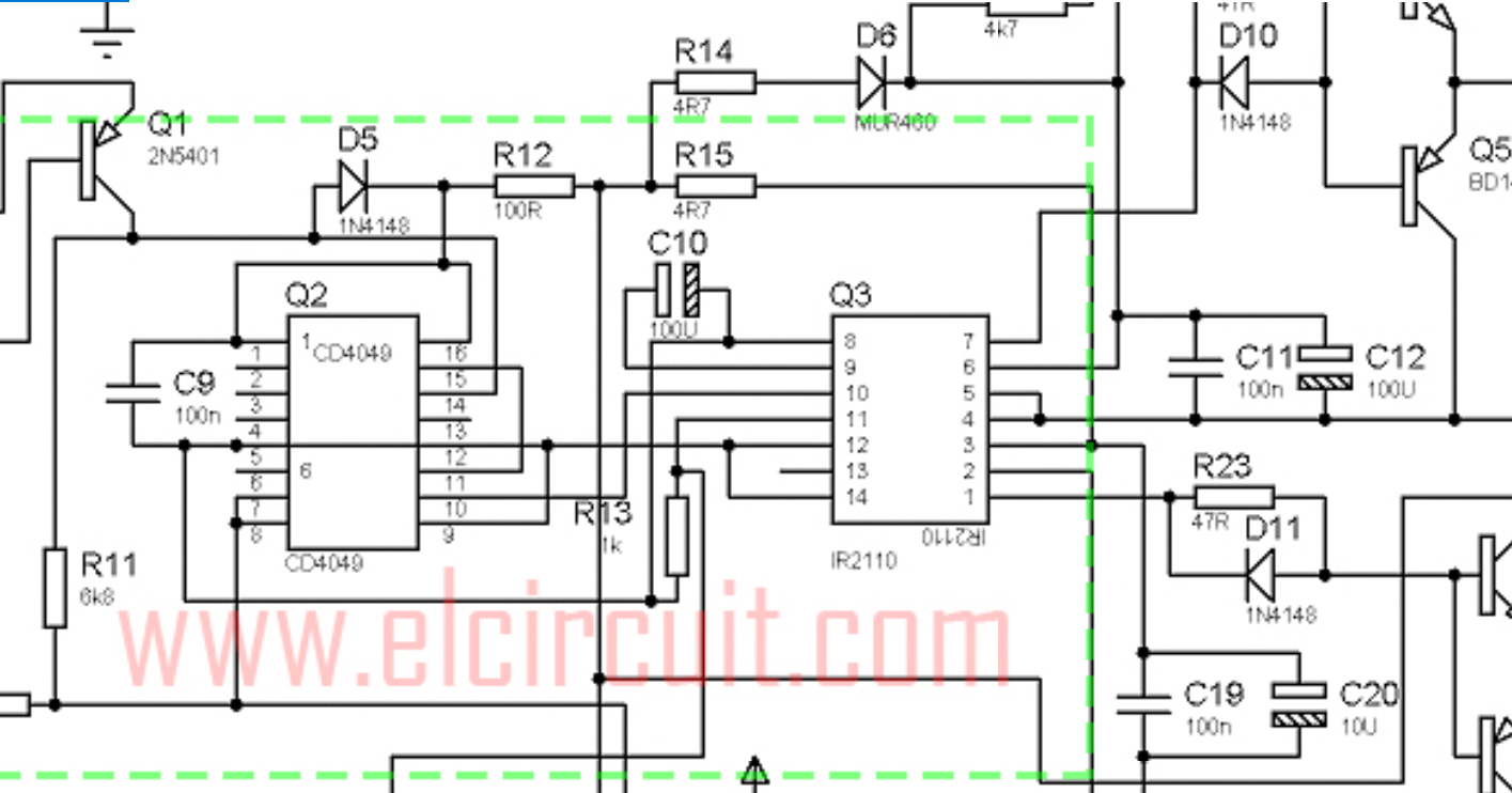

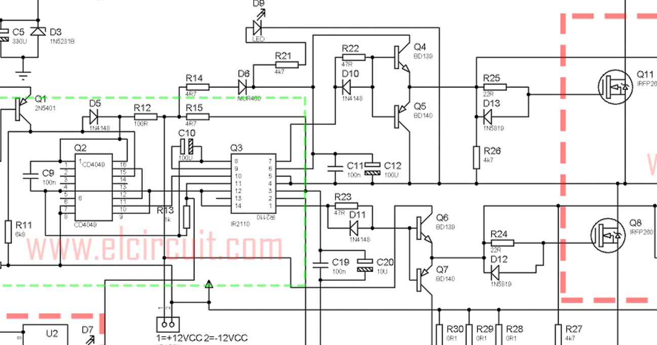

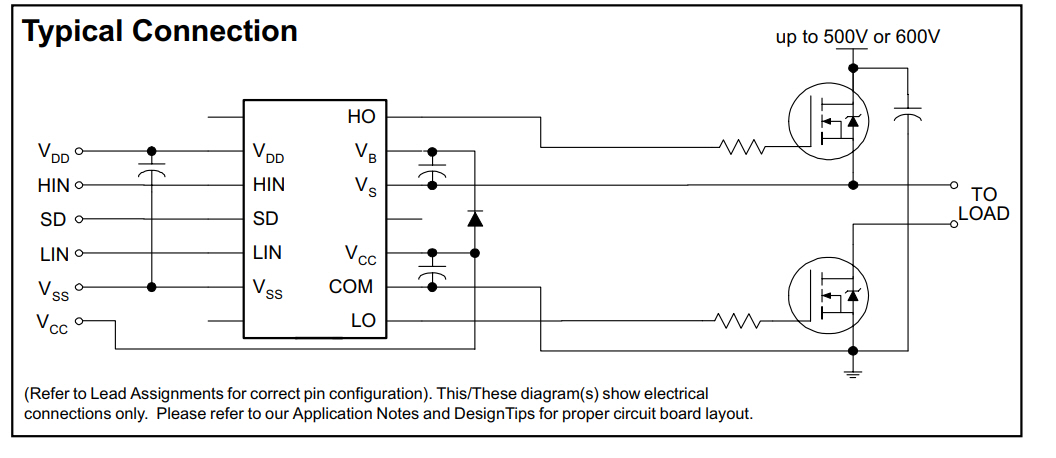

I need direct replacement GaN driver for IR2110
Im usine CD4049 / CD4070 logic - IR2110 have HIN and LIN Inputs
LMG1210 only PWM
look pic schematic

Is that so? Then why, in the feature list on the first page, does it say:
"Two control input options
– Single PWM input with adjustable deadtime
Independent input mode"
And pins 18 and 19 have two functions (EN/HI and PWM/LI) 🙄
Hint: read page 15 of the datasheet 😉

have check......thanks

look picture,
I want replace IR2110 with TI LMG1210 using in independent Mode
and Mosfet with GaN Fet TP65H035WSQA
Its all theoretical now, I dont know it work or not,
when lead induction is possibile, I dont know amp can work stable or not

Well, that's just it - is there something wrong with the IR(S)2110, that's somehow "not good enough" for GaN FETs? Or why do you need / want a replacement for that?
I browsed through a few of those datasheets, and they all say in the "Benefits" section on the first page, "Easy to drive with commonly-used gate drivers".

I was asking about the driver chips themselves, whether they were (or needed to be) anything more special than the already-existing MOSFET drivers.
yes they need to have minimal gate overshoot and be capable of operating at low voltages. Exceeding Vgsmax ~6V (which is very close to nominal Vgs ~4-5V) destroys the GaN FET. This is one of the reasons why TO-220 and other conventional packages are unsuitable as the lead inductance means that its very easy to exceed the Vgs rating either via the reverse transfer capacitance or by overshoot. I would recommend only using drivers that specifically mention GaN FET compatibility if you are unsure of what specifications you need.
That particular Transphorm device is a compound device: A silicon MOSFET whose Drain connects internally to the Source of the high-voltage GaN FET -- cascode -- thus the 'normal' drive requirements.

This means or not,...IR2110 can drive Transphorm GaN fets ?
Plug and play replace mosfet in Class D circuit like this with Transphorm GaN fet to get benefits ?

Sorry if I'm being dense, but purdy sure it's 'cause we're talkin' about 2 VERY different parts:
1- pure GaN devices, the newer ones of which are enhancement mode
2- compound HEMT devices, which are internally cascode-connected
As for the #1 types, kipman725 has first-hand experience, and has given enough specifics to discourage (hopefully) the inexperienced designer (most of the rest of us). They are completely unsuitable as direct subs for standard silicon MOSFETs. There isn't even a package in the usual sense -- you would have to invent that. And you'd get really tired of carefully replacing the blown ones, and there would be plenty.
The #2 types look like they might be useable -- the drive requirements line up closely with silicon MOSFETs because both the input Gate and the Source are exactly that. It is actually two transistors sharing one die in a cascode connection. Have a peek at:

NMOS, The Transphorm cascode parts should sub successfully by most measures. But you almost certainly won't be able to hear the difference. The reason is the IR2110 and the rest of the drive circuits (shown in post 38) are dreadfully slow compared to these GaN parts. Have a quick comparison between the Dynamic Specs on page 3 of the IR2110 data sheet, and the same timings for some of the 'GaN-Approved' driver IC's on pages 17, 18 of:
https://gansystems.com/wp-content/uploads/2018/04/GN001-Design_with_GaN_EHEMT_180412.pdf
that if IRC was in an earlier post this thread. The other 43 pages are essential reading if you just can't resist the temptation to try some of these little monsters. (kipman725, was that you? -- Thanks)
