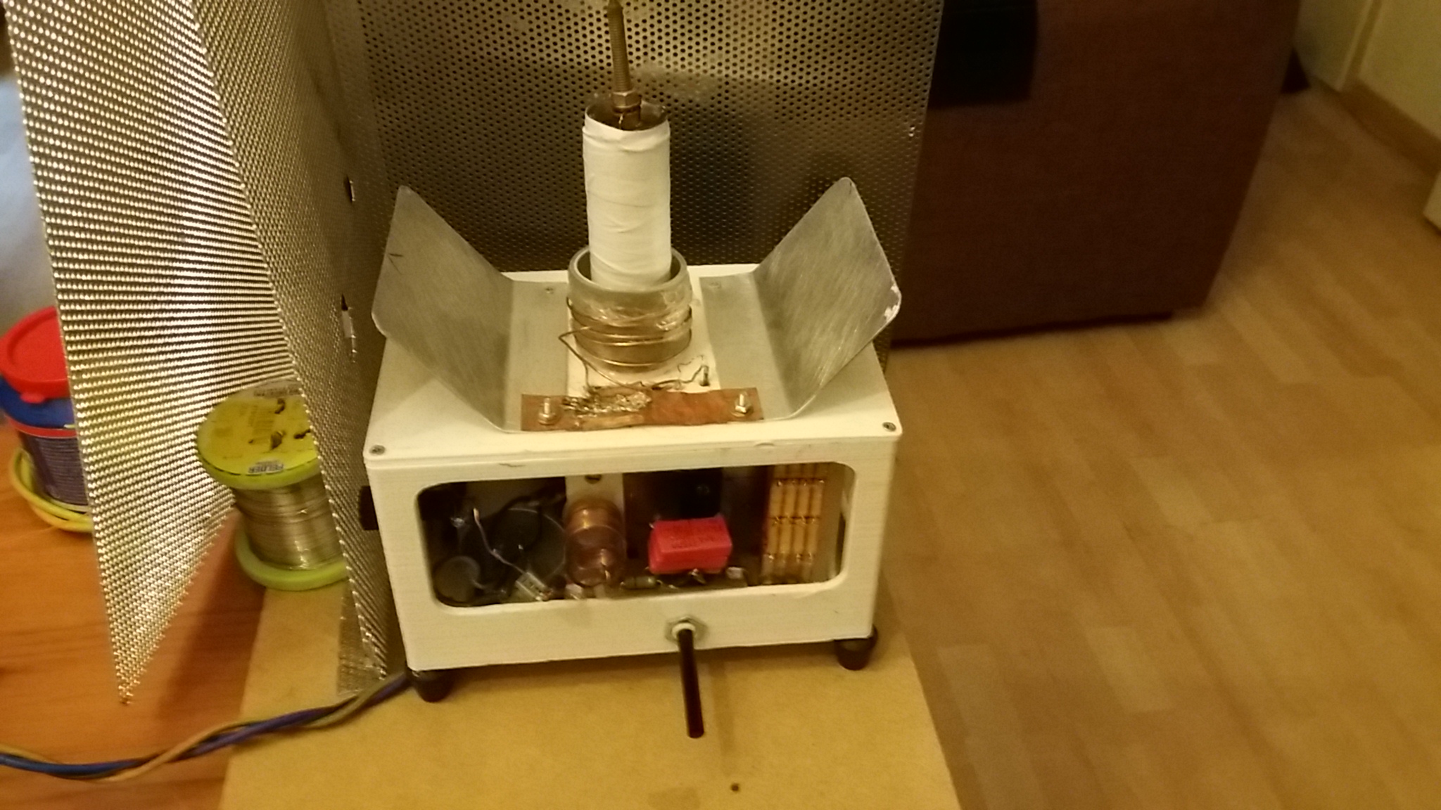

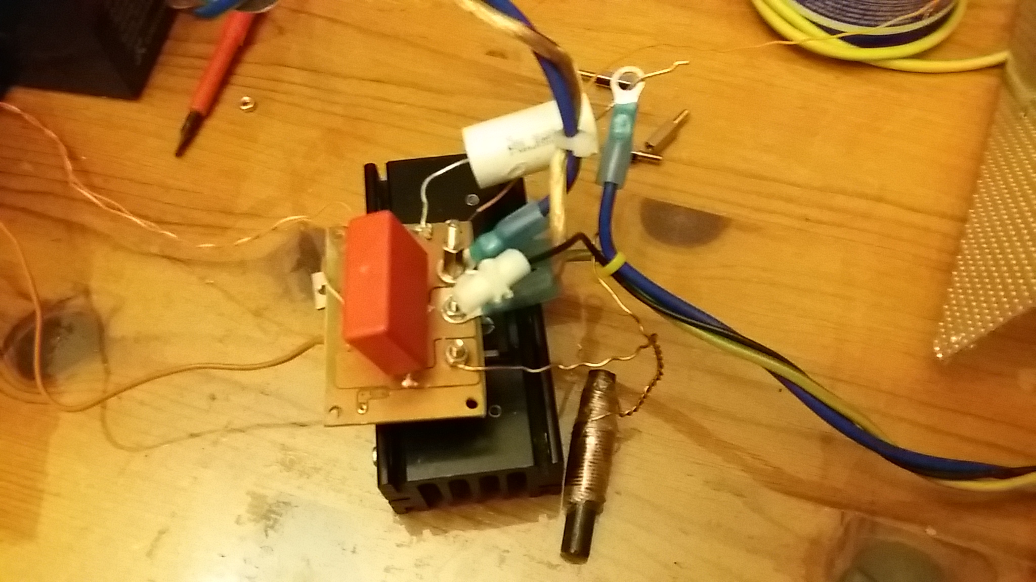

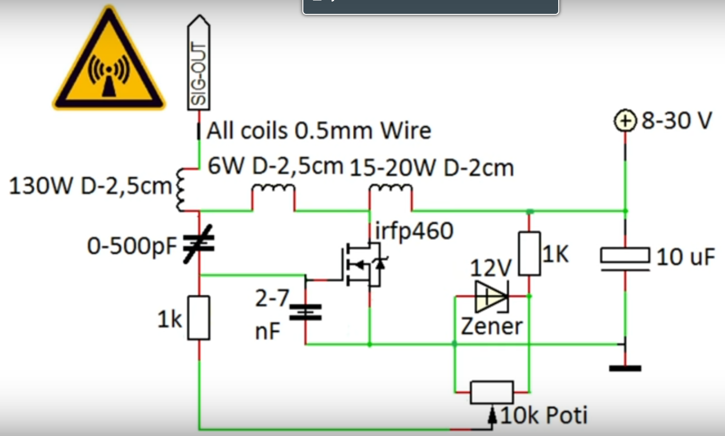

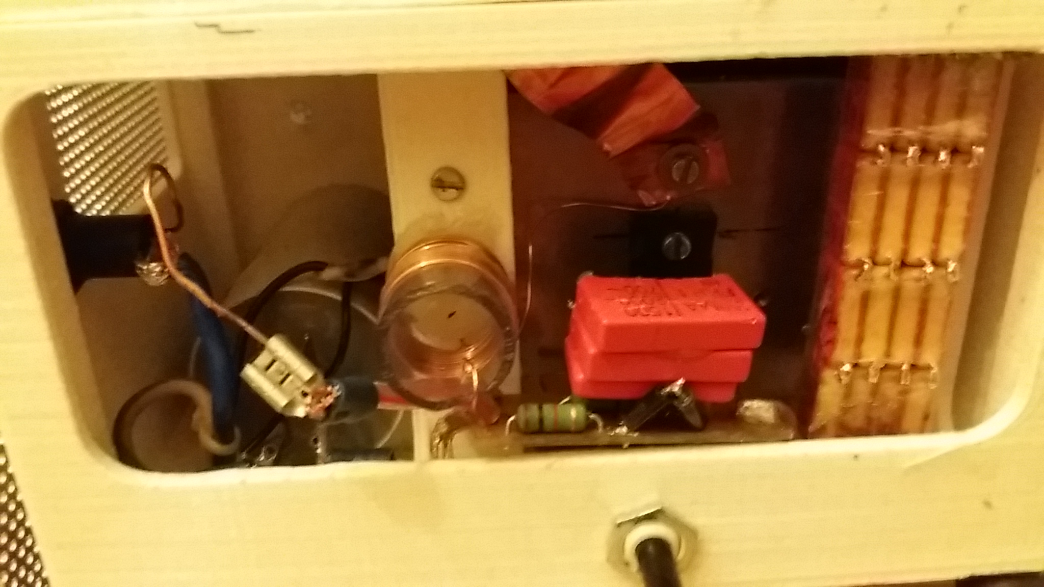

The high frequent solid state tesla coil has a resonant frequency of 10.87mhz.
I used a modified version of the schematic put up by teslaundmehr (youtube).
Wich looks like this.
attachment.php
For instance i ditched the variable capacitor and replaced it for a fix mmc.
I added a couple of plates to the mosfets drain wich seemed to increase feedback quite a bit.
My peak input voltage is about 52vdc on the video's, i have tested input voltage till 65vdc.

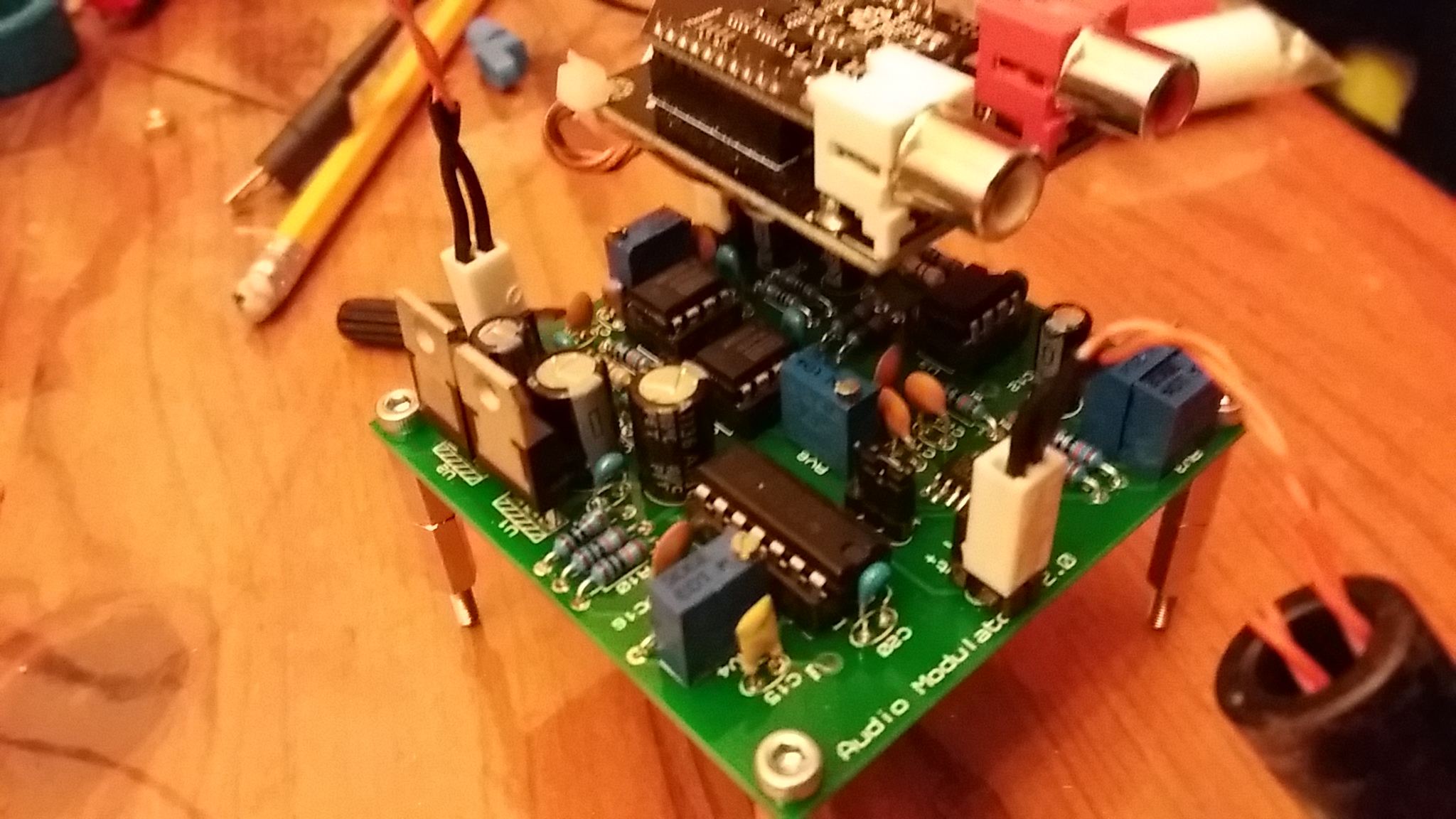

The audio modulator i made for the device is made out of a few building blocks.
- Triangle Osc.
- Triangle Preamp + Buffer
- Bluetooth audio module
- Audio filter/preamp + Buffer
- High speed comparator
I used parts like tl072, opa227, 40106, tl3016.
The bluetooth audio module was a cheap module bought from internet.
attachment.php

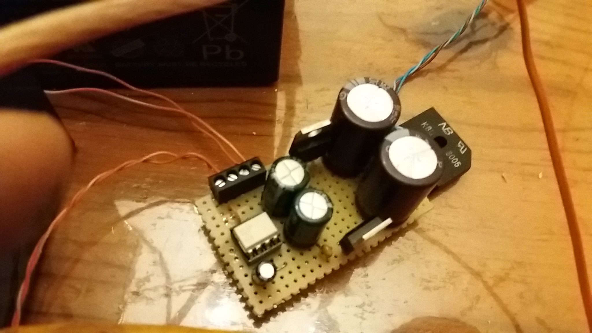

The buck converter consist of a single switch (igbt fgh60n60) cutting the dc at x frequency pwm thats provided as a singal to a fod3184 opto isolated gatedrive ac.
The fod ic has its own transformer to supply for a positive and negative rail.
The output of the igbt is passed through a LC lowpass filter to translate the pwm into a useable voltage for the HFSSTC.
(This is still the protoboard same goes for the buck switch)
