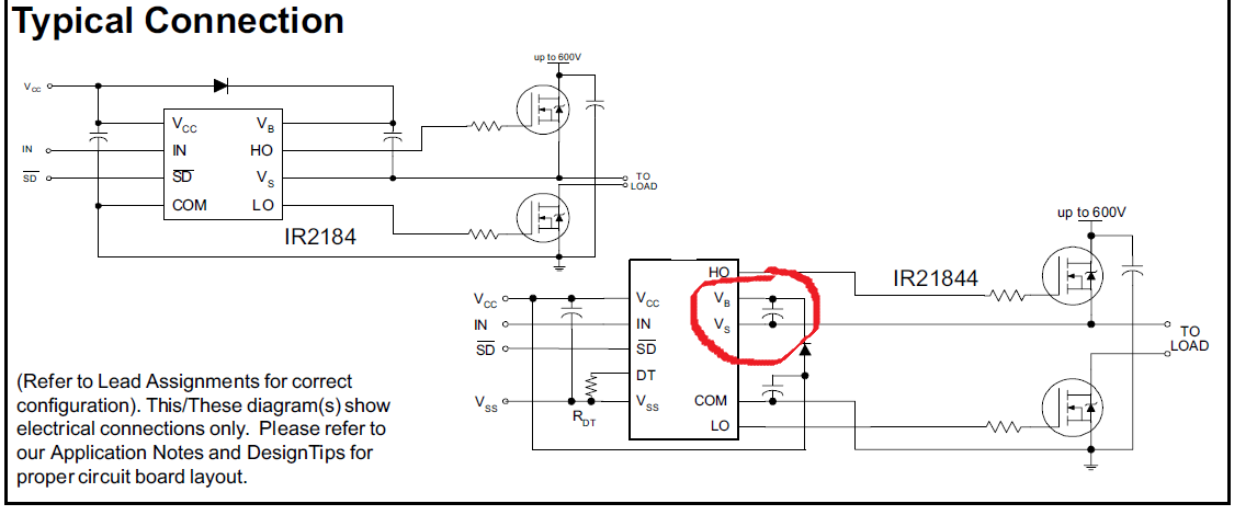

I have a general question about class D amps like hifonics,emphaser ground zero and so on...
is the square wave signal,which comes from the driver board still present at the gate connection point if i remove all of the output transistors from the board?
or stops the driver board working without connectet Mosfets?

There is no answer that covers all of those amps. For self-oscillating amps, you may get a square wave if you drive a signal into the amp but to get both high and low-side signals, you may have to make other changes (which would be specific to the circuit used in the amp being repaired).
If the outputs are out of the amp, you should be able to drive a 100HZ (or close) signal into the amp and get a low-side signal on the low-side gates. To get the high-side, you may have to provide an isolated (from ground) power source. I use a 9v battery. Then you may have to ground the high-side FET source pad to view the gate drive signal.
You have to be very careful because there will be high voltage on the high-side drain and the low-side source pads. Those are connected to the rail caps.
If you use a 9v battery, you should insert some sort of over-current protection. A 1 ohm 1/8w resistor would work. A 1 amp fuse should also be OK. The negative side of the battery will go to VS terminal. The positive to the VB terminal. You can make the connection on the ceramic cap connected to VS and VB.
You mean this points?
100%confirm you don't have a shorted inductor or the inductor coils rubbed through silkscreen shorting out to supply rail or wherever.I had everything perfect once,drive signals everything.Even checked the inductors in circuit and all 4 were fine.You may have 2,doesn't matter.
After time I fired it,boom all bad.Months later found an inductor rubbed through silkscreen and shorted to the +rail trace I believe.Lots of wasted money on that job.Inductor checking is very important because there generally installed poorly on practically every amp design.
Over time I have found ways to start the amp more or less with reduced chance for unexpected output explosion.Regardless 21844 amps have to be carefully checked or plan on losing on the quote you gave the customer.
Ps the small inductors and I think 1 ohm resistors in the vs path? Check those twice.Serious problems when that 1ohm(I believe it's 1) drifts to 10ohm~ also the small typically green inductors is a another problem I've heard of.Have seen the feedback resistor(1ohm) loose tolerance(wish I had one here to refresh myself).But when you have output/driver failure that resistor I think ends up between vs and have to look it up but it can get a large load on it and never split or burn.
I've seen it 3,4,5 ??times..it can burn you...check absolutely everything in the drive,return,protection path.Just check it all...or take the 24n40 and 21844 and toss em so they don't blow in your face...Kidding,just be thorough,just letting you know what's burned me good.

You can try with just one mosfet in each bank, and testing without load. And measure first on the gatesresistors the squarewave signal (only on the low side), without the mosfet mounted.
Do you have audiosignal on the input of the driverboard?
