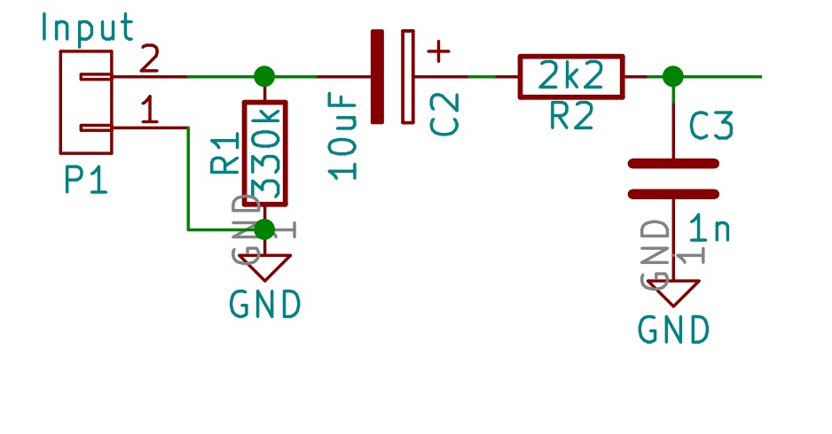

Another problem now is the input stage. I have some very high noise when the input filters are connected (capacitor in series and capacitor to ground) and the output stays high and it burns my mosfets.
The amplifier is working great if I ignore the input capacitor (I tried also 10uF polarised and 1uF non polarised).
This is the order of the input block : Signal -> resistor to ground -> capacitor series - > resistor in series -> capacitor to ground.
It is a high pass filter followed by a low pass filter. The "capacitor series" is the problem, without it it works great. Just a small hiss, but that is because I used NE555 and not LMC555. I measured with the oscilloscope the triangle output and it has a frequency of only 144KHz, not 200KHz. I will try to use a LMC555 to see if that changes.

Every amplifier has mains noise if you connect a cable to the input and leave floating, since it is capacitively coupled to the environment. You can reduce it by properly shielding both the amplifer and the input cable. (And/or of course by connecting the source, or shorting inputs.) The ground loop is an other, not that trivial way to receive hum (mains induced noise), but it behaves very differently from what you described. Generally both mechanisms work at the same time, but one is stronger than the other.
