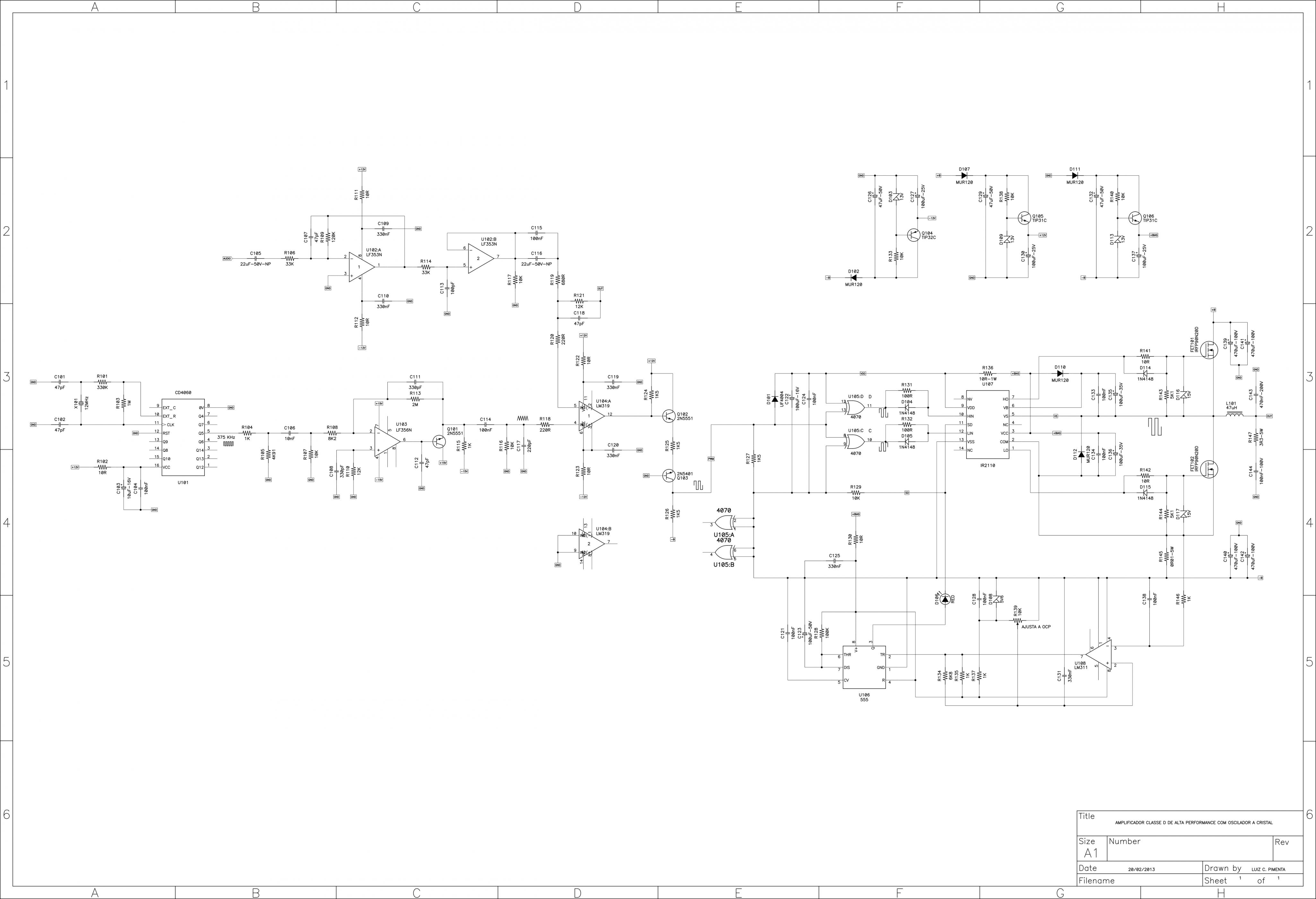

Class D amplifier with the crystal oscillator.
Good morning everyone.
My contribution to the forum.
I drew three PCBs (clock / signal input / PWM generation, comparator and power stage / protection).
I'm designing a new layout on one plate.
circuit already tested and fully operational.

Looks like D500 🙂
Looks like D500 🙂
Yeah looks like the D500, or part thereof.
The power stage is the same except the setting deadtime that does not exist in D500.
Could you send me the files from D500?
I have other amplifiers based on IRS2092. If you want I can send you by email.
What type of sigal should enter on D200 ?
BF or BF+250kHz ?
Audio signal 1,4v RMS max. from preamp (mixer) to D200 input, +/-55V from PSU and speaker on amp output are all connections.

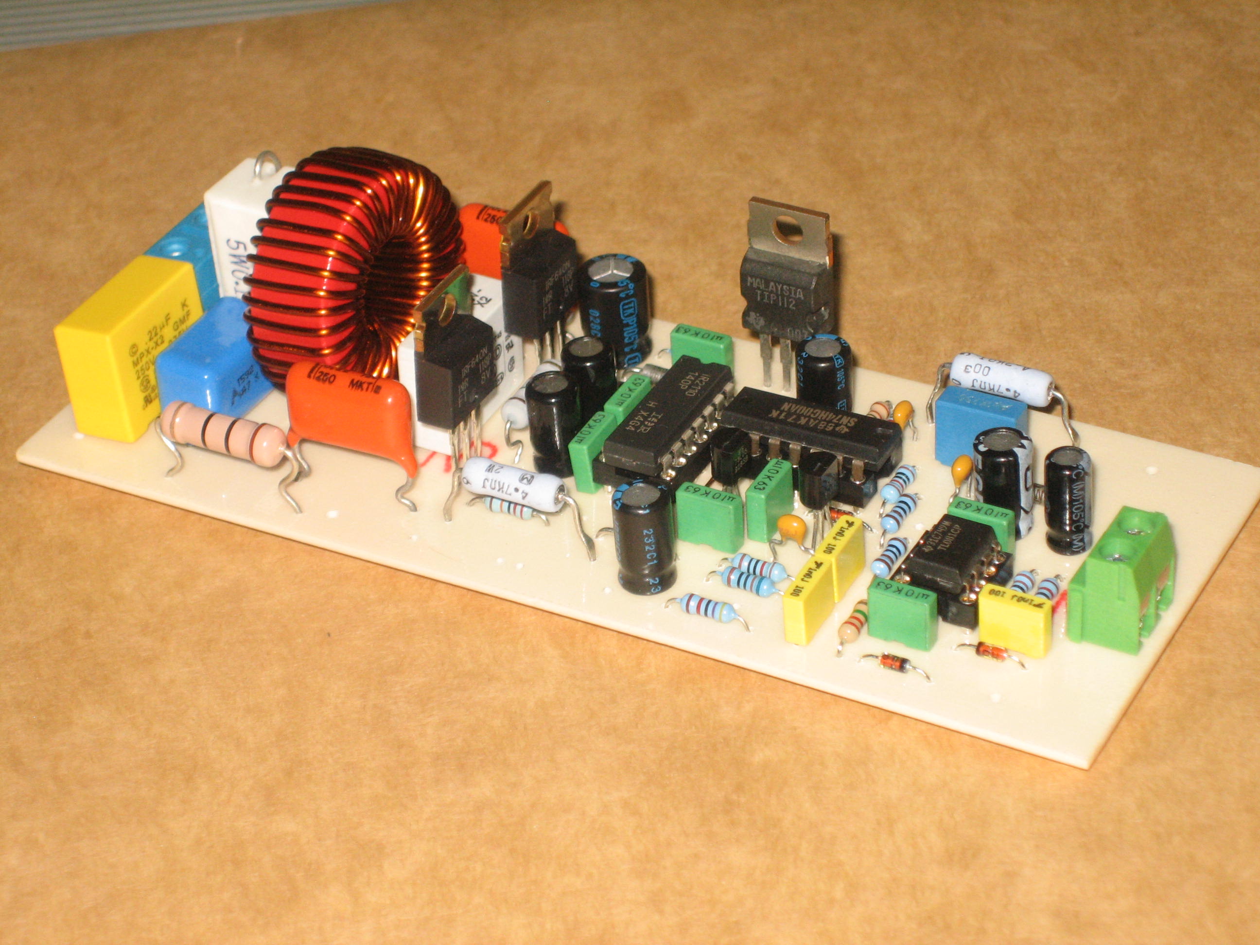

Pdf layout for d200.2 ?,im really building this at 90 v along with a smpsu
Also has anibody did a different layout with the mosfets at the side of the board so they can be mounted to a heatsink,since i want them mounted to a heatsink,a big one with a fan,a long tunnel cooling the modules and the smpsu transistors
I also heard that using a bigger output inductor [180uh] makes amps sound better,is it the case with thiss one,or does it break it
Sir Mile,
3 questions here;
1) At -/+42vdc (30vac traffo) PSU, do I have to reduce 4.7k 2w limiting resistors supplying the 5.6v zeners?
2) I have here a TIP117 can I also use this for the bias regulator instead of IRF640?
3) I cannot find a 0.1ohm 2 watter resistor (current sensing) and the closest I can get was rated 0.5ohm 2w. Will this work as well?
Thank You!
3 questions here;
Thank You!
Sir Mile,
3 questions here;
Thank You!
1) Use 2k2/2W
2) Yes use TIP117 with 13V zener
3) Use 0.05ohm/2W or 10x0.5ohm/2W in parallel
