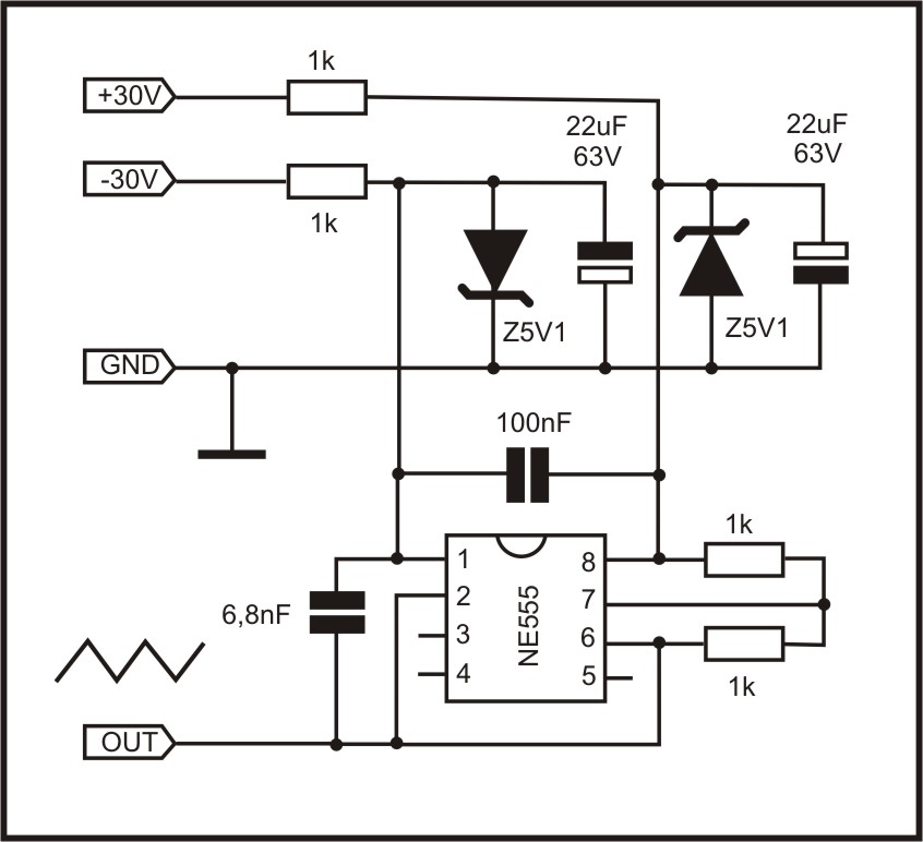

Triangle Oscilator with NE555, out can be connect to pin 5 of LM393.

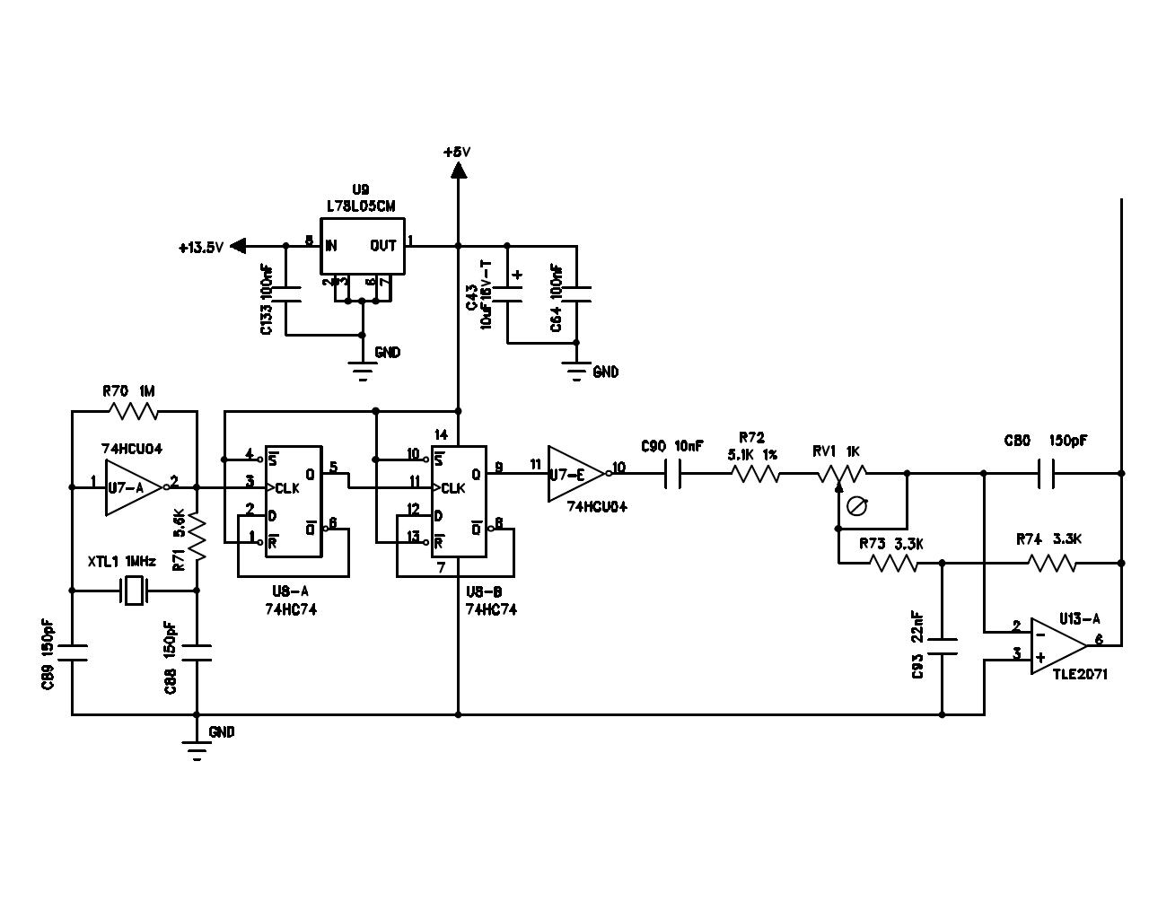

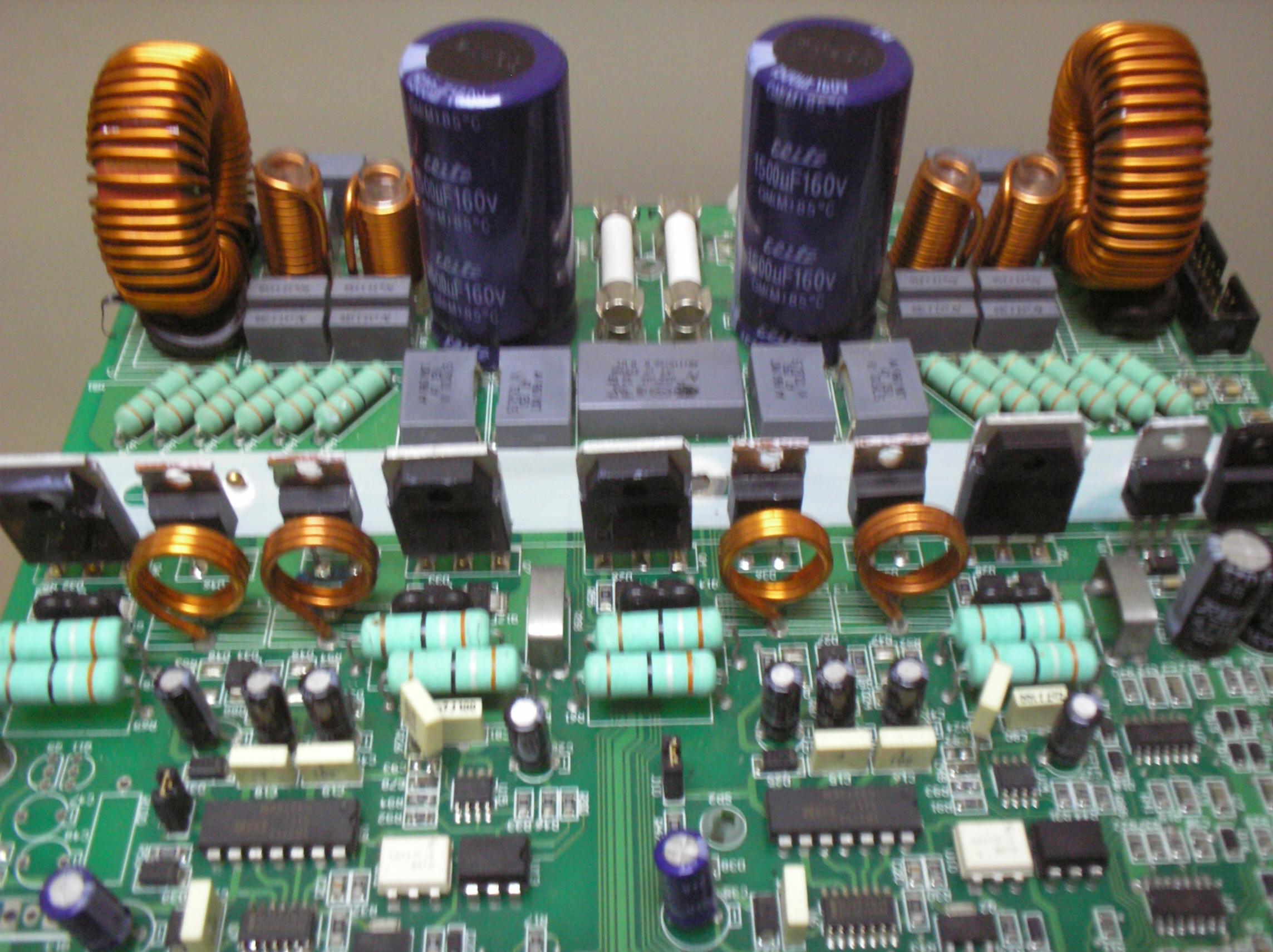

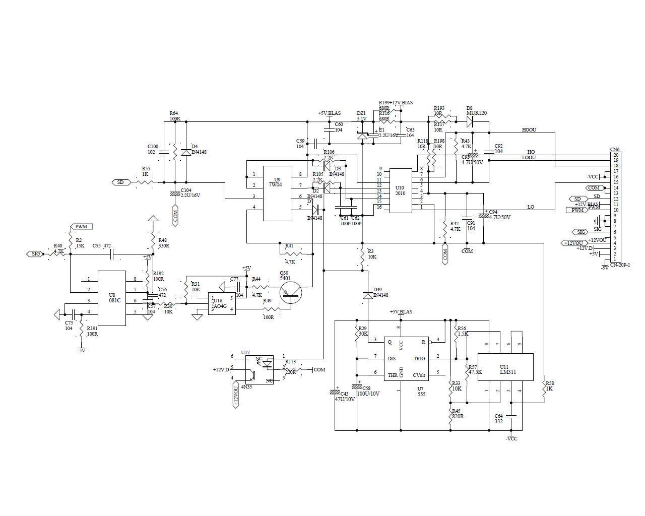

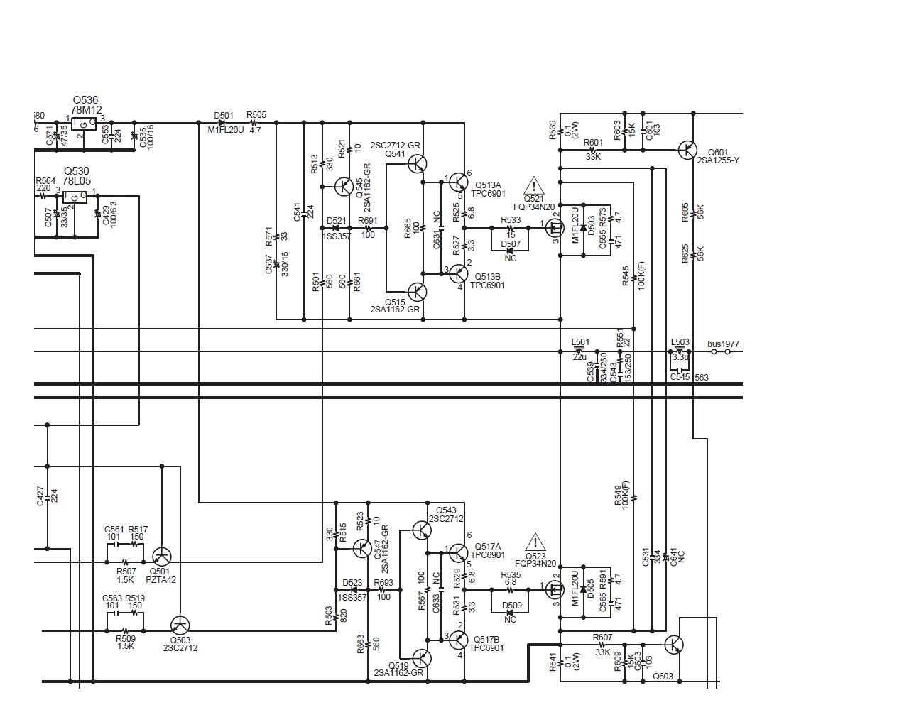

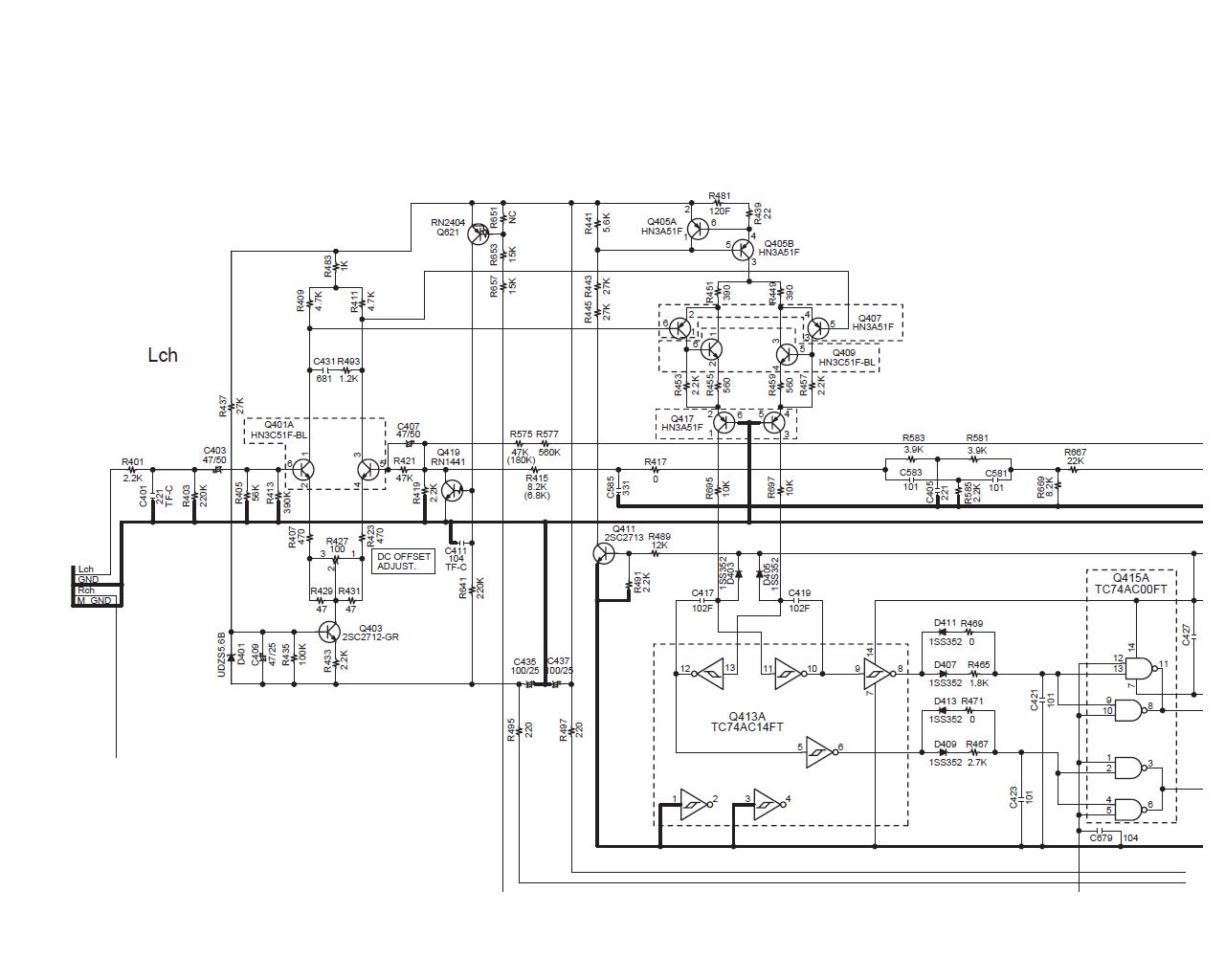

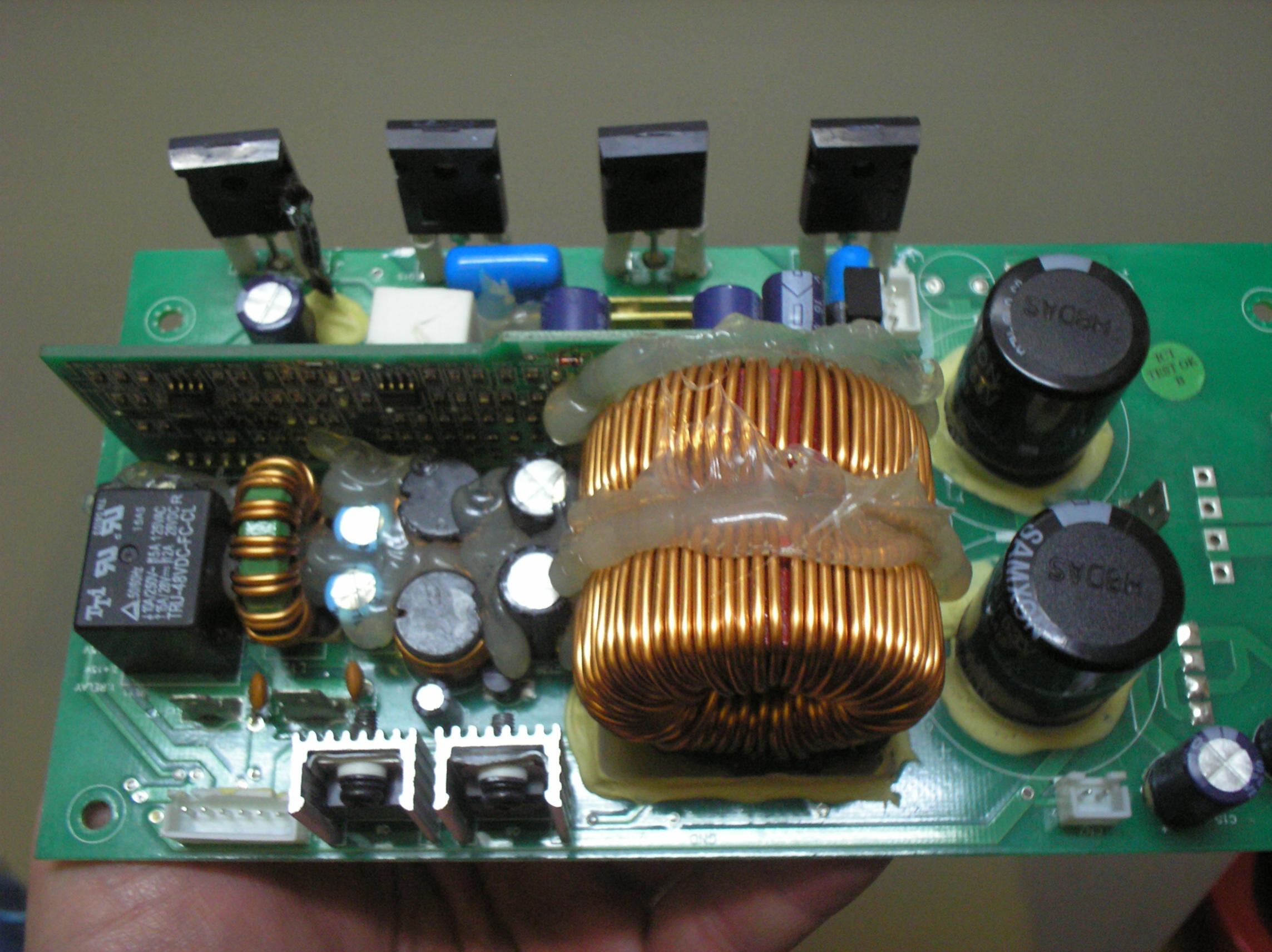

I can't find simple 'diy frendly' functional amp on this forum... this is JBL full bridge 500W amp with TL072, IR2111 and 4xIRFP250, work good with 18inch PA sub. Next is CREST clone with NE5532, LM319 and IR2113...
