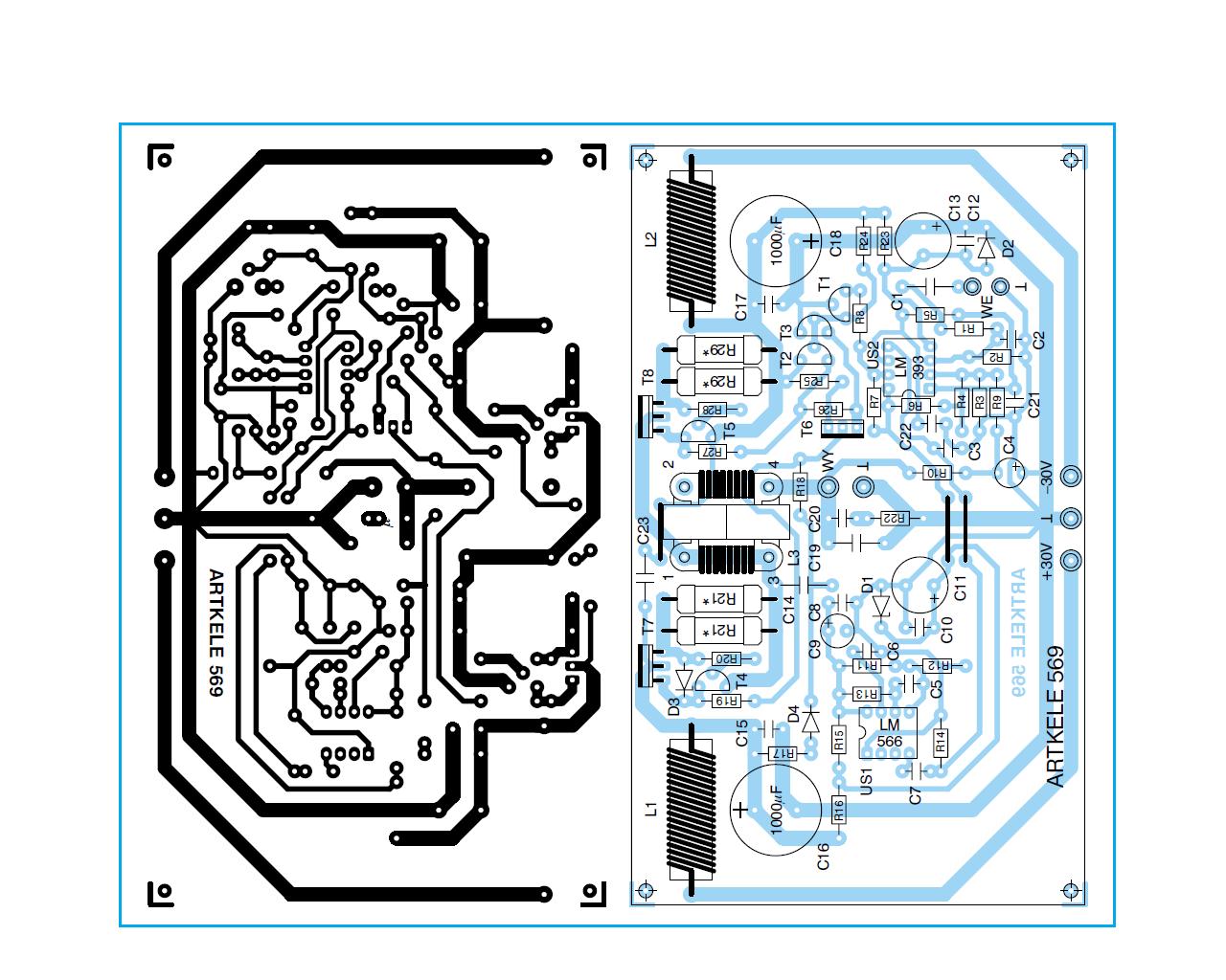

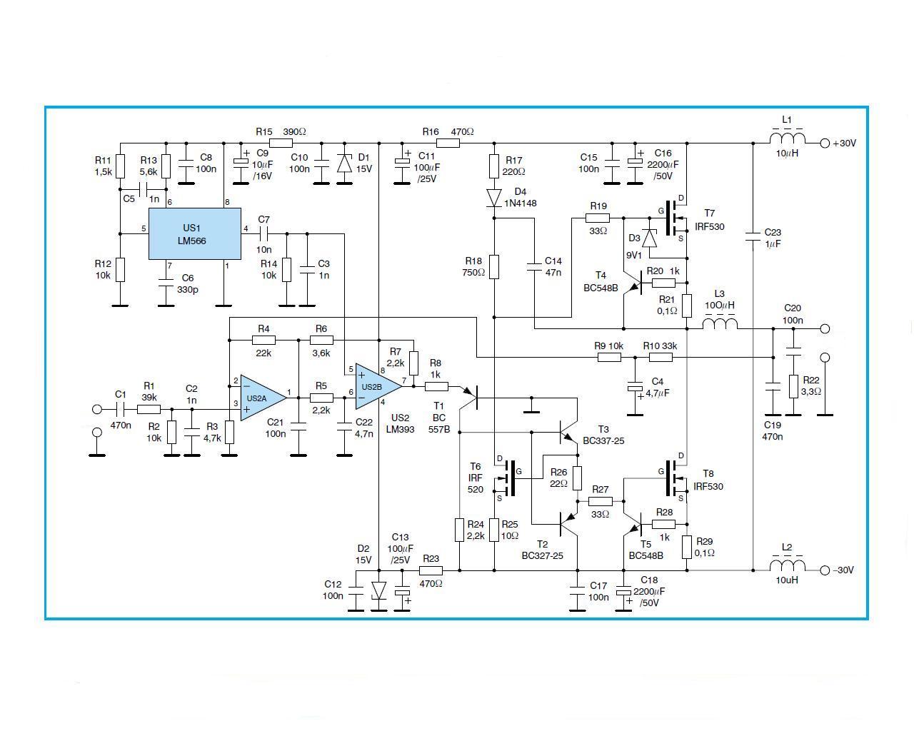

LM566 VCO seems unobtainable.
Yes, triangle oscilator can be done with MC1455 or with some OP.
The schematic looks just slightly under average, but PCB layout is terrible.
There are better ways to do it with these parts (and TL07x op-amp triangle generator and LM319 comparator, standard stuff).

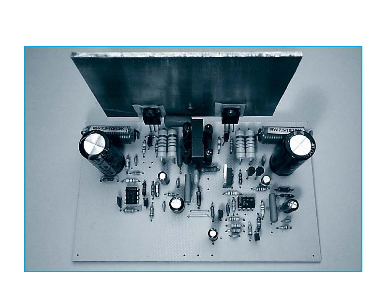

One of the things I have in mind is making a simple DIY-friendly class D module with through hole parts (except a few SMD caps) and a "DIY friendly" double sided PCB (no tracks on top layer, just continuous ground plane), and find out how good can I get it.
I'll be waiting with interest on this. My PCB done in this manner is already doing fine and has a very large number of SMD parts - zero. 😀 But innovative stuff such as better gate drivers will be appreciated.

is this topology comparable to Hypex UcD ??
is it this magazine (not the issue of the pic) about follow URL ??
Everyday Practical Electronic Magazine December 2007 » Full Software Downloads - Download For All
No , this is from Poland 'Praktikal Elektronik' magazine 1/2001.
This is classic topology with error amp, triangle oscilator and comparator, not self oscilating topology like UcD.

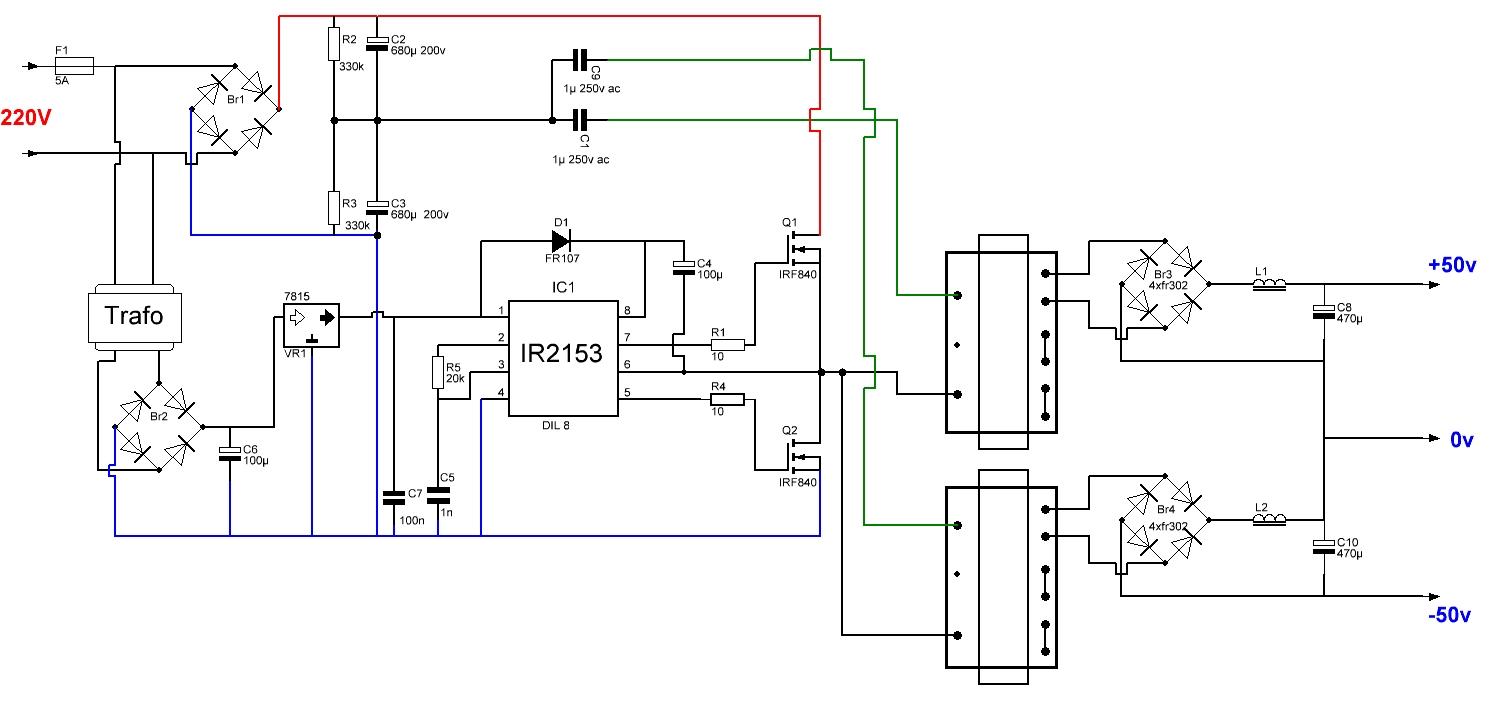

Have tou try that SMPS???DIY friendly +/-50V SMPS PSU with two transformers recicled from ATX PSU.

No, it can be use for 150W amps, I find this on YouTube: http://www.youtube.com/watch?v=rXwqFiZ0sJE
SMPS
Actually I wanted to make a SMPS for PA but I am afraid that the leakage current in the psu or something like a PC.
There are solutions to this problem?

U can use case of PC PSU for your SMPS, and find more information about leakage current... http://www.eetindia.co.in/ARTICLES/2004NOV/B/2004NOV16_POW_TA.pdf?SOURCES=DOWNLOAD
I did a similar project using a TL082 triangle wave generator, LM319 comparator, XOR gates phass splitter and IR2113 mosfet driver.
I didnt use any feedback at all yet it sounded great.
The only minor problem I found was I needed to null the DC offset using a pot or i got low level hum. Must have been an inaccuracy somewhere in the line.
Feedback is only for DC servo on this amp.
