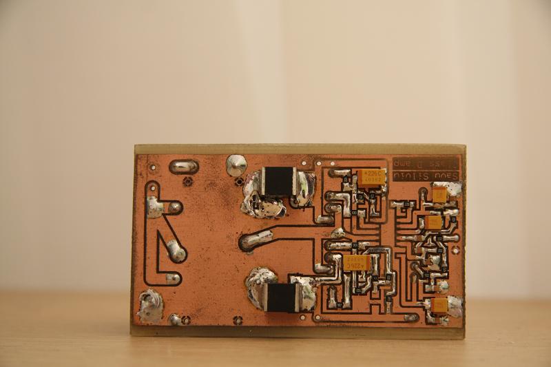

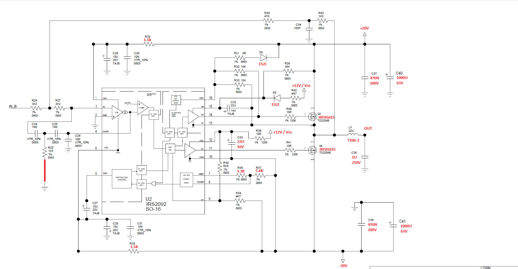

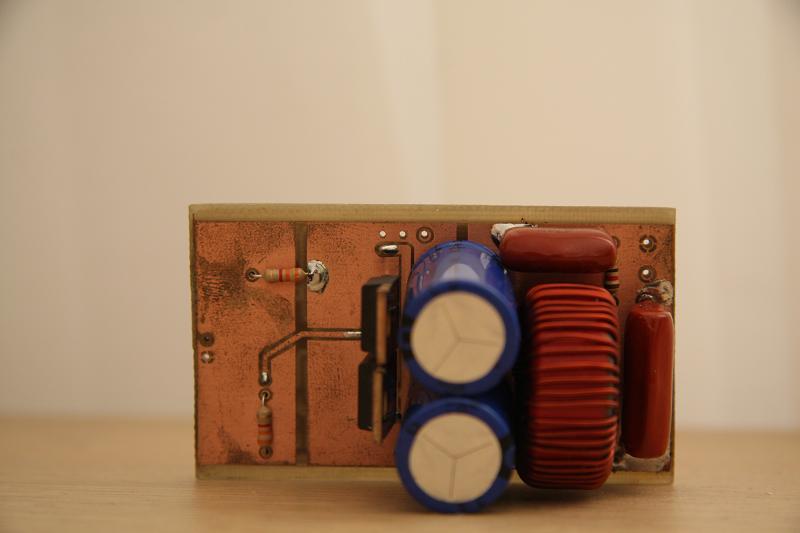

Hello all,
I have redesigned the pcb of this amp and built it.
Attached there are pictures with the almost complete work.
It is a bit smaller than an ipod nano 5th gen.
Powered at only +/- 20Vdc load a 4ohm small sub.
Fets used were IRFB5615.
I have encountered the following problems:
- the thing never started until i messed up with the low side over current voltage divider resistors.
- over current protection was almost always triggering when it was playing hard base.
- used about 3Vdc on the OCSET pin.
That means 3v*32mOHM = 96A. (hope i am right 🙂)
The thing is fried for the moment since i have shorted something because of my very tight PCB.
I am redesigning it to make it slightly bigger.
Please give me some pointers to where i have failed in making the over current protection work.
regards,
savu

The over current protection looks at DS voltage to see if it is too high.
If your MOSFETs arent switching on fast enough this will cause the same problem. What value gate resistors are you using ?
My 2092 amp wouldnt power up and it turned out to be a glitch on the 12 volt rail which i cured with a 47uf capacitor on the vcc line.
The 2092 wont start up unless vaa, vss, vcc are correct with no glitches.
Then the 2092 will power down if the positive or negative DS voltages are out of range.
A wrong deadtime could also cause problems, I use 100ns currently on mine.
My only differences from the 2092 datasheet are 47uf vcc decoupler and i use IRFB4227 MOSFET's.
hello sir,
10ohm is the value of the gate resistors.
All the components are exactly as mag's schematic at the beginning of the thread.
the starting up problem was fixed but the over current protection always tripped.
regards,
savu

Are you clipping the amp ?
I believe it is designed to cut out if clipping starts.
I am not sure so look it up in the application notes.
I believe there is also a warning about vb dropping out if the amp clips and this will cause a reset.
Well ... to be honest i think i was clipping it.
It is hard for me to decide if that was clipping. I tested it with drum and base and dub step.
That kind of music has very profound and long base lines.
If the amp stops when it reaches clipping then that is what really happened.
But sincerely I am not so sure. I will finish the new PCB maybe next week and i will use the same component values.
regards,
savu
regards,
savu
regards,
savu
Have you experimented with deadtimes ?
If you have too short a deadtime then you will get shoot through amd this will cause an over current event.
I use 100ns at the moment.
Hi Savu,
I had exaclty the same problems you are finding at the beginning:
1) the chip was not starting
2) OC protection tipping too early
1) It was due to a too low voltage on VAA / VSS supplies. In my original
desing I derivate the VAA/VSS from the +/-50V rails using R5 and R6.
On top of that the VAA/VSS rails supplies also a TL082 used as input
preamp. There was too much voltage drop across R5 and R6 and the
voltage pn VAA/VSS was too low. I fixed it by replacing R5/R6 with 2.2k.
If you are suppling with +/-20V check the value of those resistors, if you
are using 3.9k as in my original desing it is possible that it won't start or
that the voltage on VAA/VSS is just above the lower limit.
2) In fact there are 2 current sensing circuits: the low side and the high side.
The voltage on OCset is related only to the low side. If you have put
Vocset=3V you have set the low side current limit at 3V/Rdson=93.7A
which is more or less equivalent of disabling the protection. What about
the high side current limit? Resistors R9 and R7 set the high side current
limit. Check on the IRS20955 datasheet how to calcuate the values for
those resistors. On the IRS2092 datasheet nothing is explained.
In my design that is used in brigde mode with 4ohm load and +/-50V rails
the output power is around 900Wrms and my current limit is set at
something around 25A. Occasionally, when I am really pushing it too
hard, the current limit trips but for me is ok... it avoid to blow out my
subwoofer when I am pushing it too hard.
If your desing works only when the current limit is set at 90A there is for
sure something wrong. It can be a shoot-trough on the brigde or a too
high source inductance of your mosfets due to bad layout that creates
voltage spikes.
Check your dead time! My design works with 75ns dead time but I am
using IRFB4227 and not IRFB5615.
IRFB4227 IRFB5615
BVDss 200V 150V
Rdson 19.7mohm 32mohm
Qg 70nC 26nC
tr 20ns 23.1ns
tf 31ns 13.1ns
td_on 33ns 8.9ns
td_off 21ns 17.2ns
IRFB5615 is faster than IRFB4227 and its Qg is much smaller. On top of that
IRFB5615 as a very small turn on delay (8.9ns) and a turn off delay comparable with IRFB4227 (17.2ns vs. 21ns). This means that if 75ns dead
time is ok for IRFB4227 (with 10ohm gate resistor) it can be not enough for
IRFB5615 (one mosfet turn on when the other is not yet turned off creating
huge shoot-trough current because of the very fast td_on of the IRFB5615).
Increase your dead time at max and see what happens with a current limit set
at no more than 30A. Try also increasing the gate resistance, my design works fine with 10ohm but your mosfet are faster and Qg is much smaller. Maybe increasing Rg to something around 22-33ohm will be ok.
For the high side current limit I have used a slightly different configuration of R10, see attached schematics.
Other questions.
You tell that you have used my schematics but what about the output filter?
I see only one inductance (probably T106-2) but on my design I used a 4th
order Bessel type filter set at 35kHz on 2ohm load (due to BTL connection).
If you just copied the first part of my filter (22uH + 1.4uF) it is possible that
it is not right and your frequency response is peaking at high frequencies, please check.
Don't make it clipping. The IRS2092 is not too happy in this case. To avoid this I have set my current limit just before clipping. It is something I can do because I am using the amp only on one subwoofer , if I change the woofer
probalby the current limit needs to be re-adjusted.
Can you post your schematics, just to have a look. I am very happy that someone has tried to build this amp
voltage spikes.
IRFB4227 IRFB5615
BVDss 200V 150V
Qg 70nC 26nC
tr 20ns 23.1ns
tf 31ns 13.1ns
td_on 33ns 8.9ns
td_off 21ns 17.2ns
Other questions.
ciao
-marco
Hello Mag,
Here is what i did.
the amp is fried for the moment but i will redo the pcb to make it slightly bigger and in a week or two i wil start building it again.
Modifications apear in red on the attached schematic.
regards and thanks for the info
savu
Here is what i did.
savu
