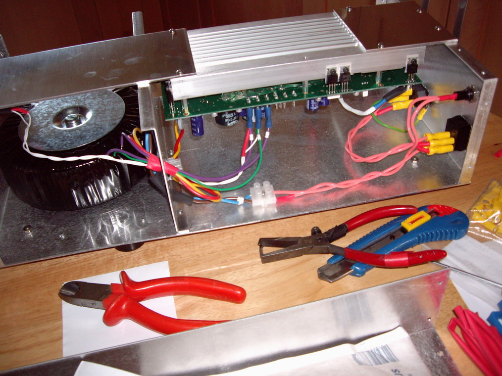

Work in progress with my Sure TC2000/TP2050. Power supply was delivered yesterday, just got it hooked up today. I'm planning on getting/making a small case for the amp PCB itself & housing the power supply seperately on the floor.

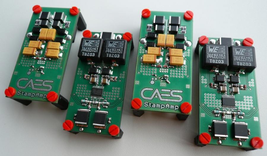

Here are my small amps modules - a prototypes to a further project - nearly as small as big stamp so I called them StampAmp :) The modules are based on MPS chip MP7782. Starting them for the first time I was really surprised - the small guys sound really amazing driving my 4 Ohm ELAC 207.2 with JET tweeter.

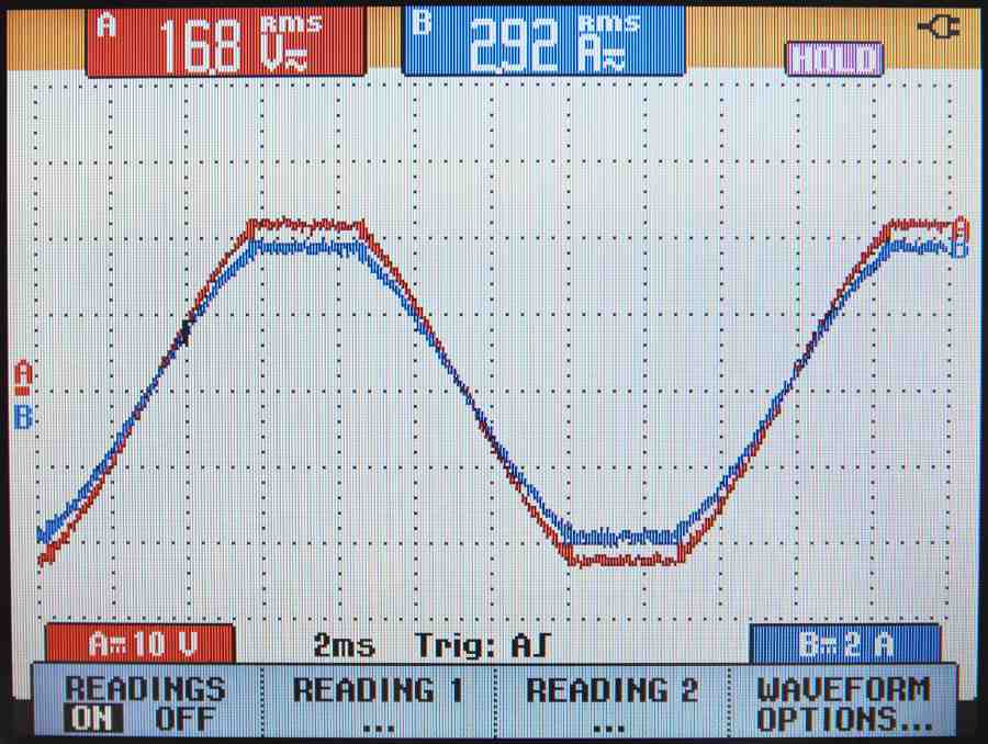

VERY SMALL! looks like a nice clean layout too, whats the power ?
The chips are rated according datasheet at 50W with 10% THD+N what means definitely clipping in my understanding. I've got exactly the results, see the screen shots below. Continuous power of 40W without any heat sink for 1min - with small heat sink for 15min on 6R on the first screen shot. On the second 50W with clipping - is it 10% ??? hard to say :) Playing really loud music below clipping level you do not any heat sink!

Very neat and tidy - I like! :)

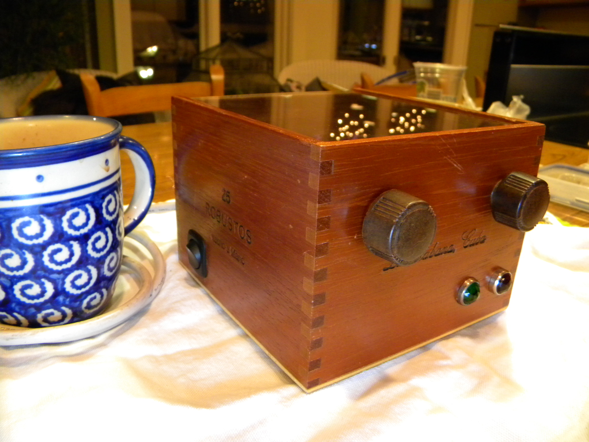

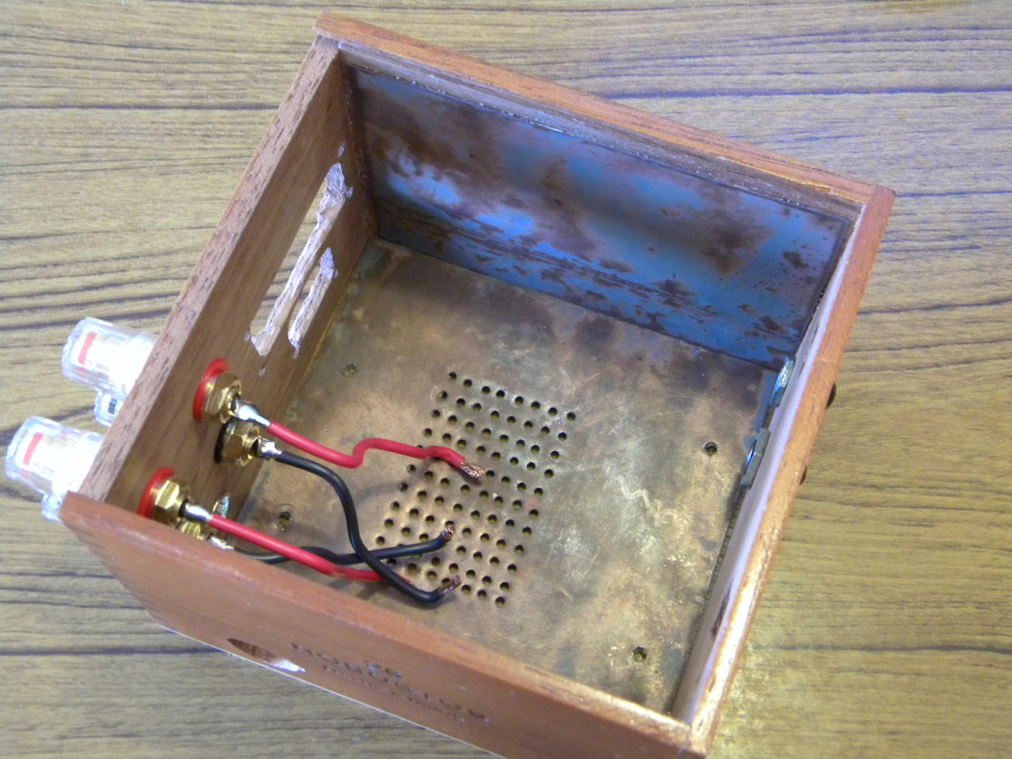

Arjen MKIII TA2020 fits nicely in a cigar box.

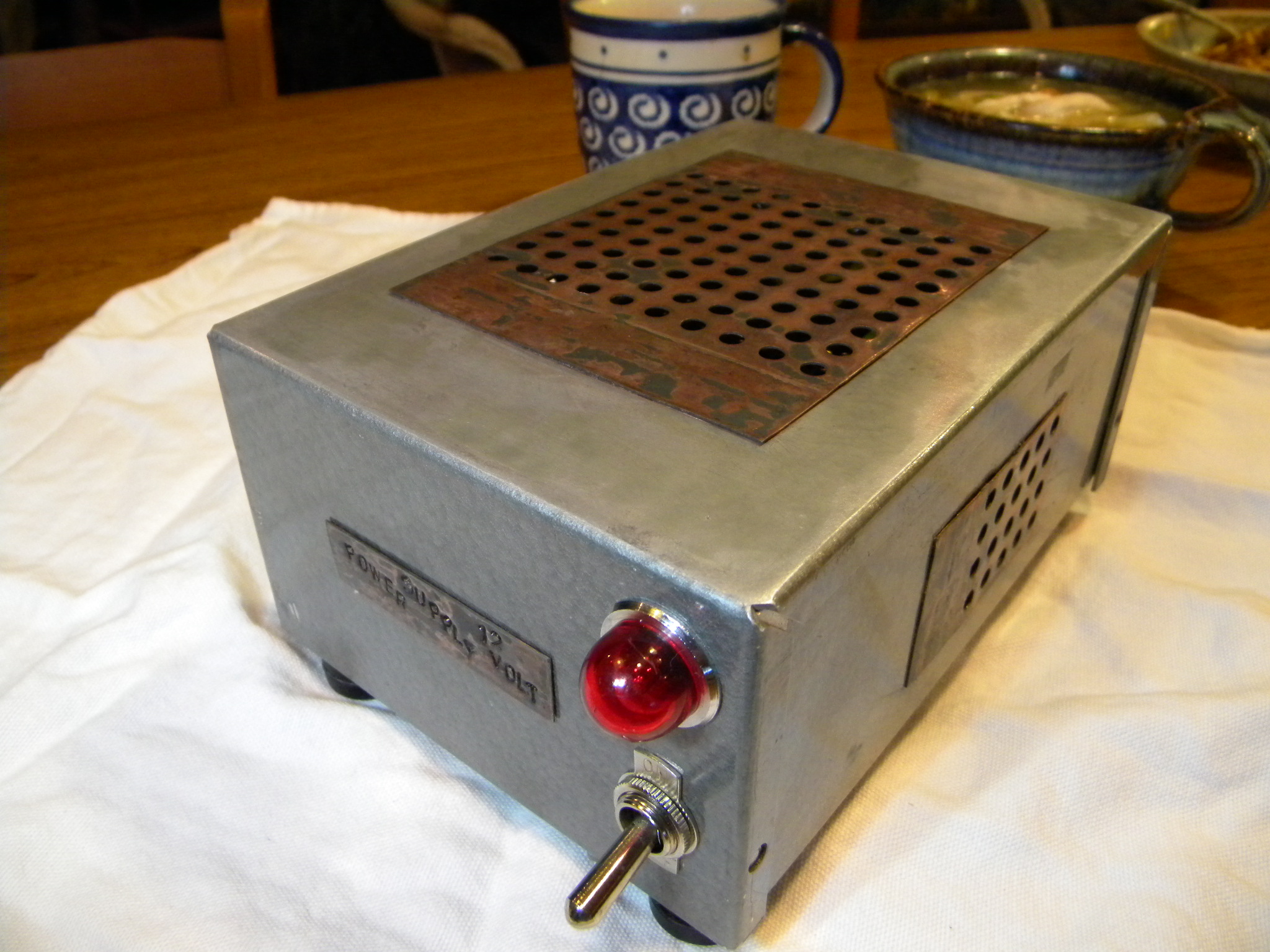

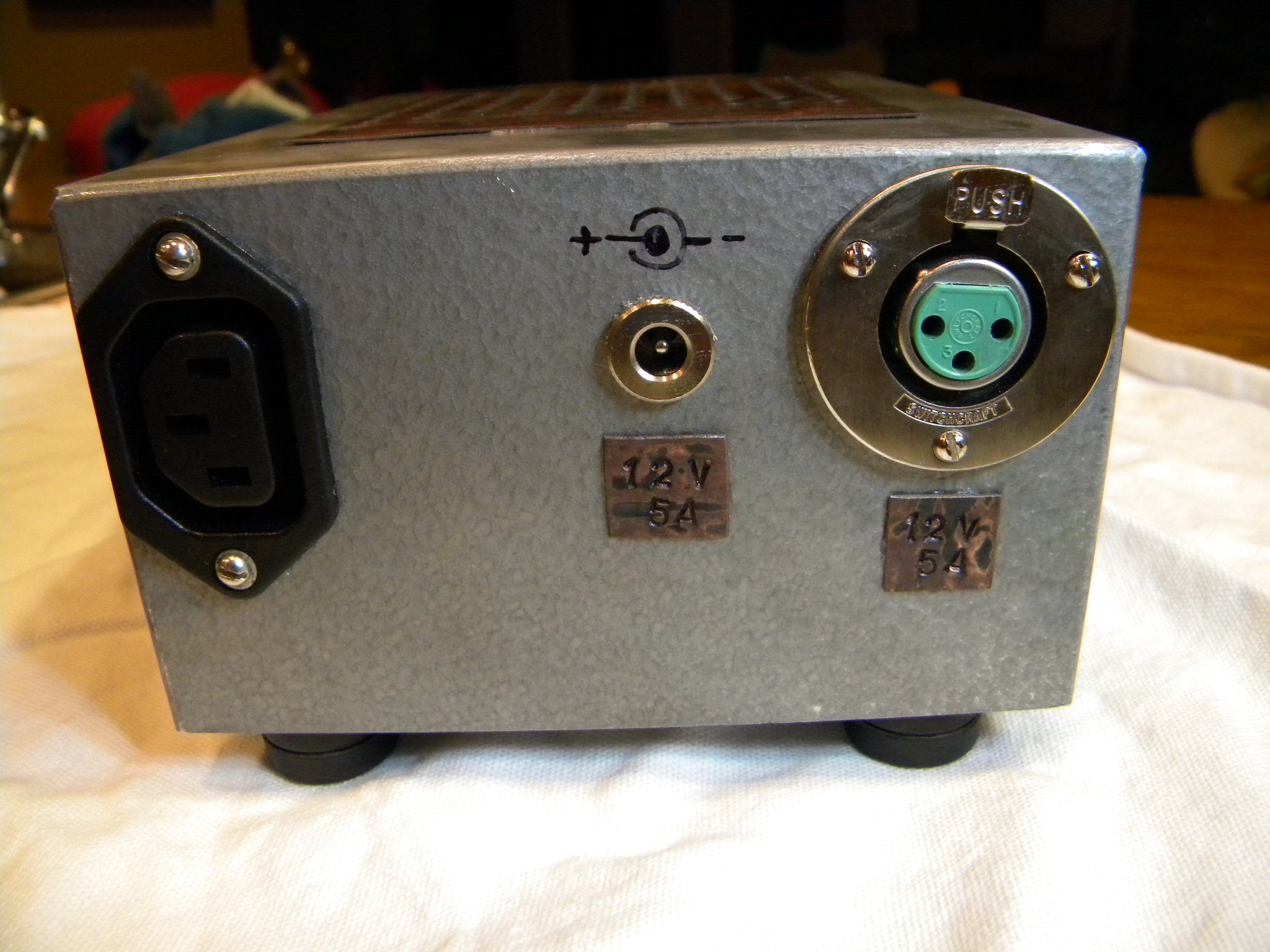

It's been snowing today so I've been busy wacking together a little project. Actually,I am finishing up an Arjen Helder TA2020 T-amp and power supply combo that I started on last weekend. It is still breaking in so the caps are still a little shrill but just today it is starting to smooth out to the point I don't miss my ST-70 with the VTA mod so much.
Pardon the Cuban cigar box. I found it at Goodwill for a dollar (and I'm sticking to that story). The power supply box is an old project box which came in a box full of old 1940's and 50's toy train parts that I have used some of the switches and lights from too.The copper accents are from the back plate of a gutted Akai M-8 reel to reel that was converted into monoblocks last year.
Happy Holidays and enjoy the Snow!
