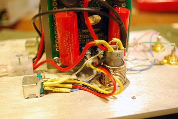

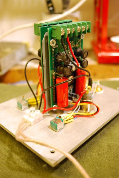

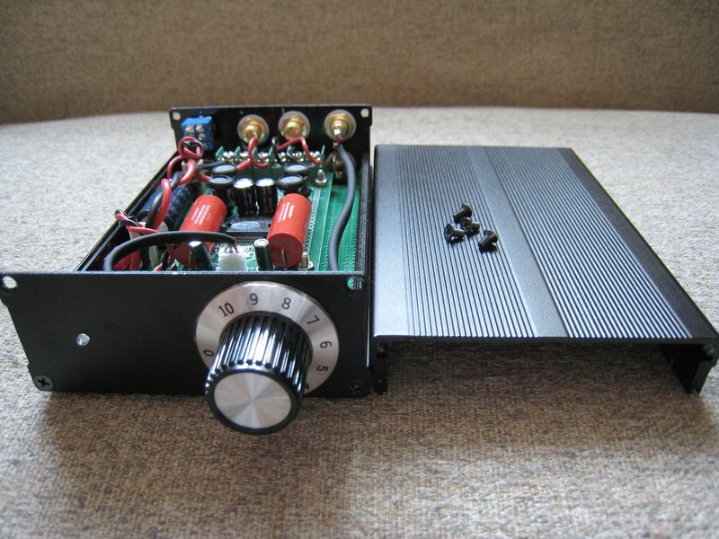

I recently finished this 4-channel Amp built with two Class D Audio IRS 2x250 modules (they can be bridged to make a 2 x 500W amp, or a 3-channel 2x250, 1x500). I included a relay for 12V triggering by my receiver. The case is a Hammond 2U aluminum one (with my screws). I built this for use as a sub amp, but it sounds very nice with my Abbeys, driven from my receiver preamp.

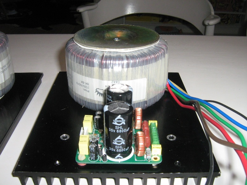

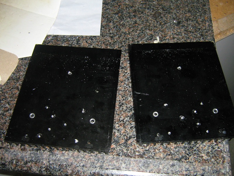

Connex NXD 8950th project

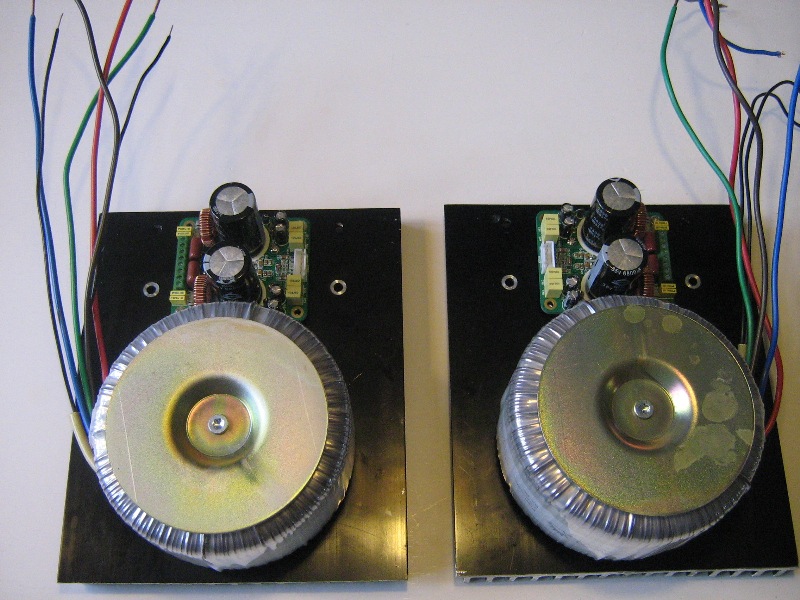

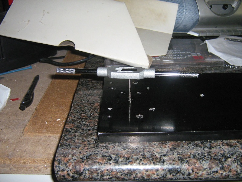

First drill holes for mounting print and mains transformer. Then cut 3 mm metric threads with the threader. I have divided my heatsink in two, so I have to stereo amps. The mains transformer is 250 volt primary 2*25 volt secondary 300 VA giving 25 volt x 1,414 = 35,4 volts DC (I haven't calculated with overvoltage in my home installation and the loss in the rectifier bridge - but the modules can take a max. of 40 volts DC, so I shopuld be on the safe side).
Connecting mains tranformer requires soldering thinner cables, since the mounting wholes on the board at to small. Both speaker out and DC in are sitting very close to each other, so be carefull not to make any shortcuts.
I have 10 modules and have testet 5 of these. All worked perfectly.

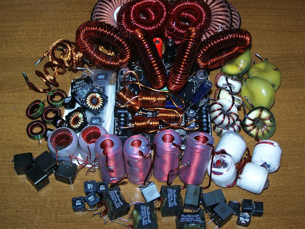

Coil Pile
These are all of the coils I have tried so far. Of the shielded, cored inductors the little Wurth XXL sound the best.
