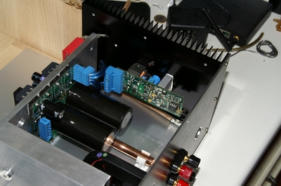

Hi ANDYLASER,
No, I only supplied the electronics inside the housing in this case. The customer constructed his own housing.
The front is made of 15mm aluminium on a CNC milling machine, the top and bottom are made of 4mm aluminium. All parts have been sand-blasted and anodized in black. The power switch is made of Niro. The display window consists of 3mm thick blue-tinted perspex. The "CLASS-D" lettering was printed on transparent foil and back-lit using 4 blue LEDs. The selected font imitates a graphical display.
My own housings don't look as good as this :(

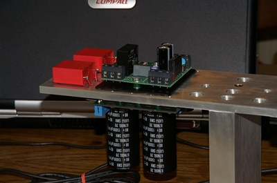

This one's for camping and visiting folks.
A TA2024 for portable use along with some A5 sized ply speakers made from drivers from a cheap pair of PC speakers.
About 3W+ drivers, Neodynium and shielded.
Only genuine 70's speakers will do ;)
It runs from a 12v 2900maH AA nimH pack, that weighs about 340 grams and cost £15, top up recharged with a 4W solar panel. I have since added some Elna Silmic IIs into the Power Supply and modded the input caps too. It sounds pretty good for the size and overall weight of it and the batteries last ages.
The bass is fantastic, compared with the original speakers anyway ;)

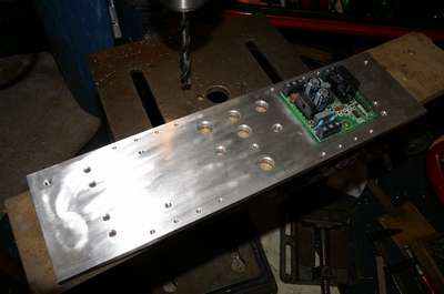

My surround amplifier (5 channels)
The box (330w x 230d x 40h mm)
The 5 UCD180:
Inside with Coldamp power supply:

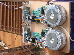

...and now, in two blocks version (2 + 3 channels)
2 channels with UCD180HG stereo, toroid and 40.000uF cap.

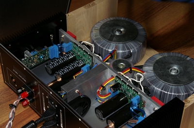

2 blocks. Rear view:
2 blocks. Front view:
