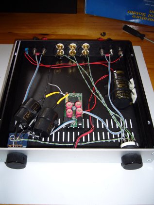

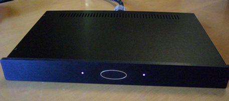

did you buy that case or build it? it looks nice.
The case is from http://www.hi-fi2000.it/ , an Italian company that does very nice cabinets. Quality is good and prices are reasonable (around 100 Euro for my case).

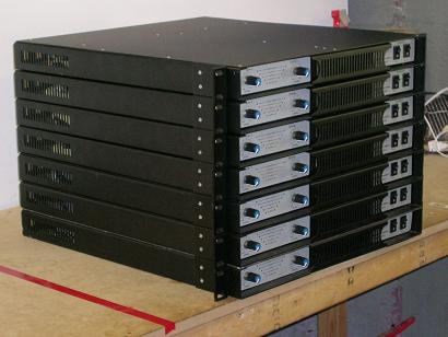

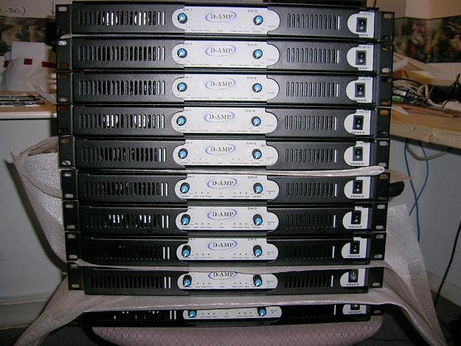

Just for you, 10 D-Amp for a ''small'' club in montreal...New DLS Serie..Class B-D, no carrier at no input signal...
Fredos
www.d-amp.com
Fredos
www.d-amp.com
Now for a rave...56KW of D-Amp 8000 HVI....Bit incredible!
Bit smaller than 11 Crown VZ5002!
Every body can dream of unlimited power now!
Fredos
www.d-amp.com

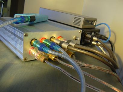

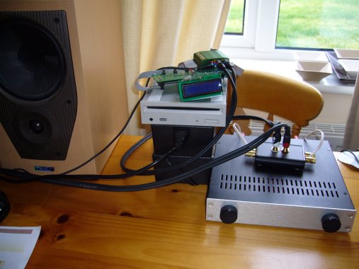

In fact I may as well post an action shot - Slot load DVD controlled by one of these kits through a Dac in a box into the Sonic T, all powered by Skynet 8080 SMPSs and out through an Audiomagus Subline to Mission M72s and a sub.

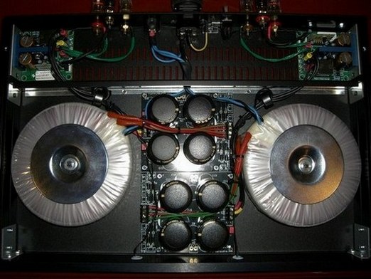

Here are a few pics of my Class-D amps. They are NewClassD monoblocks with 1000VA transformers and the large power supply modules from NCD. Also included in the amps are the NCD softstarters / DC blocks.
The cabinets are standard types, but I have made some internal ''cabinet walls'' from thick aluminium that works both for shielding and as heat sinks.
One of the pics shows the two box tube RIAA / Preamp that I'm working on for the moment. They are constructions from www.triodedick.com I'm working on internal ''cabinet walls'' for them similar to the ones in the NCD monblocks... Soooo many nice projects 😉

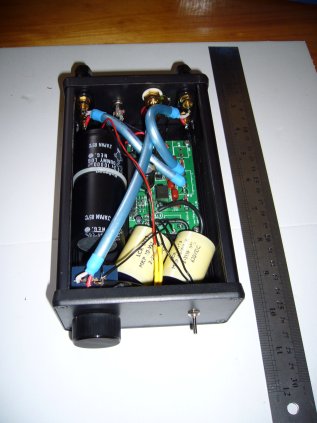

This is a photo of my first T-Amp project. It is an AMP6 kit from www.41hz.com.
This is the full version with the PSU on board. I am amazed at the efficiency of the Tripath chip and the performance it delivers.
I also put a short web page together that outlines my experience with the AMP6 T-Amp Kit.

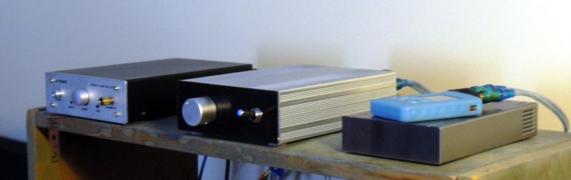

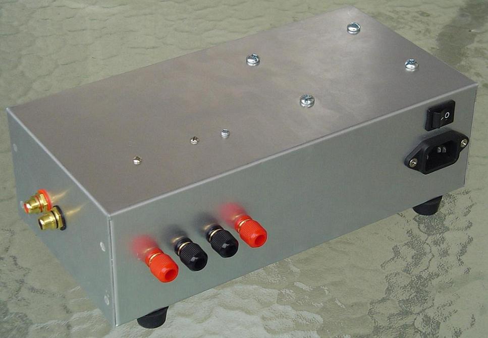

modded sonic impact
Nice builds everyone!

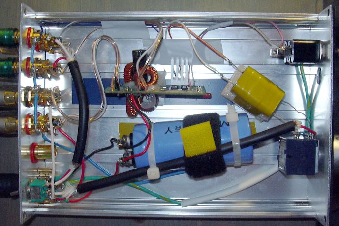

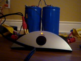

This is my reboxed and modded t-amp.
After my old board died, a very friendly guy from this forum offered me his modded board for the cost of shipping.
Thanks again, if you read this!
It features two inputs, alps volume control, 2.5 uF polyprop input caps, toroid inductors, a panasonic tank cap and some messy wiring....
Power supply is a 40W smps with 4700 uF extra capacity.
It's playing through my 96dB 80s Jamo floorstanders for now and I haven't heard them sounding this good before.
