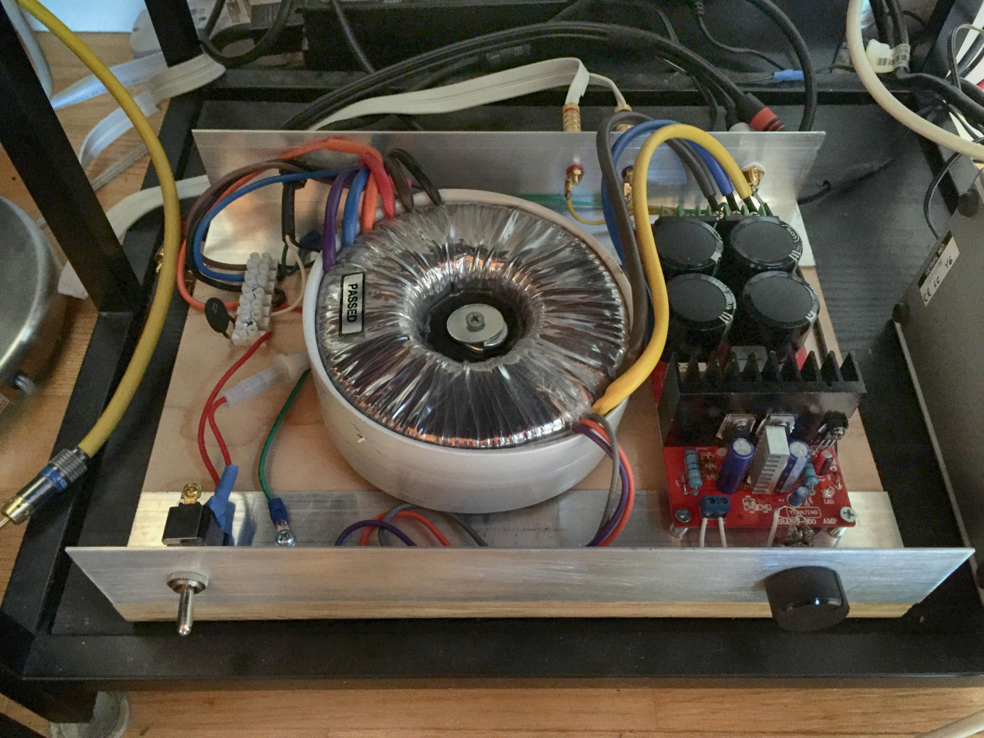

I think the amp was under $20 from China, and pretty much everything else was already lying around. The nice thing about this amp is that you just hook up a transformer and everything else is on board. Naturally I added a fuse and power switch etc.
The ideal transformer would be 45+45; this one is giving about 35+35, at more power than is necessary.
The gain is a bit low, unfortunately, so I'm using one side of my BA-3 to drive it. My system needs more gain because I'm doing equalization and a 2.1 subwoofer crossover with a Minidsp 2x4, which is limited to 0.9V output.
The size of the transformer is such that inrush destroyed the first (5A) power switch. I put in a 20A switch and a CL60 to reduce inrush and so far it all seems fine.
I also added a gain control so I can balance my subwoofer to my mains.
The whole thing took a couple of hours including building the (admittedly utilitarian) chassis.

It looks like the exposed terminal of your power switch would be live when in the OFF position.

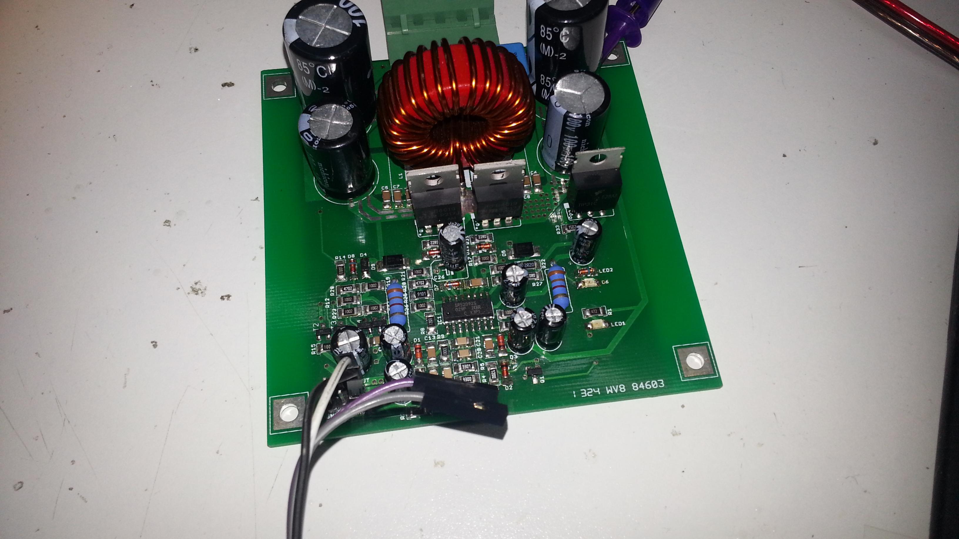

Hi !
This is my second prototype using the irs2092 , waiting for bench test.
+-60VDC
irs2092
irfb4019

Thanks , very helpful info ! I learned a lot from you !
You're right. Thank you for pointing it out. I'll fix it. But I'm a bit confused as to why - I need to think through the wiring some more. I wish I could find a switch with an insulating boot like some IEC sockets. Heat shrink seems a messy solution.
You may cut of the contact and seal the leftover with epoxy. (Or using doubled shrink tube, as this is a "proper/valid" solution.) Additonally glue some isolating plasting sheet on the inner top cover.

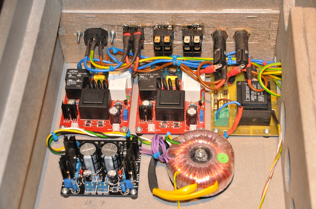

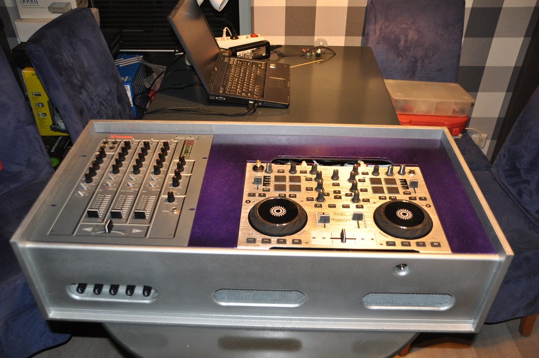

Have been around here for a while, and used this to get valuable info, so thought it was fair to show my build here.
Occasionally myself or one of the kids likes to throw a party, and what is a party without some (loud) music. I used to carry around DJ-Kit, mixer and amps as separate components, but wanted something that was easy to use and includes everything in one case.
And so this is the end result, a set build on the L15-D pro kits from ljm. The used toroids were a great find at only 35 euro a piece for 575 Watt each, so should have more than enough power to run 6 amps . All build together in a case from 12 mm MDF, and spray painted metallic gray.
The speakers are build from a set of DynAudios rescued from my previous car, together with a Boston Rally Sub. I have to say really happy with the result, the amps sound great, and the complete kit can play music at insane levels 🙂
