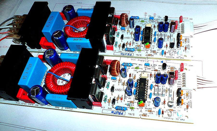

cheapo 8 channel L15D 4x 500va trafo noise floor on them is great plugged it into a 103db tweeter with no noise.
I was going to ask where the other 4 channels were until I saw that you had them stacked.. Well done!
Very impressive!
But, any thermal issues with the lower modules?
nope it was going to be 12 channels but i couldn't figure out what to do with them all so i only did 8 so there's about 4 inches between the top / bottom channels

Nicely done... I'm slowly planning on building a 5 channel amp just like your setup. I see all the components, and I also noticed the speaker protection circuit. Does the L15D require a speaker protection circuit? I thought the IRAMP7S (IRS2092) has speaker protection built in?
Did you add any line-in attenuation (can't see) or is it straight through from your pre-amp/receiver?
protection
Yes. You need speaker protection circuit, because the mosfet failure cause dc error on output.

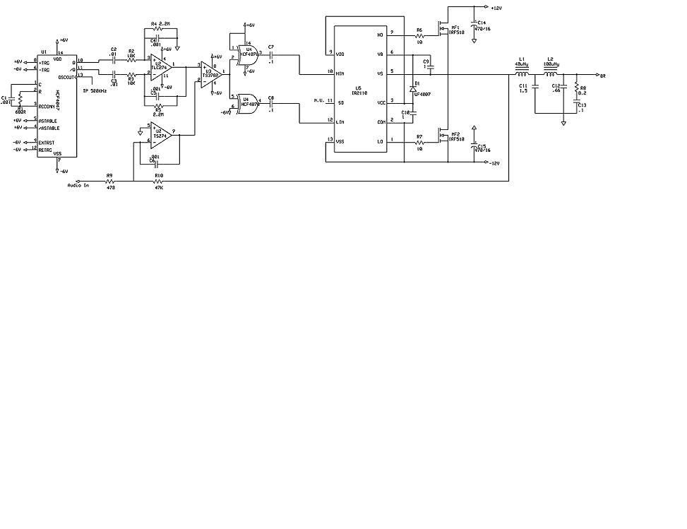

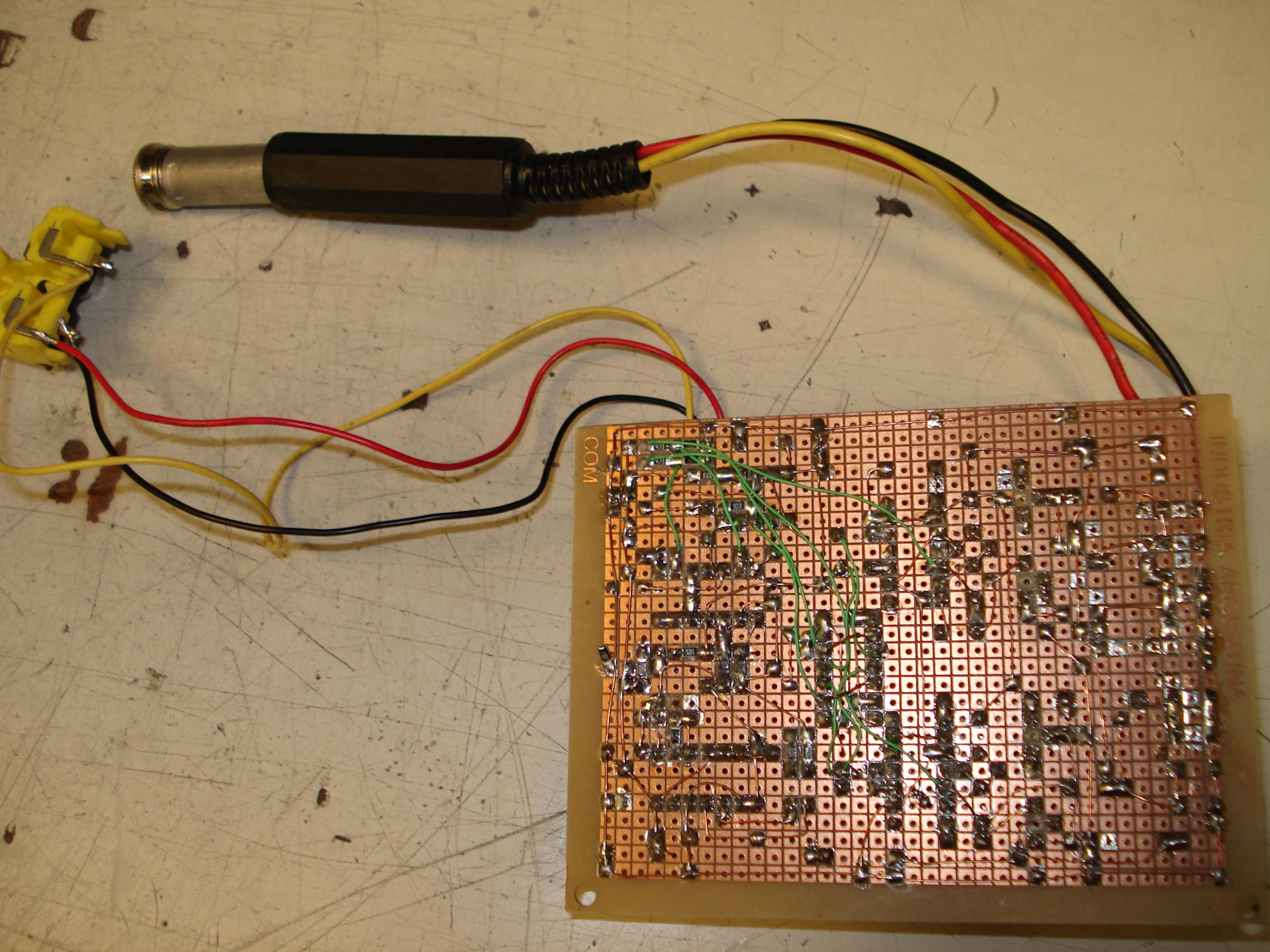

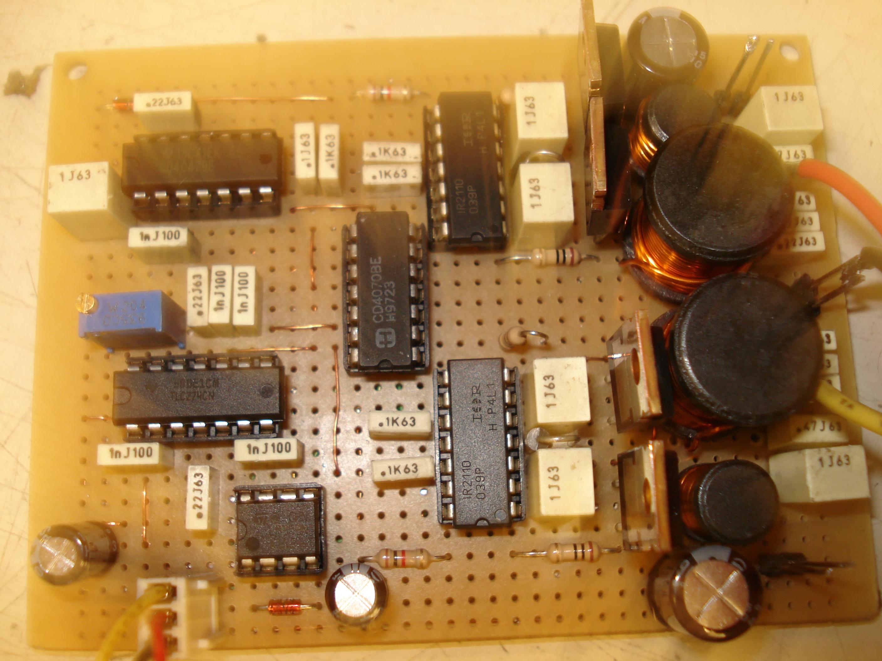

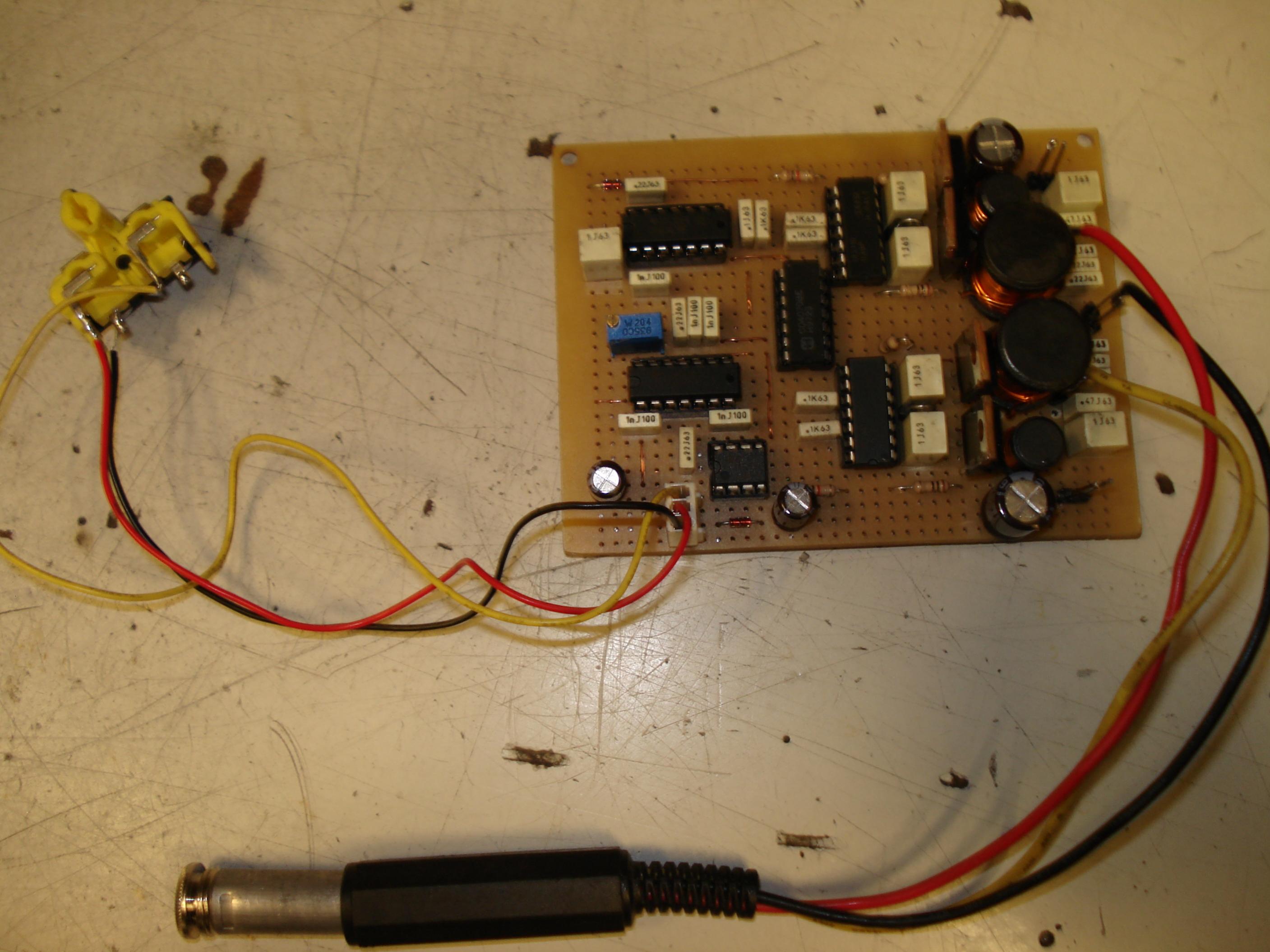

Here are some (bad) images of my project: a Class D stereo amp using standrad parts. Sorry, I´m not a good photographer!!!
Observe the white caps oriented all in the same direction, and the 4 dark tanks to the right, they are the inductors of a 4 pole output filter, too close between them, and too high mutually coupled, but this is only a protoboard. I´ll place all in a new piece of board, and properly spaced.
Briefly I will post the schematic.
