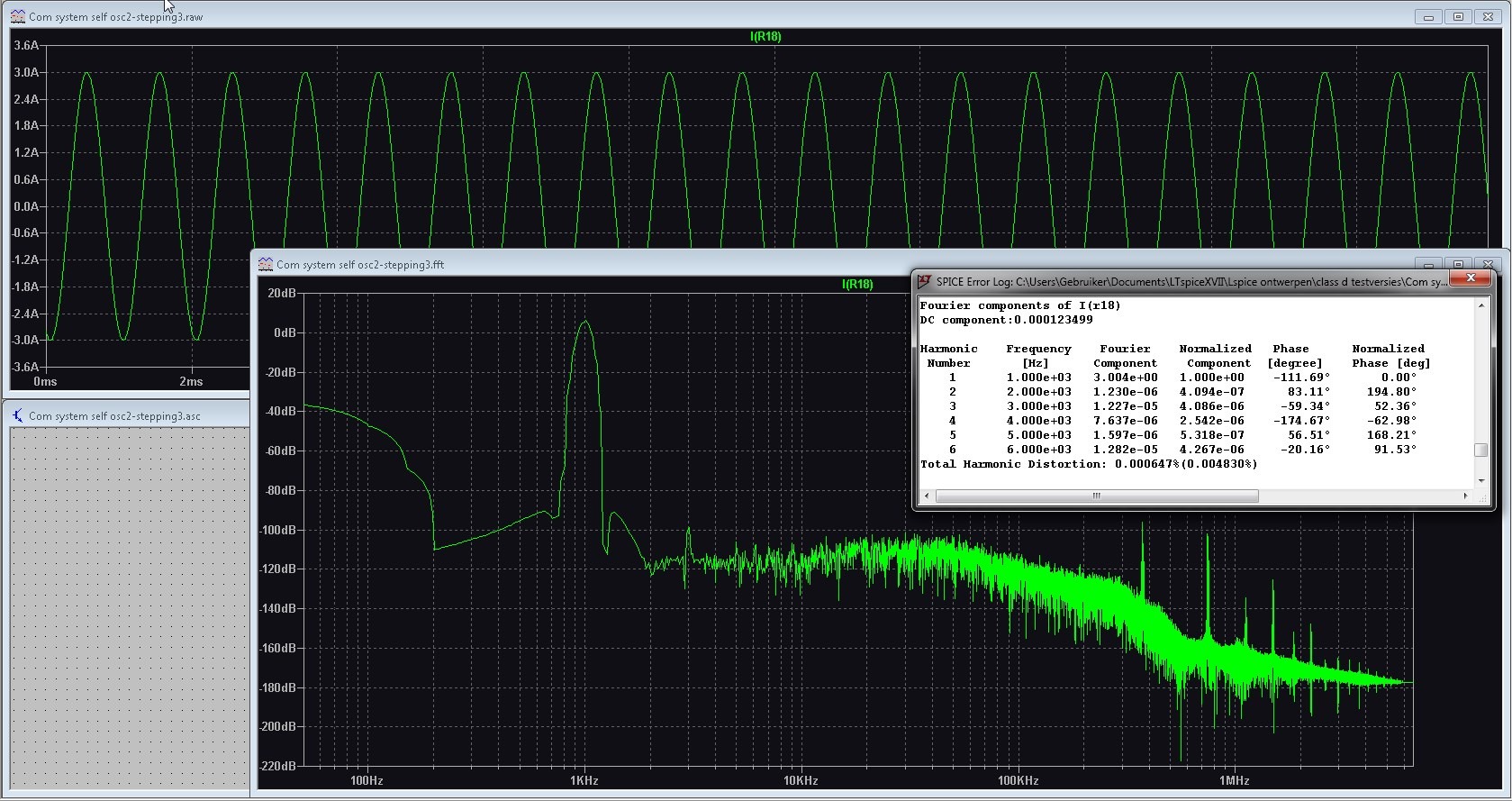

I want to start building a design, see the need for coils, I do use 24dB octave filter.
I do wind the two coils on one core so permeability needs to be enough.
Can someone advice me for this?.
thanks in advance.
