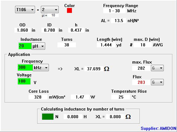

Have anyone tried with T106-2 (red colored iron powder core) ? It should be working fine.. just look at the attached example 300Khz @ 50-50v
My new experiment is an air core, used 8x30AWG wire bunch and 1 inch Diameter x 1 inch height. Only 42 turns to give 30uH.. Warm up like 40-50 or max 60 Celsius but no more even at working !
Can anybody tell me the calculation of wire gage of the output inductor (air core) for 600W amp under 2 ohms load and 50-50 voltage? Actually what i want to know is the current travel through the inductor then the gage can be calculated.. Just for experiments.. thanks in advance..

The exact calculation (for optimal solution) is extremely complicated. (Especially without the design aims, desired inductance, etc...) I can say only one thing for sure: litz wire is needed. Inductor current is definitely not enough for calculating anything.

A coil can have thermal and saturation limit. An air-core coil cannot saturate. The thermal limit can have steady-state, or time limited, but you didn't specify any duration, so only the steady-state current limit left. The coil have to handle as much current as there can be flow. It depends on the designer and the purpose of the amplifier. Vdd/Rl=25A must be enough in any cases, but it's OK to use a 10 A capable coil in most cases.
