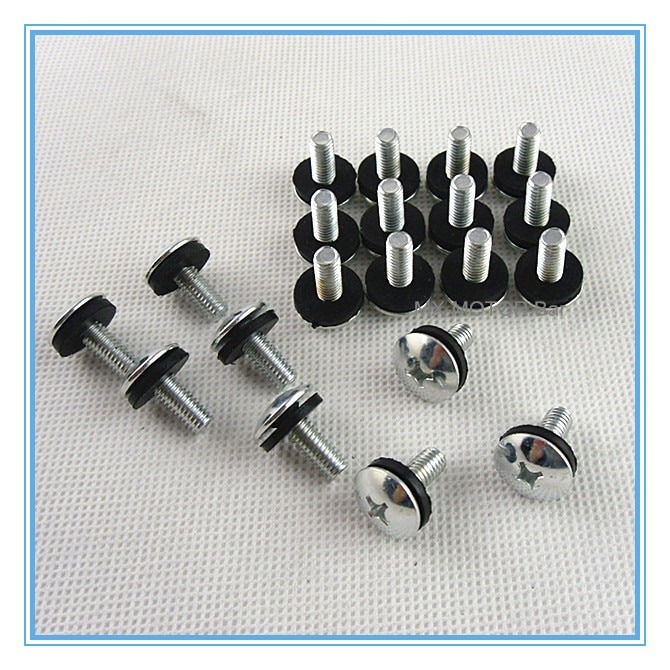

Possibly a few rubber washers between the screw head and plate. Like these.
