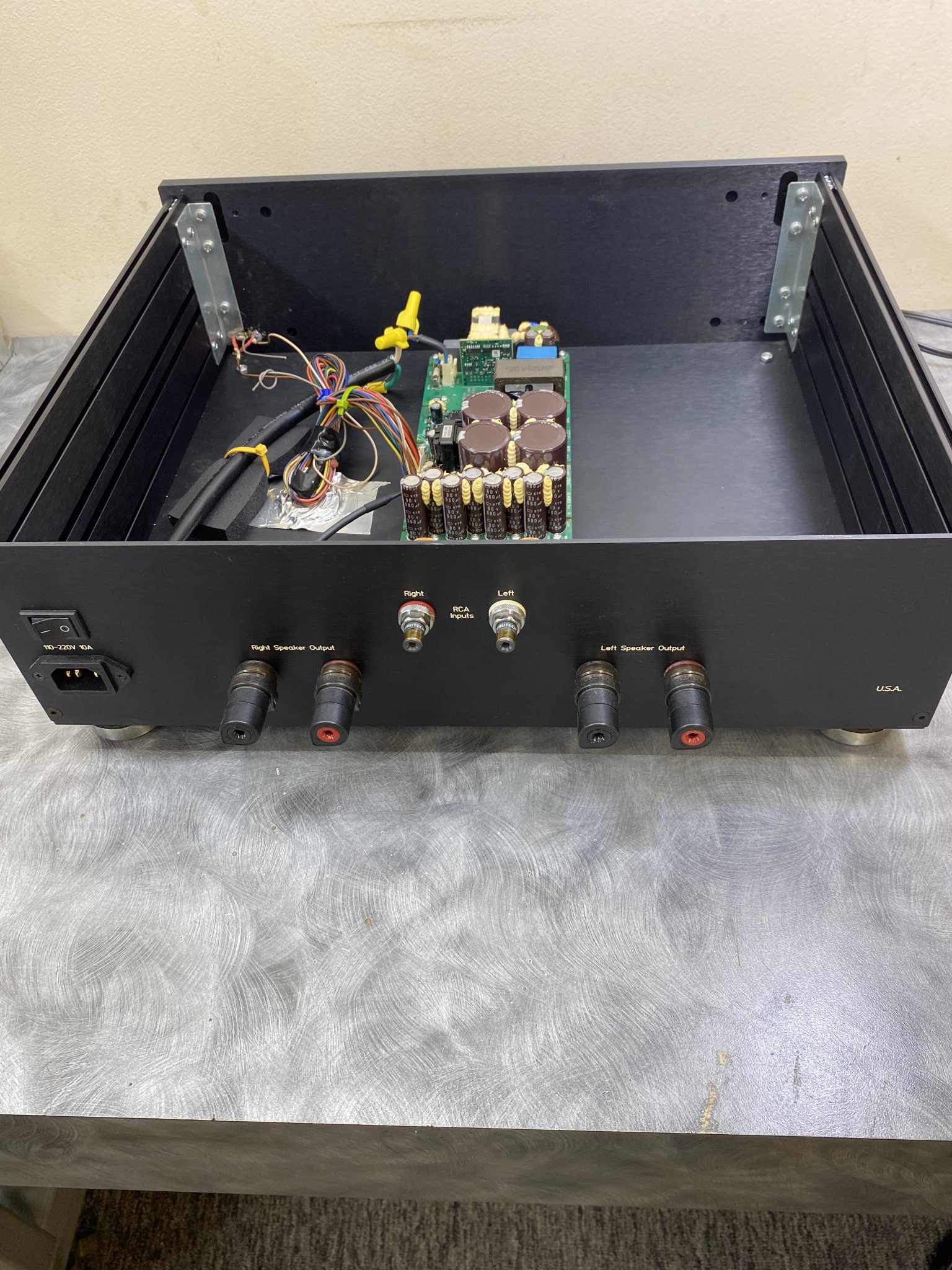

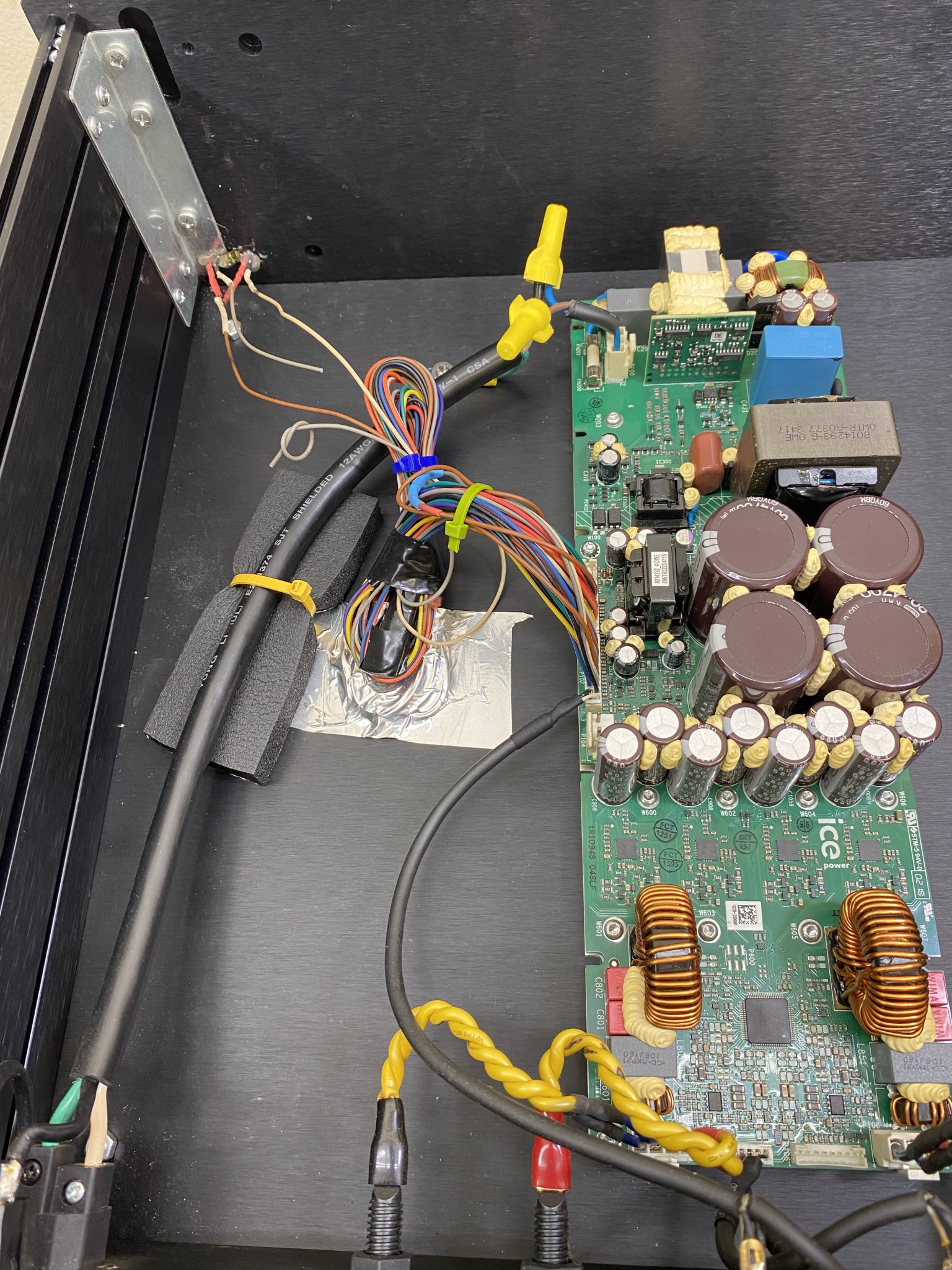

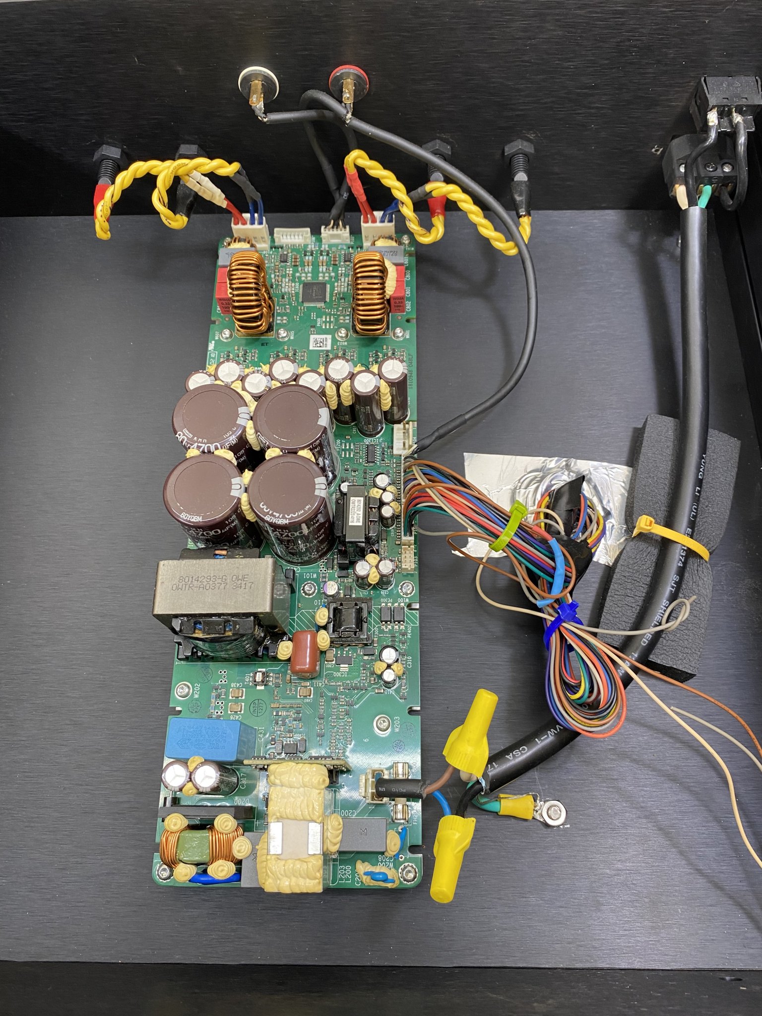

Hi there! I have attached some photos of what I built years ago. I had ordered an enclosure from a manufacturer in Italy. I was told that I'd have plenty enough heatsink for cooling the 1200as module as this aluminum enclosure I purchased would do the job well. Just my opinion, but the bottom of the enclosure has never even got over warm! I can tell you that my home electricity varies from 108VAC to 118VAC. So I purchased a variac to try and keep the proper voltage :(

You should have mounted the module on one of the sides instead of the bottom plate. The idle loss is 35 watts, which will require better cooling in my opinion. I have 2000AS2 modules, which have virtually the same idle loss. I found I had to use very large heat sinks on them.
Your problem has appeared over time, right? Could be that the module is faulty….
