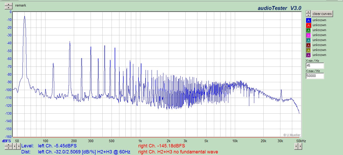

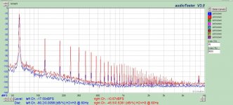

Hello:
First post in the Class D forum, and first DIY project with a Class D amp. I can give a bunch of information if needed, but I have a fairly straightforward question. Inputting a clean sine wave into a PowerPhysics A-404 board. Input shown in blue.
Output is 24V into a 8.7 ohm resistive load, shown in red. I should note that the output is actually stepped up through a transformer into a 200 ohm load, but the amp is seeing a nominal 8 ohm load. The FFT is taken directly at the Class D output, not on the output of the transformer.
Any reason why the distortion has gone up a factor of 50?
I don't have a good reason but have a few thoughts.
The magnetizing inductance of the transformer is adding a load in parallel with the resistive load reflected from the secondary. This will not be totally linear and will react with the output impedance to create distortion.
Does the distortion reduce linearly with level? There might be a threshold beyond which the distortion inceases rapidly with further increases in level which would indicate that that the tranformer is saturating.
The amplifier might be sensitive to the power supply ouput impedance.

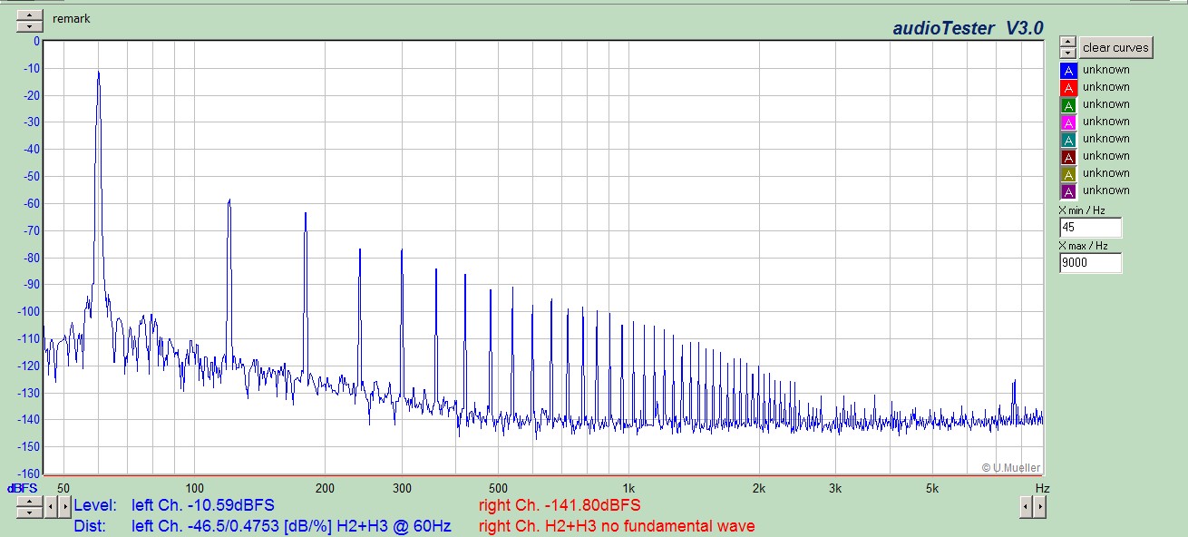

Transformer removed, pure 9 ohm load. Also added 2200uF on the 48V rail, which isn't much, but didn't make any difference.
Only need 36V for the H-bridge, so a 48V supply should be adequate.

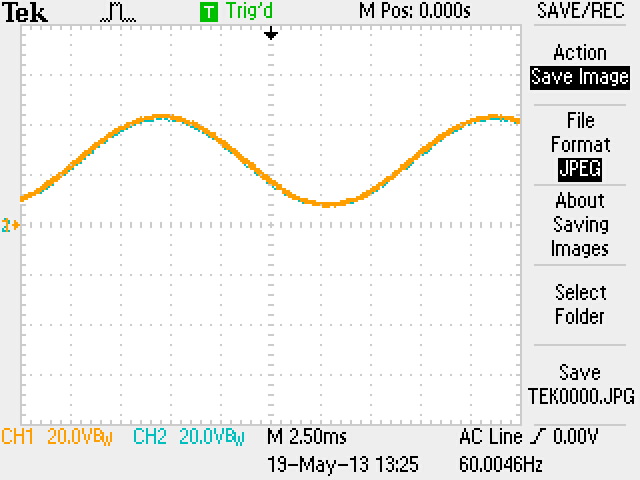

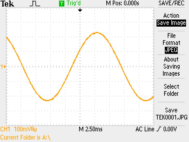

Attached a few pictures of the output; one is both output pins simultaneously. Looks reasonable; I would think the DC offset is normal due to PWM+filter action.
Second picture is output at split bobbin isolation signal transformer.
If this is not a filtering issue, it must just be a junk amplifier ?

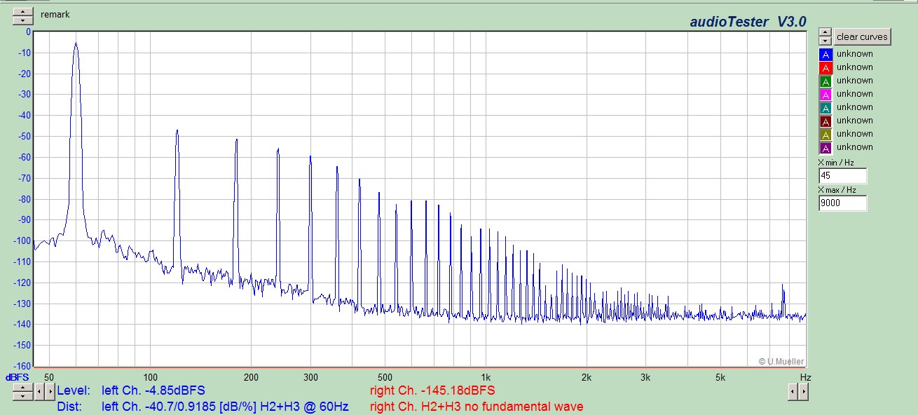

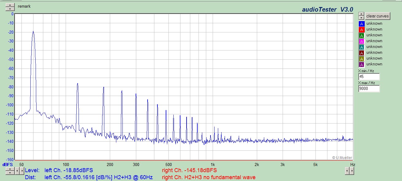

First, connected a resistive load to the amp and removed the step up xfmr, using the OPT for measurements. I didn't capture a shot of the FFT, but it was essentially identical to the source quality, around 0.01% give or take. So the amp is doing its job into a resistive load.
Then, I left the load as is, and just added the unloaded step up xfmr. The attached picture is the new result of the amp output. So clearly the amp does not like a nonlinear load. It is known that transformer excitation current consists of a great deal of 3rd harmonic, along with other odd harmonics in decreasing order. I was hoping keeping excitation would limit the current peaks, where the core gets closer to saturation, but definitely not enough. The amp does not prefer to push these nonlinear currents while maintaining a voltage sine wave.
Still thinking of how the even harmonics entered into the picture. Perhaps residual core flux?

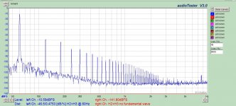

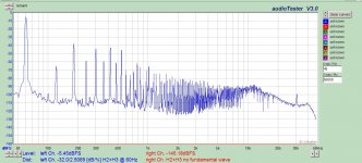

Next step was to reconnect load resistors to the output of the step up transformer, running around 65W. So this is measuring the 115V output. Knowing the distortion of the amp, I can now see the additional distortion of the transformer, which is significant. Not much more I can do about this unless some sense leads were available for the amp feedback.
