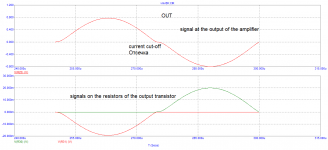

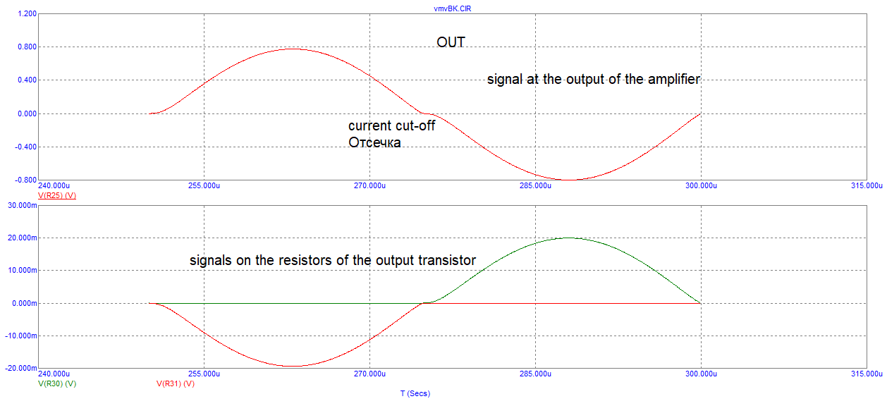

Yes, it seems that I showed you earlier the cut-off of the collector current of the Class B mode. Just on a very similar output stage on a parallel amplifier with a powerful diamond buffer.With a shunt and a regular one .I can show you if there is any doubt .It seems there are 2 suggestions; one suggested class AB, two suggested class B.

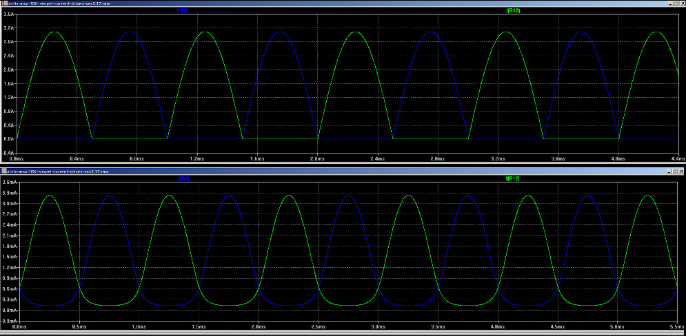

If the two simulations are seen at first glance, one could say: Clearly, the first plot is class-B and the second is class-AB. Ultimately, it's the same amplifier at different levels ...

On my more graphs, the VC works in class B mode with closed output transistors . However, this is only noticeable when modeling a single VC that is not covered by the OOS. a large loop gain eliminates the effect of too little quiescent current.Change in quiescent current from 0.2 ma to 5mA
And if we provide conditions for this ? It can.Larger open loop gain cannot possibly compensate for insufficient idle current. There is zero gain in the dead crossover region unless you close it with just enough idle current.
