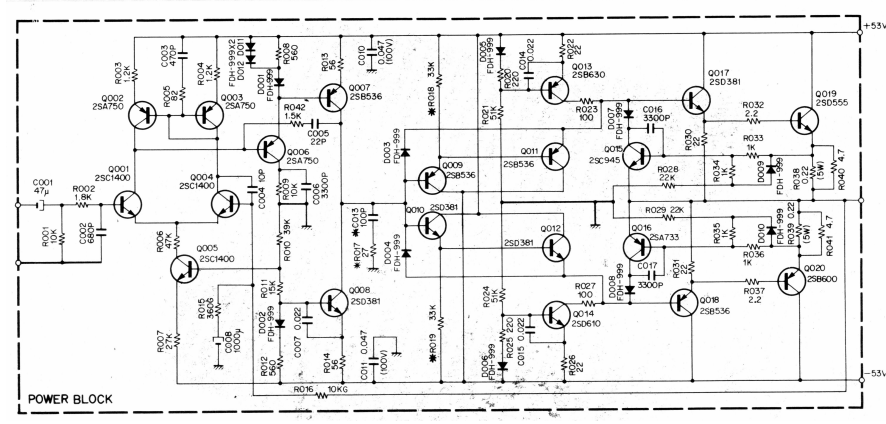

I have a question on the schematic attached. It's a Nakamichi 620 power amplifier. Could anybody help to clarify me whether it is a Class B amplifier? Is it interesting to clone? Also, could anybody suggest me some examples of commercial Class B amplifiers?
According the DS it is a current driven output stage with idle current of 20-30mA (Class-A region).

I see four emitter followers in succession in each branch of the push-pull output stage.According the DS it is a current driven output stage
So it is not a current driven output stage.yes, and ? pnp pnp npn npn ( upper half )

The output impedance of the VAS is not so high and the input impedance of the followers are not so low that we can speak of current driven.it is written in manufacturer's service manual, read, post #2, pages 4,5
I did not claim it is CD
imho, neither CD nor Class-B
I know what they were thinking, current-driven from VAS.
The output stage looks a bit like a "diamond" (NPN loaded by CCS + PNP) and (PNP loaded by a CCS + NPN) as introduced by Audio Research first solid state amplifiers, I think, but here with more devices.
For a bit less distortion, the emitter resistors of Q017 and Q018 should not be connected to the output rail.

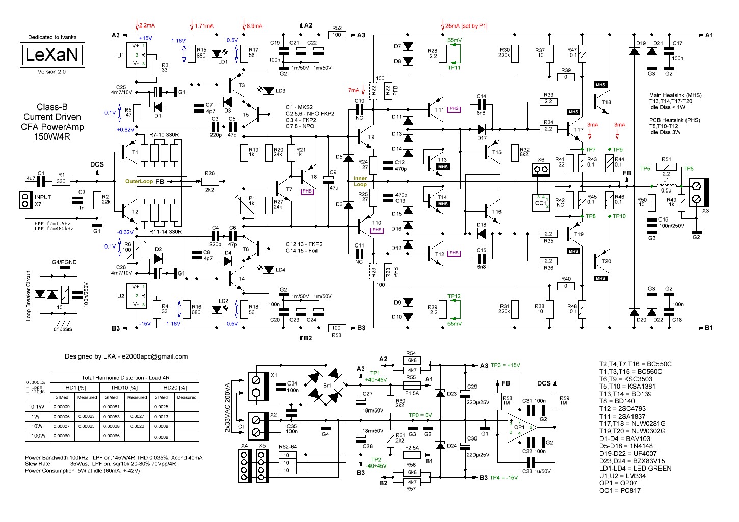

not commercial but my diy class-b, current driven outputs, distortion 0.00x, good harmonics profile
Low distortion current driven Class-B output stage
measurements
measurements
