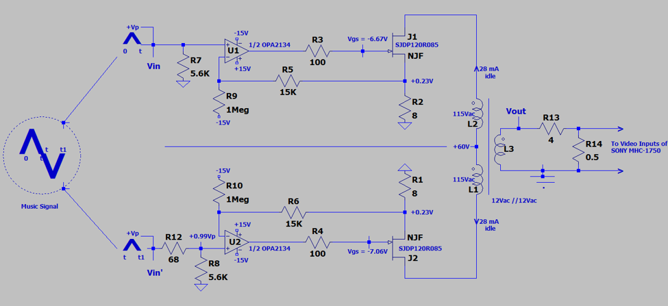

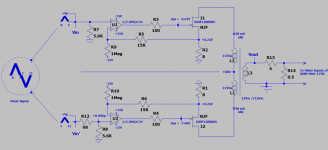

Please go to post #490 in the H2 Thread by Mr. Pass. It contains a Class aP amplifier schematic, and it also explains the subject of this post. Thanks.
The attached schematic in this post is for a Class aP amplifier prototype; which mimics a vacuum tube [VT] power amp. It is mostly configured like the one I have already shown in the H2 thread; but with an important modification. This schematic uses a pair of SemiSouth SJDP120R085 [R085] instead of a pair of NPNs.
Mr. Pass has given me this pair of R085s during my experimentation with his DEF innovative circuit. Thanks again Mr. Pass.
R085 is a Depletion N-JFET. It mimics a vacuum tube [VT] pentode; because it has electical characteristics which resemble those for a VT pentode, and bias voltages.
Please note the value of Vgs [~-7 V] for R085. This value is inside the useful bias minimum voltage of [-10 V] for the drive OpAmp [1/2 OPA2134]. This minimum bias voltage is also applicable to Vg-k [grid-cathode].
The power output at the secondary of the power output transformer [OPT] drives the inputs of SONY MHC-1750; instead of Threshold S/150. SONY is a utility and a low-wattage stereo power amp [~10W/ch]. It finally drives a pair of ADS L730 loudspeakers.
Sound of this VT mimic.
Sounds great, detailed, and laid back. It has a subjective sound which I found different and better than I described for its NPN clone in the H2 thread. Its sound quality is fully commensurate with the finding of Mr. Pass in his articles which are entitled "H2 Harmonic Generator". He attributed this unique sound to H2 [second harmonic] negative phase or H2np.
The above is a valuable step to understanding VT power amps.

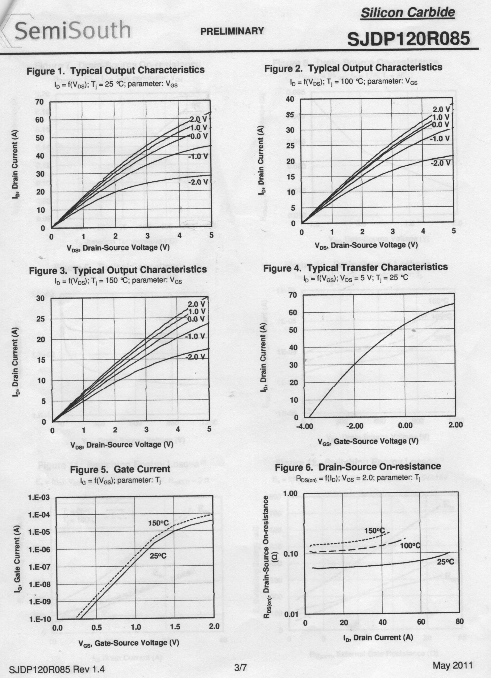

I have a spec. sheet for [R085] by SemiSouth. I scanned several pages of it which I'll post individually because each is a large JPEG, and each has different info.
The attached scan is the front page [Part1]. The relevant performance of [R085] to this amp is shown in the Features section:
1. Extremely Fast Switching.. Analog pulses are much slower [rise/fall times] than square ones. Thus [R085] will perform well.
2. Rds (on) = 0.075 Ohms; close to a dead short which is a very welcome spec to pump high current levels thru the load.
3. Voltage Controlled with a low Gate Charge and Capacitance. These properties will not slow down the action of analog pulses. No slewing!
The breakdown Drain-Source voltage for [R085] equal to [1500 V] is truly impressive. But this prototype amp will use a high current 5-15 V SMPS as its PSU. I am using a 15 V PSU with an aim to go to 5 V.
This front page has many more important nuggets. Part 2 will follow.

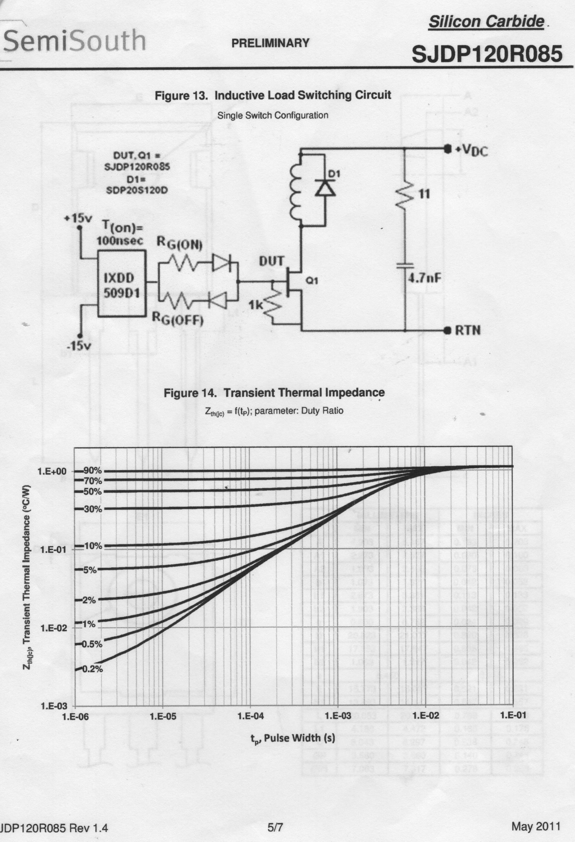

A current source amp using SJDP120R085 [R085]; Part 2
The left-side scan from the spec. sheet of [R085] shows a truly impressive current switching performance in each of Figures 1, 2 and 3. The prototype amp understudy aspires to get this performance; but..
Each Figure is a plot of drain current in Amps [Id =Y axis], versus Drain-Source Voltage [Vds; up to 5 V]; enabled by varying Gate-Source Voltage [Vgs]. Notable:
1. Special test equipment was used to generate these graphs. I am using a scope, pre-matching resistors and assessing its music's subjective performance.
2. The pulse width of the input signals which enable [e.g. 0 to 60 Amps!] is in nanoseconds. Used for proper operation and to safeguard [R085] from stepping outside its SOA and/or its peak junction temperature [Tj].
2a. The attached right-side scan shows Figure 14 which addresses thermal performance. Junction temperature; [Tj] per unit W generated therein is strongly affected by the pulse width of the switching input signal. Analog pulses have long pulse widths; between ~ [1. E-04 to 1.E-01] seconds. They are pulse-width and pulse-height modulated. They'll comparatively run [R085] a bit hot.
The above will help me make a respectable power amp. Its schematic will follow.
Best
Anton

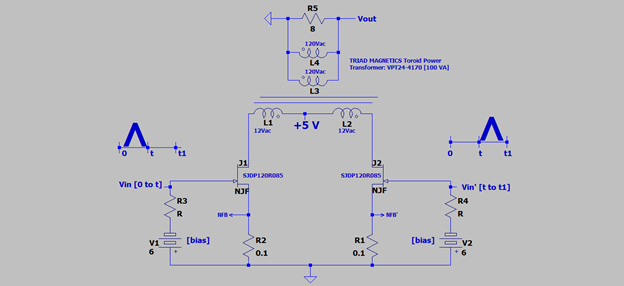

A simplified schematic of the current source amp using [R085]
Dr. Michael Mazzola [Semisouthfan] is a co-inventor of [R085]. Post #521 in the thread SemiSouth boiler room shows a picture of an [R085] device he crafted. It is a plug-in equivalent for 6L6 vacuum tube for use in the power output stage of a certain Fender amp. Its status is unknown to me.
I experimented with Dr. Mazzola's approach. It works. By example, please see post #245 in this thread which shows a typical circuit; albeit with a + 60 V [plate] or drain volatge.
The attached simplified schematic is for the bench prototype. Please note the following which are different from the above:
1. Drain-Source voltage = 5 V; like in the spec. sheet of [R085]. I am using a regulated and linear 5V/2A PSU.
2. The windings of the output toroid power transformer are connected in reverse to that I practiced in post #245; meaning:
2a. The two low impedance Secondary windings [12 Vac] connect to the drains of [R085]. Power output [Vo] is taken across the primary windings which are connected in parallel.
2b. This approach enables [R085] to push a high level of drain current thru the [12 Vac] windings. As suggested in the spec. sheet.
3. Analog pulse signals are half-wave precision rectified music signals. They are 50% duty. By example; a 30 Hz. music cycle has a 33.3 milliseconds duration [0 to t1]. Each [R085] is ON for 16.7 milliseconds during its switching turn.
4. The source degeneration resistors [0.1 Ohm] are matched.

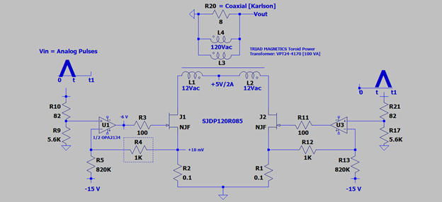

Current Source Amp using [R085]
The attached is a detailed schematic of the prototype amp.
Post #200 in this thread shows the schematic and build of the precision rectifier generator; which provides analog pulses [Vin and Vin'] to the shown output stage.
Please note the following:
1. The two [R085s] need to idle equal source currents. I show a calculated [+18 mV] across the/each 0.1 Ohm source resistor. This biaing voltage is generated by using this equation: [15 V/820 K] X 1K. The 1 K resistor which is highlighted with a rectangle [or the other mirror] is minutely adjusted [+/-] to make the bias [source] voltages as close in value as possible; granted the source resistors are equal. Thus each [R085] idles at 1 W from [0.18 mV/0.1 Ohm] X 5 V.
2. This prototype has the propensity to generate +/-H2. This is a consequence of unequal [Vin, Vin'] and/or an inherent [unknown] system asymmetry. I reverse the loudspeaker leads periodically to assess the resulting H2. Both loudspeaker connections give a fully satisfactory and pleasing music.
3. In use, the output of the OpAmp moves the Gate Voltage of [R085] from [-6 V at idle] to more positive values; towards 0 V.
I was surprised this amp sounds great driving a hand-me-down 50 year old Karlson; which has a coaxial driver.
