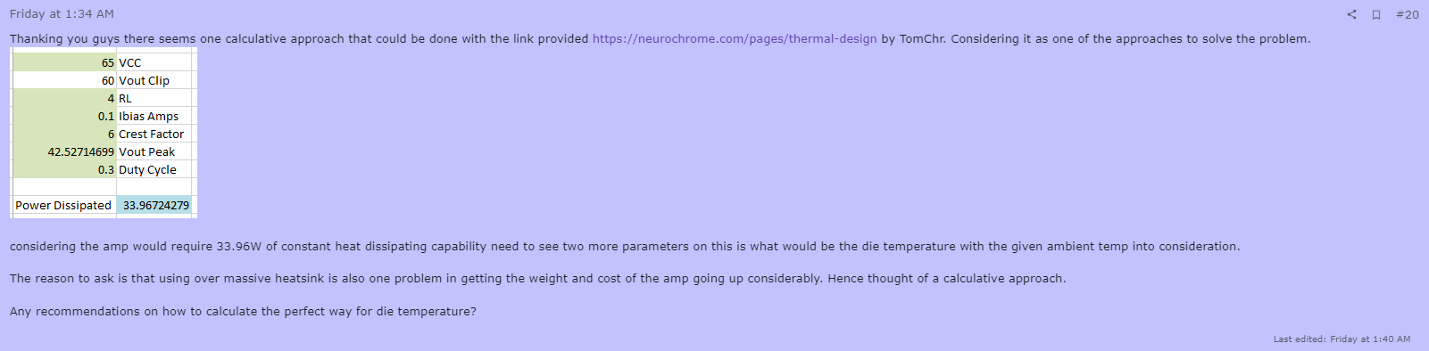

Alright now here we are cornering well.
As per that requirement of 33.96 W of dissipation and if the heatsink with 15°C/50W=0,3°C/W (or K/W) and heatsink capability is about 40W then this should be a good heatsink for the above requirement?

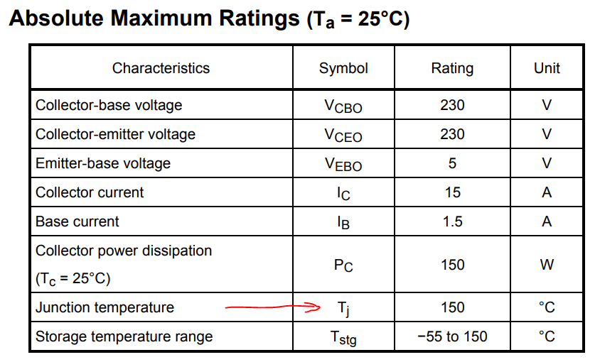

Now consider we have 3 pairs of 2sc5200 and 2sa1943 in the output stage.
The max junction temp of the die is about 150 deg C.
Now the dissipation of the each transistor consider for 200W into 8 ohm so how does math goes in here to have safer operation.
Now as per the above case the heatsink temp raise to 50deg C. So now in the same above case how do we know what is the junction temp?

To recap: you have to decide what parameters you want to base your heatsink on. Is it going to be "music power", with (perhaps) 10:1 peak to mean power ratio; is it going to allow for a reactive load and if so what value; is it going to be rated for maximum (inefficiency) of a Class AB amplifier (which has peak dissipation at around 40% rms output); a worst case signal (square wave half supply voltage output) or something else?
Is this an amplifier you would want for yourself or to make/sell?
If sell, it had better be able to withstand (say) 40% full power for at least an hour without overheating. If for yourself, then are you always going to be able to keep the volume low enough or music power to the design limits you may have set?
Will you have overtemperature cut-outs for a small heatsink? Or a peak detector for example?
As many have posted earlier, it really is up to you to make the decision. Then build and evaluate to see whether your decisions were right.
Another point to bear in mind is that really there is no "overspec'd" heatsink. Transistors will fail after some thousands of thermal cycles and the cooler you run them the longer they will last. If you do have a large heatsink your amplifier should last longer. Many high reliability computer systems were said to limit the junction temperatures of the chips to 55C. I don't know if that rule is generally applied these days. That would need a large heatsink for an amplifier of significant power.
To answer your question which overlapped with my post the junction temperature is dependent on the thermal resistance of the transistor and any insulator you use to insulate it. For the C5200 it's 0.83K/W and your insulator might be 0.4K/W (some new silicone insulators might be as low as 0.2K/W).
If your 8 ohms is a pure resistive load and the power 200W (rms I assume) then taking the worst case output (say 40%) the dissipation with sinewaves is going to be around 80W. This power is dissipated between all of your output transistors i.e. 13.33W each. That means the junction temperature would be 13.33x1.23 or approx 16.5C above the heatsink. Your heatsink has to dissipate full whack 80W. If you let Tj=150C that means the heatsink must be 150-16.5=133.5C (hot enough to cook your egg, not, I think, to be recommended) so needs to be (if we say 30C room temperature (outside on a hot sunny day perhaps) the total temperature change is 133.5-30=103.5C. The thermal resistance should therefore be 103.5/80 or 1.3K/W.
However, that does not allow for any margin or different operating conditions. You may - or even should - consider a heatsink temperature much lower. Your 50C would be OK but means having a thermal resistance of 50/80=0.625K/W. This calculation excludes the quiescent current dissipation which can be added on. It excludes reactive loads, lower loads, etc etc as mentioned in my earlier post. The actual temperature still needs room temperature added.
With 200W output what is more of a concern is the second breakdown rating of the transistors. Once above the breakpoint you may need more devices in parallel. That is, in particular, a point to consider when contemplating a reactive load.
What is never mentioned with a reactive load (as far as I have seen; Self or Cordell may have) is the frequency of your assumed reactive load. Since reactive loads apply at some frequency, you can moderate the SOA with a considered repetition rate which helps. I've not seen that commented on.
(The 40% is not the theoretical peak dissipation of a Class AB - that's nearer 30%, but with quiescent current it could easily be as high as 50%).
