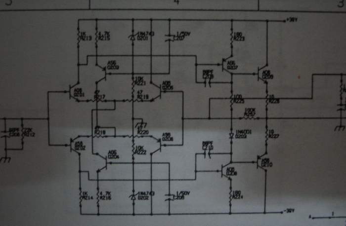

Hi, Jacco,
Have you been to Indonesia?😀
It's the amplifier of VL-200. I see this design stressout on final stages. This amp is robust. The front stage is 3 stages, but after that feed another bias stage and final stage (5 stages all?). The bias/VBE multiplier is unique, reminds me of Lars Clausen's ZETA.
Here's the front stage :

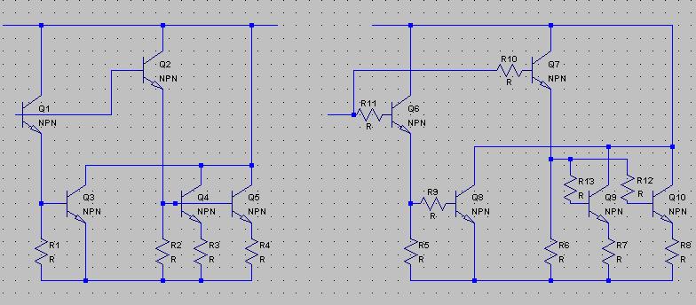

Hi Graham,
when reading your last post it comes to my mind when you talk about problems with instability, if we take your schematic at least how it looks like in post #21, when I study it, it has a complex formation around output transistors working in class A, AB, B.
Maybe the instability is not about C-dom and such stabilisation things but rather strange instability between these output transistors, they all switch in at diffrent levels of load and it is perhaps so that some transistor initiate others to switch on and off and the instability get's loose.
The PCB layout can also be very critical around this special output stage.
I try to attach a picture, the left is a copy of your schematic, and the right is where small base stoppers is added to each output transistor.
EDIT: Maybe you could try to remove the class B stage and it's driver and see(listen) if you still get the performance you wanted?
What do you think?
Regards Michael

Hi Michael.
I can stop the intstability, but living with the sound shows that what I took for impressive attack is actually something unusual.
It is as if the output stage over-compensates for dynamic loading, and what I call the 'punchiness'.
It is unusual, and the exact opposite to the weakness of current drive notable on both mid range and bass at frequencies where I know that driver impedances are low.
The JLH class-A is for current drive, and both upper plus lower driver currents when added can exceed the current flowing through the upper biasing resistors, especially when there is a single input transistor.
I believe that my AABB output stage will need a fixed total drive current to work properly at higher voltages.
When tacked on to my 25W class-A it really was fine. That had 390 ohm collector/emitter drive resistors; to go higher power would have meant a more powerful driver transistor, and again this is a direction I do not want to take.

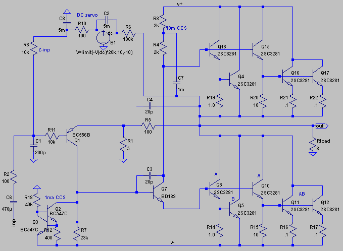

I've been playing around with this JLH topology wrt Grahams AABB outputs, and I got interesting result.
Simulation of Graham circuit was unstable in my sim, I guess that this is because of too high gain in the diff stage with accompaning delays and phase shifts. I decided to make it as simple as possible, and went to JLH single input BJT.
Had to remove output offset. Typically this is done by pot biasing input BJT for zero output offset.
I tried different "pot" settings to remove the offset from output. What I observed is that as I approached zero offset, the amp tends to become increasingly unstable. My guess is: As the input BJT needs some bias current to stay active, it must draw some current from the output, there is no other place. JLH output stage is purely current balance, meaning that when offset is exactly zero, there is no current left to bias that input BJT, and it shuts closed. This causes splitter to close and positive outputs to increase current, which in turn opens input BJT again, etc. When there is lag through the amp as is increasingly probable with very low biasing current, oscillations around zero error seem logical. So it seems that this type of zero offset setting has some inherent flaw. It didn't exactly oscillate, but instead had increased output noise. Probably amps output impedance rises as the error voltage approaches zero.
I decided to get away with the cap to ground in the feedback loop and the DC zeroing pot and use DC servo as virtual pot instead. Makes it so much simpler in sims anyway. Just for simplicity of setting input BJT biasing current I added 1ma CCS to negative rail from input BJT collector instead of resistor. Given that this current has to flow from NFB grounded resistor, it causes some DC offset on it, few mV for Kohm NFB resistors, and that also draws from output. But it does not depend on output error voltage this way, and thus has no effect on output impedance when error voltage approaches zero.
Things got interesting for me when I noticed that resistor from the splitter emitter to rail increases THD. I realise that this output stage base pulldown resistor must increase the slew rate of the amp, and somewhat compensate for splitter base current, but in reality it modulates the output stage idle bias current so that during positive going wave it draws more from bootstrap or idle CCS than during negative going wave. This causes asymmetry with large signal and corresponding THD increase. I tried replacing it with ideal CCS, but it does not show any notable improvement. Instead, I found that best result is achieved when that pulldown resistor is simply omitted. That doesn't feel right, although classical darlington works like this. I wonder what bad will happen without one?

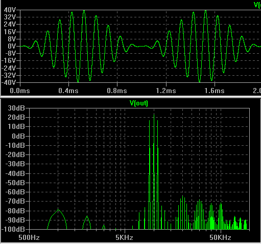

Attached is a circuit I got, using JLH topology with Graham's class-AABB output stage. It has 80W idle with 1Amp idle current, and in simulations with models I have and parasitics included gives 0.001% THD into 8ohm resistive load at 27W, and 0.005% THD into same load at 196W (swing to 2V within rails). IMD below -100db. very effective back-EMF handling. I tried with speakerload model. It seems to very effectively damp backEMF by feeding error current back directly through splitter and also input BJT.
Dunno if there is anything new in this circuit. NFB grounding R1 is used also to bias input BJT Q1. For that CCS of 1ma in Q1 collector is used. This CCS biases the Q1 and also removes the bias current before splitter. Thus splitter gets basically only amplified input AC current with NFB error current subtracted, plus bias set by DC-servo based on output offset. Interesting is the R7 in parallel with CCS. Its value has been found by picking. There is a specific value of it when THD is lowest. I'm not sure why. Emitter resistor of splitter is removed. Anything there and THD goes up.
R1 and NFB values are very low. There can be 15W burned on the NFB R7, but low ohms of R1 is good.
Interestingly, boostrap gives better THD results in sim than ideal CCS of equal current in this circuit. Strange. I wonder if the voltage drop on the boostrap resistor is somewhat compensating nonlinearity of splitter bjt.
Interesting is that removing class-B stage from the mix actually increases THD which was for me unexpected. It seems to reduce output impedance for good, in a weird manner, by starving opposite legs base current through splitter by showing reduced impedance to bootstrap ccs.
I'd like to hear your reasoning on why low impedance NFB network has positive impact on THD, is the splitter without emitter resistor viable solution, and what is the real reason why 1m CCS shunt resistor needs be picked and is the bootstrap really prefered CCS as sim seems to suggest? I have my "theory" on these matters, but I'd rather listen to those who know better. I think it has to do with how currents circulate from output back to splitter and how much of error signal is lost.
When I stepped NFB ground resistor as 10, 100, 1k, keeping FB resistor 20x larger, I observed that propagation delay increases with impedance. Thus low NFB impedance looking into input BJT emitter seems prefered. It also reduces over-compensation, which seems to be simply late compensation. This low impedance NFB benefits both, with grounded capacitor and without. I've not seen it done this way.

Hi Wimms,
I'm reet chuffed that my AABB output arrangement is not being ignored.
I believe my mistake to date has been applying current drive instead of voltage drive in my attempt to use the low distortion JLH output arrangement.
In an output stage the stage gain falls as the voltage across the conducting half falls with increasing amplitude; this is not the same as simplistic device gain as viewed from specification sheets. The additional class-B device 'compensates' for the fall in gain with increased current demands at high amplitude. The 2x class-ABs do most of the work, leaving the class-As running linearly without ever going off (if properly biased) whereupon they can maintain linearity through the two different time/voltage AB and B conductions.
Suggestion;- add another transistor to the CCS so that you double up on Q2, and use this to sink some standing current through the BD139.
Also see (attached) the four transistor circuit I recently posted in the 10W JLH class-A column for an input biasing arrangement that has proved convenient in real life, even with this output stage too.
Adding the driver emitter resistor is increasing distortion because your bootstrapped collector resistors have equal value. The upper one is better being much lower in the JLH output stage.
Lower resistance at the input transistor emitter reduces thd by increasing the ratio between emitter resistance and R7/Q7 resistance/impedance; ie. increasing stage gain.
The FFT is not bad considering how badly balanced your investigative circuit is.
And the big question; are you adventurous enough to try it in real life ?
