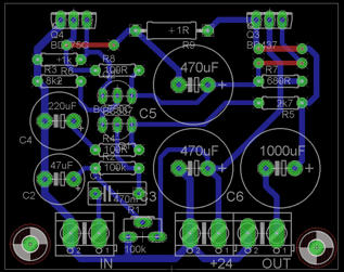

I've built an amp based on the circuit here:
7 Watt Class-A Audio Amplifier - RED - Page177
Here is my layout:
Front:
https://dl.dropboxusercontent.com/s/i62d4v2bq21m7ec/2016-04-24%2014.44.32.jpg
Back:
https://dl.dropboxusercontent.com/s/hc8awal8ca04f7a/2016-04-24%2014.45.28.jpg
I'm powering it with a bench power supply, set to 24V and 1A. As described in the article, I've connected the pot and turned it fully anti-clockwise, I then tried turning the trimmers to set the voltage at C6 to 12V however the bench power supply starts switching when I approach this value with the full 1A being drawn. No matter what current limit is set (up to 2A) all of it is sunk.
I've repeatedly checked the component values and the routing and have found no error.
This layout apparently works, its taken from a Philippine forum which has been deleted in the last couple of days:
However from my analysis I've found that this layout should not work as the emitter and collector of Q1 (BC560C) are the wrong way round.
Is my problem caused my using a bench power supply?
Or is there an error in how I translated the schematic into the layout in the top image?

You need more than 1 amp PSU to test a class A. Try adding 10ohm power resistors in series with power supply input leads and measure voltage drop across them to estimate current needs. Those resistors also limit max current in circuit in case you have an error and will let you check where it may not be working. The initial pot position may be sensitive and you also don't have a temperature compensation on outputs. That may be allowing it to runaway to full on state. If you had a full high amperage PSU you probably would have smoked a component upon turn on. Always use 10ohm safety resistors when turning on or debugging circuit first time.
Your issue is most likely due to oscillation.There is no frequency compensation in this circuit. Add a capacitor between collector and base of q2, starting at 100pF and experimenting until it stabilizes the current draw.

Hi Unkle77 The pin basing of the BDxxx are the same ECB. Your drawing shows that you reversed the BD437. Is this layout what you really have? You may wish to recheck your layout.
Duke
Duke
Hi Audio1Man, with the layout I had planned I go a bit confused and thought I could have all the transistors in ECB order, turns out two transistors needed to be flipped, so now their E and B pins are crossed in order for all heatsink pads to be on the same side.

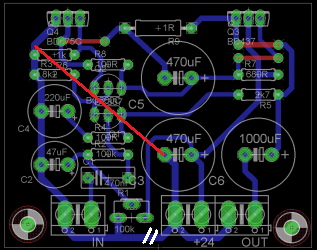

Hi Ketje, thanks for looking at that PCB layout however I'm using prototype boards so my layout follows the drawing in my first image. Is the aim of your modification to bring the 470u closer to the BD675 or to reduce the path to GND?

To220, To247 and To264 are all bce
To126 are all ecb. I have never found any exceptions among lots of BJT transistors.
2sa/sc To92 are also bce, again I have not seen any exceptions.
Yes, the mistake is in the circuit layout rather than the package pin out

To me the key thing is to play around with:
-the 100R resistor at BC560 collector to reduce the gain.
-the 680R which I believe sets the current through the BD437
