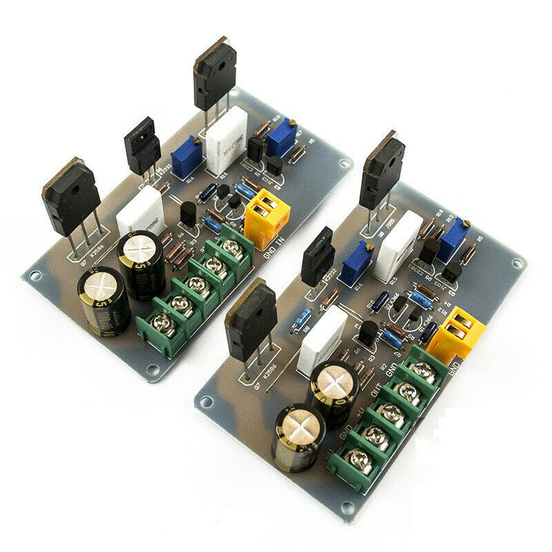

I'm very tempted to build this amp, although I don't really have a use for it (it's not going to do what I was originally thinking of).

It quotes perfectly acceptable distortion at 10w. Hmmm. Does that mean that, realistically, it's a 10w amp? 30 is tight, 10 is a non starter.
Let’s get back to the original post and see what that amplifier board really is? … in the first place.
From the list of transistors we may conclude that this is a two channel 8-Pack of FAKE transistors. All these transistors were discontinued a long time ago. By the way, if you want to purchase fake transistors you may just go to ebay or aliexpress. Falseness is guaranteed, in three main flavors: »matched pairs«, “unanseble pack” and »finished boards«. That’s your choice.
Therefore, it is impossible to claim this is a Class A amplifier board. Just Class-A arrangement of components means nothing – the quality of ALL components along with original quality components is just a starting point. Final adjustments and measurements of parameters is a guarantee that you will hear the sound of the A-Class Amplifier, provided that you connect the board to quality speakers.
This seller belongs to more »honest« group because he doesn’t claim Hi-End quality he and doesn’t provide fake THD measurements indicating super, but not attainable measurement results. He claims “just” 0.001% THD. Congratulations. Some guys over there at Aliexpress show measurements of almost zero THD with a dozen of leading zeros. Believe.
I have seen that dishonest »designer« around here who successfully persuades naive buyers that he and only he is the source of »blameless amplifiers«, and that the others sell fakes of his own design.
Beware of the FAKES.

#1 1 pair × Assembled power amplifier board (China)

But look at the snapshot below and observe a pile of FAKE transistors soldered on the board! A long time discontinued transistors on the new board.

Chinese manufacturers offer replacement clones when repairing obsolete products and for DIY.
How much they correspond to the specifications of the originals, you have to find out from personal experience when using. Is there any other choice in terms of price / quality ratio?
TO-92 transistors are not bad :)
