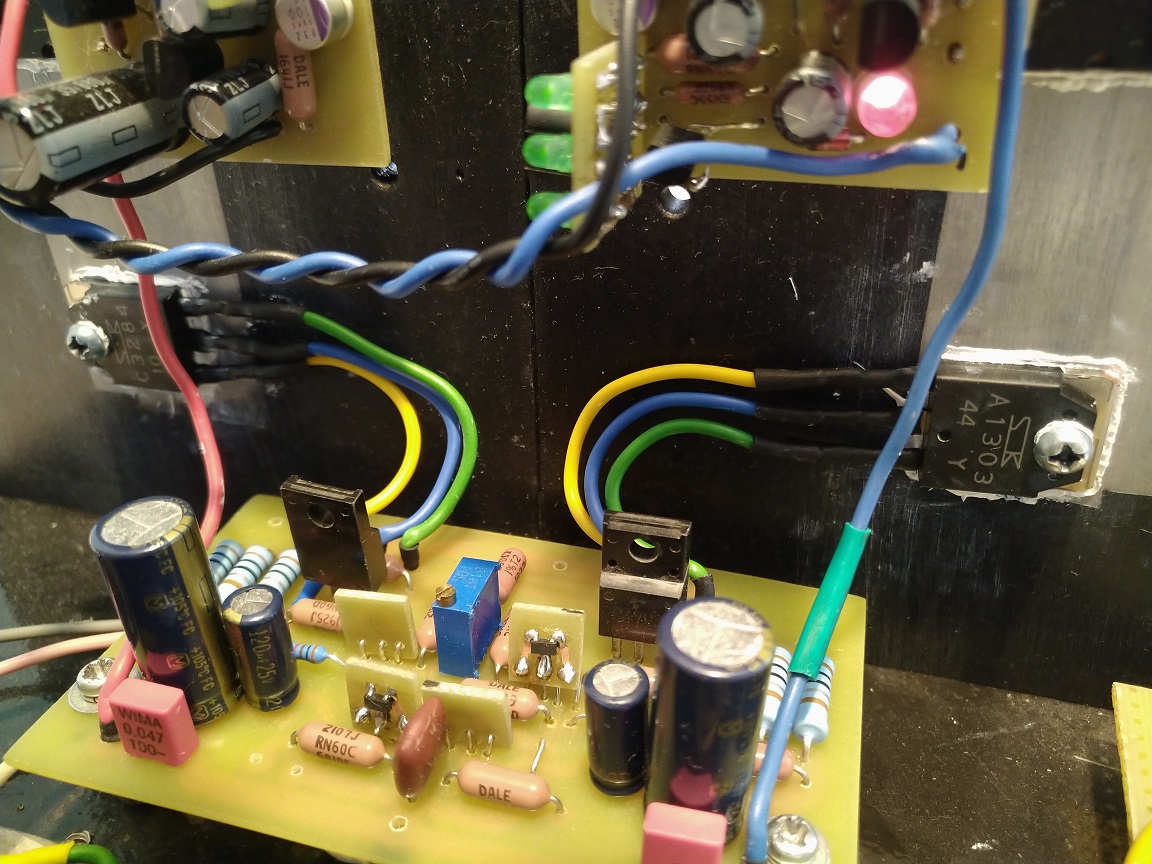

You can make a Hiraga 30W a class, it's a great amplifier, I have a 20W version and I'm very satisfied.
