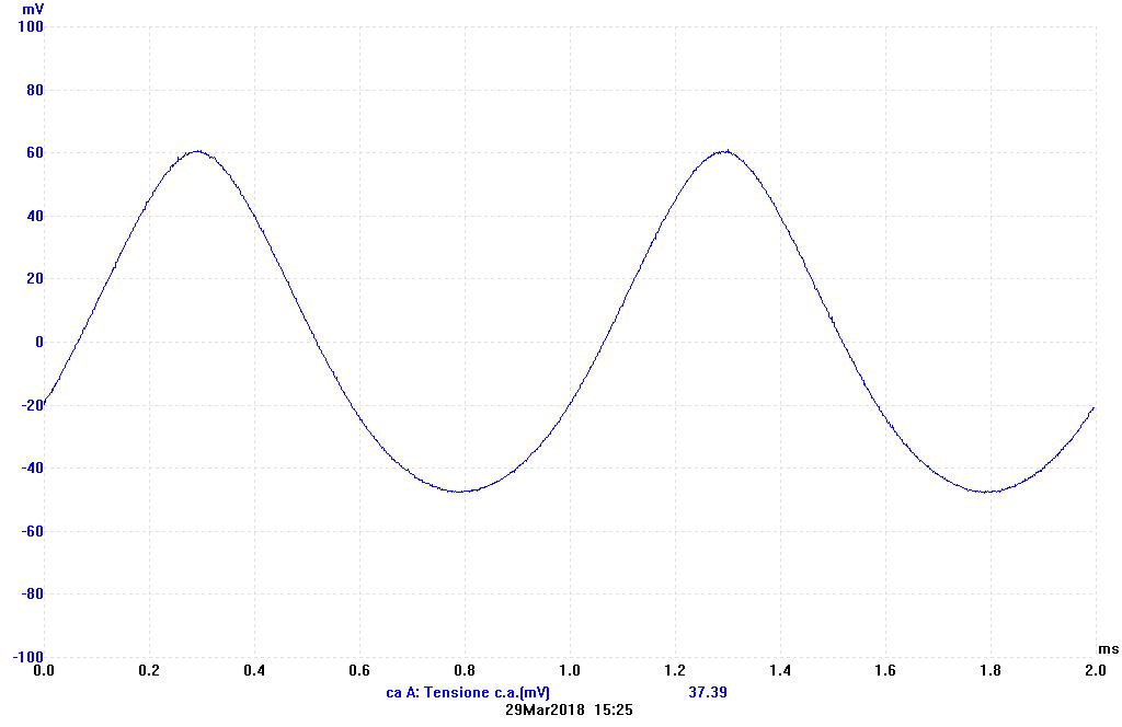

If you wish to be sure of Class A, install current sense resistors in the cathode and scope those. IFF the voltage never hits zero, you are indeed Class A.
Douglas
With a 1 ohm resistor on each cathode to ground and a scope you can see the class A and when it switch to class AB
With class A the wave is 360° full, like the attach. The bottom wave is reaching class AB
When it switches to AB one end of each tube became flat
