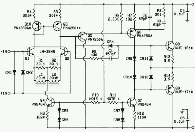

Workhorse said:Hi everyone,
Has anybody came across Class-A opamps?.
Do they really exist.
Does there is a way in which a regular class-AB opamp could be converted to Class-A opamp.
waiting for replies.......
Kanwar🙂 😉

If you want to find TRUE Class A OP-amps, you have to go for discrete.
Like this one by Graham Maynard:
Hi-Fi Preamplifier by Graham Maynard

There are many modern op amps that operate enough standing output stage current that they will operate Class A into av high Z load - so they can be lightly loaded with a discrete buffer stage.
Class A may be a goal in itself in low power and preamps but in power amps it's generally a wasteful fallback position.
Greg
Greg

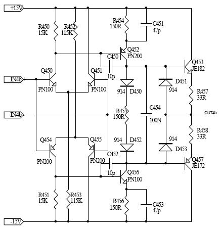

lineup said:This is a
TRUE Class A operational amplifier
It is designed and commercially used

Similar to the line stage of a Hafler DH101/110, except Hafler doesn't include the complimentary EF output stage which really improves output drive. BTW the EF is class AB.
I wonder, what is the purpose of the 47p capacitors? the time constant with the 150R is 7ns.
nuvistor said:I wonder, what is the purpose of the 47p capacitors? the time constant with the 150R is 7ns.
Those caps.
I have not seen this before in an amplifier, not that I recall.
Higher value caps, yes. But not so small.
Must be some compensation.
Reduce noise in those resistors used?
Those caps are a mystery.
But here I found another high quality discrete OP-Amp
using same small value cap, in addition to another high freq filter.
I am sure it is some compensation.
Compensation caps are generally in size of pF.
The purpose is to increase the open-loop gain at high frequences, my guess.nuvistor said:I wonder, what is the purpose of the 47p capacitors? the time constant with the 150R is 7ns.
leach calls it lead compensation, as opposed to lag compensation(miller) he used it in the super leach when it first came out in the AUDIO magazine in 1980. then it was dropped in the later versions.
