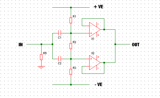

The idea was to have one opamp with +ve offset and the other to have equal but opposite - ve offset (Im not sure if this is the correct way to do this) so current flows between the two opamps forcing them in to class A
Gain is easy, just add resistors
Capacitors could dubble as input caps which are a nessercery evil anyway, thats if you think capacitors are bad in the first place
Anyway just some brian food 😀
possibly missing some form of current sharing resistance? as it stands thats probably going to make real opamps very unhappy!
theChris said:possibly missing some form of current sharing resistance? as it stands thats probably going to make real opamps very unhappy!
The idea is to have current flowing between the opamps on purpose so current sharing resistors may not be nessercery?
My thinking is comming from over biossed AB amps where one transistor is sorcing current and the other is sinking current at the same time
In this case opamps take the place of the transistors and having the bois at the input each opamp would force class A all the way though (again just a thought) 😕

I see what you're trying to do. The problem is most OPamps have poorer PSRR on the miller comp side - or one side anyway and better NPN side stability so the tendency is to favour the upper half and load it down to the negative rail. Even better to the unreg negative supply!
Having said that the best way is with a distortion meter and residual showing for each different one. That's the way to optimise.

Maby the scamatic I posted would be better for those who want to play with class A power opamps like LMxxxx ect.
It (class A) would add to the majic 😉

the op-amps are forcing different voltages on their outputs so they are kind of 'shorted'. You will have very little control on quesient currents.

AB outputs are "class A" for sufficiently high impedance loads, most monlithic op amps skimp on outputstage bias current, usually a lot less than 1 mA - but when used with a high Zinput buffer/output amp in the loop they will be operating in class A
