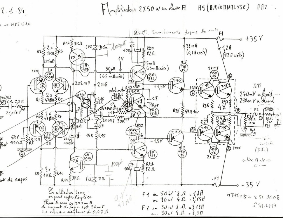

Anyway, my point
Jan Darth,
a lot of the Class A classics were more like high bias level Class AB, so there's not even a need to raise the voltage. :clown:
Example is the AudioAnalyse A9, or Duson A9 after AA went belly-up.
Claimed to have been All Class A but in reality Class A up to 25W continuous and 65W in AB.
(i'm sure you'd look smashing in a black robe)
