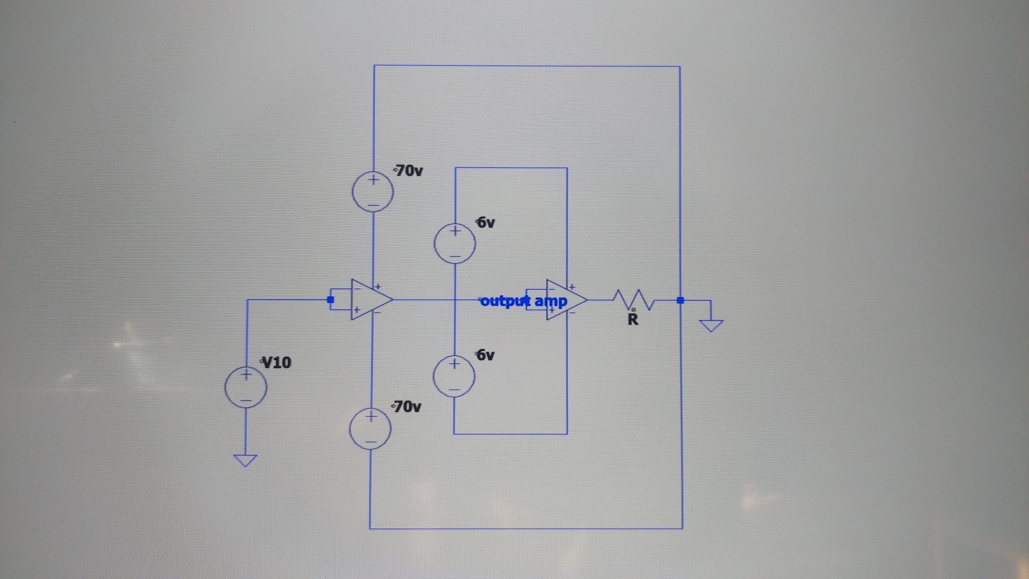

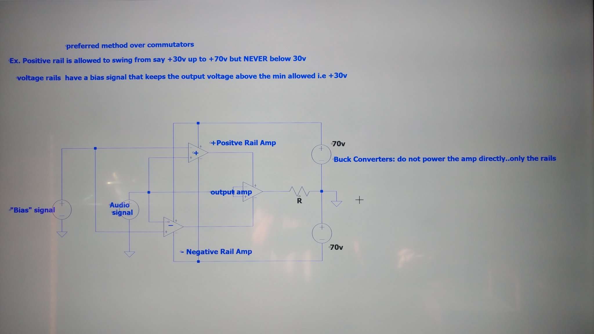

i will respond thus:
1... nope not confusing H for TD... ive used H for crazy high voltages like 120V+ just for SOA on output transistors and its a godsend in those cases
2.... Yes TD is basically a single rail amplifier that is not allowed to "crossover" below the min voltage output... that is the difficulty right there of controlling that beast... then that out put drives one of the rails of a normal amp...so you need two ..one for each rail
applications... i believe that is the A plus D versions ive been hearing about
see concept diagram 1
3.... i believe if the voltage level is kept very low then current draw at either idle or full ouput will not really be an obstacle . You need both power and current to produce heat so if you up the current to lets say 5 amps but at 3 volts... your output devices are being asked to dissipate 15watts...
then as needs arise (musical signals) then you got that voltage swing to go with it .
The A+D method is very attractive because there is literally no stepping of any sort, you have an analog signal from the rails (pseudo DC) used as a power source for another amp (output amp)... is this the way Lapgruppen does it?
4... yes.. using a buck converter - to power the amp directly ( or any switching mechanism whatsoever) will produce the nasties..🤔
its a welcomed head ache...😎😅
5...why am i discussing this idea with ya'll...? ans: to get all of the unseen out of the way to know exactly what im up against
6... there may be a solution.. another type and rather attractive and INGENIOUS has Mr.Pass remarked...
that one provided by Sona, one floating high current low voltage amp being driven by another lower current higher voltage amp...see dia 2
7.. i drawing up method two as i write this..

One idea could be to vary the rail voltages, a la buck converters with a duty cycle that increases when a certain threshold is exceeded.
Ideally, the PSU would be smoothly ramped up in anticipation of an upcoming peak in the analogue signal path. A nice idea for digital audio. Although I guess a "true analogue" amplifier could be also based on modulating and filtering a voltage source to produce an audio signal. It doesn't always have to be either switching XOR linear.
yes....thats exactly my thoughts also. NICE IDEA indeed

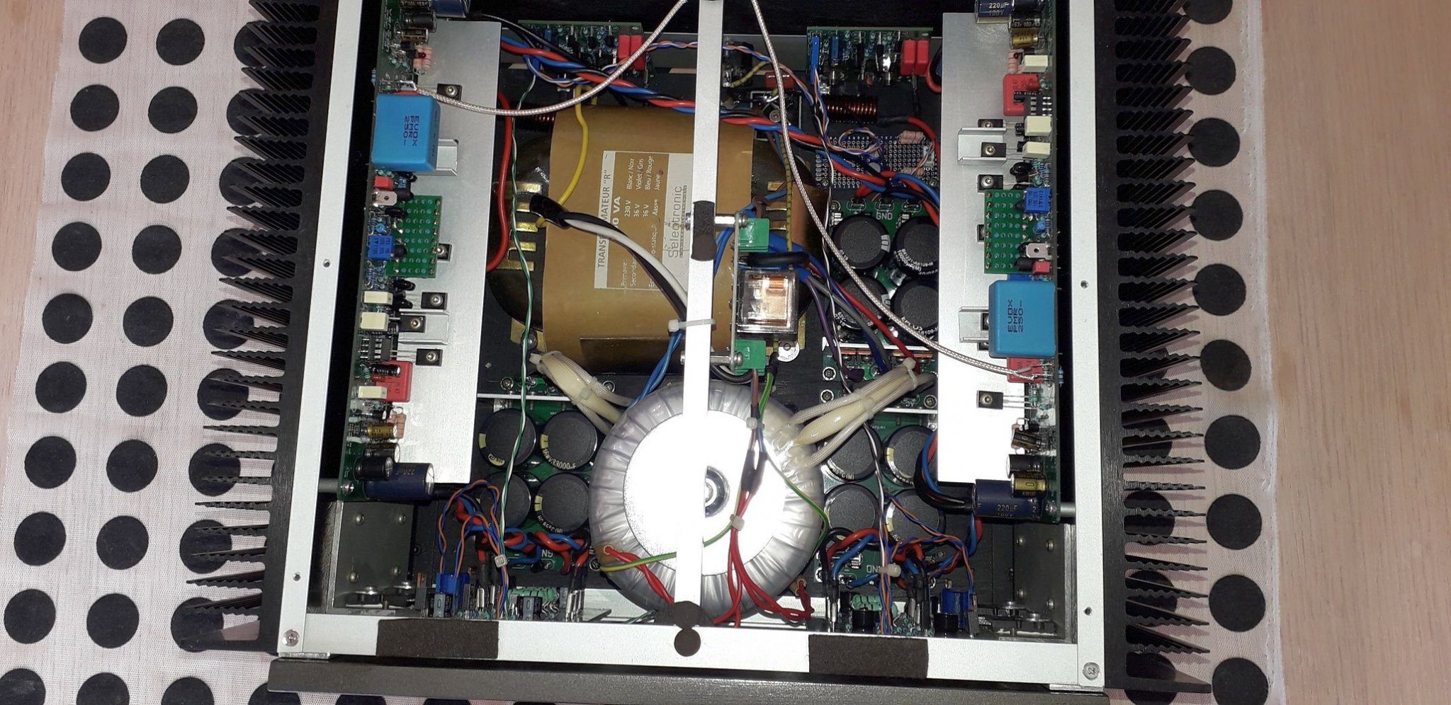

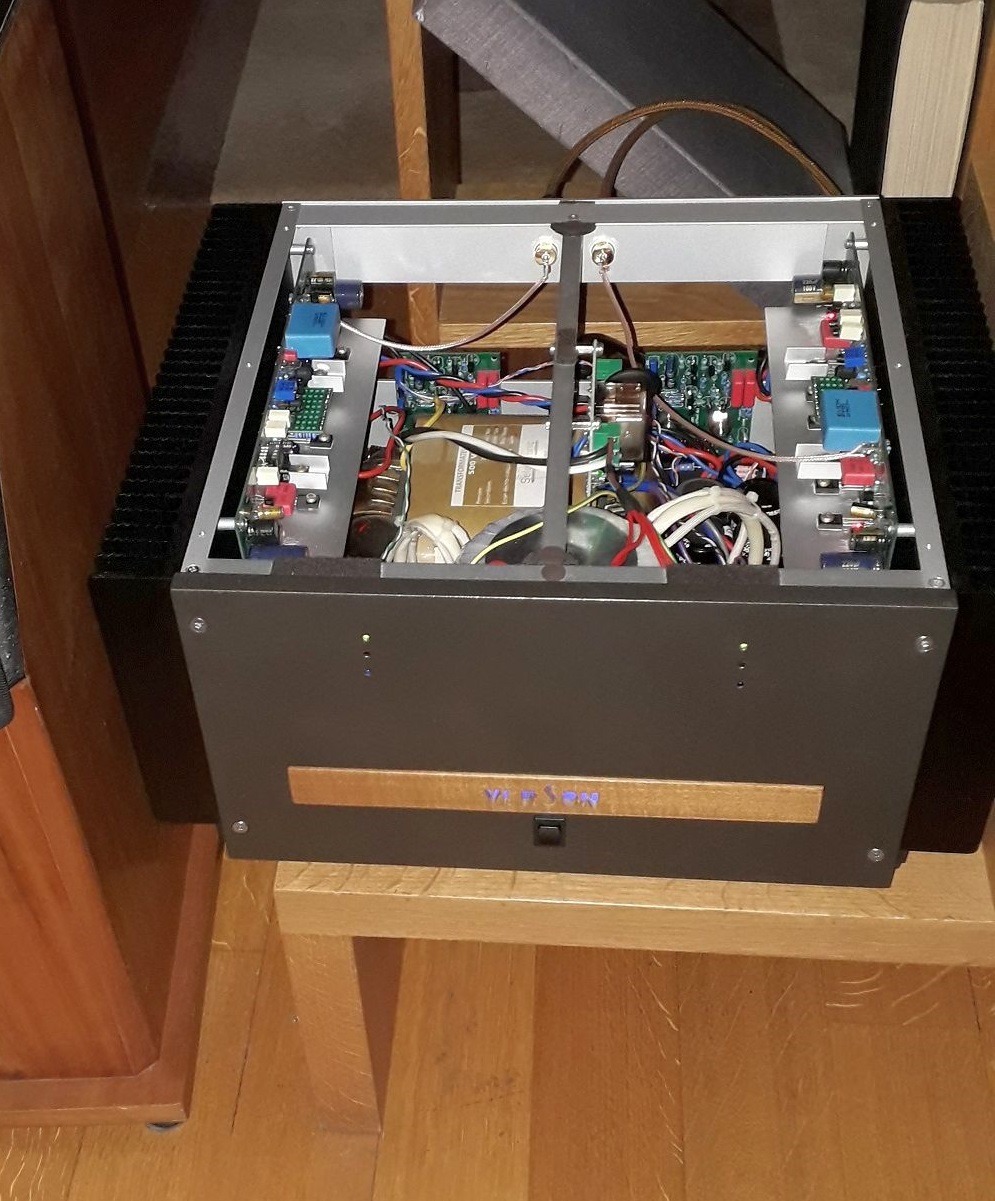

Look at this thread. https://www.diyaudio.com/community/threads/200w-class-a-amp-with-high-efficency.304722/#post-5008854
I have all ready to test it but somehow was occupied with other projects, like one similar to this one but simpler and here is the photo of the working prototype 100W ClassA + ClassB.
Mr Pass pointed me to the SANO patent which is exact y what you're proposing here.. i believe this will work..

Lo and behold...🤭
i was looking at some carver schematics and came across the schematic for one of his powered subs...
Lo and behold... it uses the EXACT scheme pictured here...down to the bias signal to achieve the starting voltage point... 🤓 and i guess our switching artiifcacts become more or less irrelevant at bass frequencies so this scheme is very well suited for controlling dissipation in high powered subs... the rails were +/- 120v !!!! now thats HIGH power.
