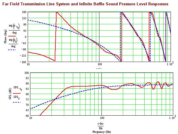

Why are the simulated and measured outputs different? Well, the curves are basically very similar. Did you remember to apply to the MathCad charts the +6db boost gained in system efficiency for having paralleled drivers when comparing to the measured data?
Regards
Scott
All response graphs are similar - IE they are curtailed at both bottom & top end 😉
But seriously I still don't see what you see. I am not talking here simply of amplitude but a fundamental difference. Look at the 30 Hz Dip in Driver output & 35 Hz Peak in Port output as predicted by the sims. There is no evidence of this in the measurements taken by D'Appolito.
There is something causing this difference. Either the sims are wrong (No offence intended here please, just object discussion), or they are being fed different parameters to what actually exist in reality, or the worlds * "foremost expert of speaker measurement" has fudged the results.
I wish D'Appolito were here to state his case.
* Wherever this title comes from I don't know but it has been bandied about often enough.
As do I. It would be interesting to get his views on the matter. Oh -no offence taken by the way. Life would be very boring if we all went around taking umbridge at every objective observation! Besides, I don't claim to be infallible by any stretch of the imagination -I might have been off with the vent dimensions, but I don't think it was by more than a few mm -not enough to make a major change. The best way of ascertaining this is to try it yourself -the worksheets are on Martin's site, along with a free version of MathCad Explorer 8 if you don't own the full version (works just the same, you just have to cut & paste into something like Word if you want to save).
I think the important thing we need to keep in mind when considering all this, is, whether you go with the simulated or the measured data, Thor looks poor, especially considering its high price. If I wished to build a speaker in that price range, and I saw only the measured data for example, I would be very wary, especailly when I saw the crossover.
OK, why the differences, if we're assuming for the moment that my simulation is in the ball-park? Well, firstly, keep in mind that the measured data has clearly been heavily smoothed -speakers are not that flat in real life, and this disguises response aberrations. Looks like 1/3 or 1/2 octave smoothing to me. Note that the dip in woofer output circa 30Hz is still there on the measured data -it's simply been flattened out, which confirms this, at least to my satisfaction. Ditto the peak in vent output, though apparantly on the measured data it occurs a little lower, suggesting a slight error on my part on the vent dimensions -I hold my hand up on that one. It's not that significant though in the overall scheme of things. Staying with the vent output, the remaining climbs, dip and peak just after 100Hz are all still there on the measured plot, albeit flattened out, as is everything post that, though it's not easy to compare at first glance, with such odd values being used in the measured data graph. The rapidly rising response predicted by the sim to 1KHz will be mitigated slightly by the presence of the correction applied to the woofers in the crossover, which is not enough to negate the overall rising trend indicated -there's peaking at circa 1KHz in both sim and measured data for example.

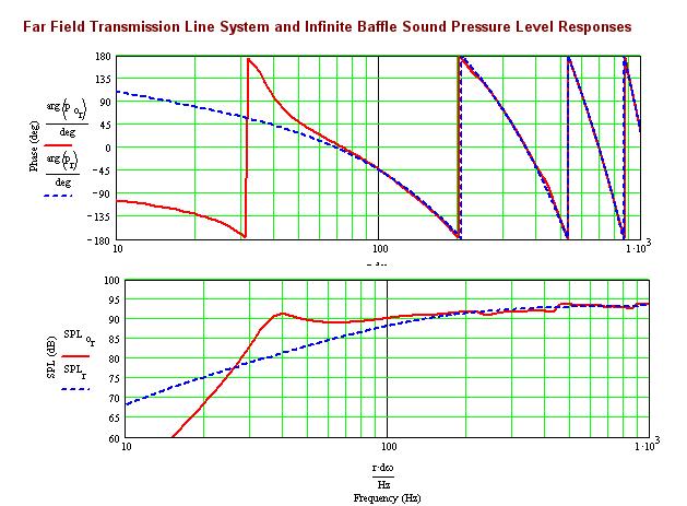

Well this is comforting.
Seeing you're having so much fun 🙂 with this simulation, would
you care to post the results using the Extremis parameters ?
I'm curious to see what the difference would be.

As in, in the Thor cabinet? It shall be done. If I'm feeling generous, I'll see what I can come up with as optimised dimensions for them as well.

Very much appreciated Scott.
I guess the response isn't that good with these drivers. 🙁
Or might it just require that the stuffing density be changed ?

Hey Scott
It looks fine in terms of measurement - very flat - and the measurement matches the claim that f3 = 45Hz
If as you say smoothing has been applied how do you explain the peaks & troughs in port output at higher frequencies? (Octave Frequency band widths increase as the frequency increases). Also look at the driver output, for evidence of this. The graph produced by the mathcad sims looks alot more "smoothed" in this region than the measured result. What accounts for this discrepancy?
If we assume the above to be true then we might say something in the model is not working correctly unless of course the model applies smoothing as well.
Doesn't room response usualy slope upwards @ 12db / octave? This is quite significant in terms of response. I have had experience of listening with my own ears to a speaker in an anechoic chamber. I can tell you that in that instance - low frequency output was dramaticaly less than inroom response. When I say dramaticaly - almost non audible.

Oh, one last graph for your interest. Meet the Thor cabinet -with a single Seas Excel driver. Everything else is exactly as per the standard cabinet Joe designed. I smiled a wry smile. Actually, the ripple you see will actually be less than shown here, as the driver placement needs a fractional modification, which I didn't put in. Blame the doubled Vas of the paralleled drivers. I confess to being impressed (though I still don't like high mounted vents!). This looks much better.
Best regards & enjoy the music
Scott
Scott

That is interesting. As I say I will build the Thors as they are first - then do some fiddling. Will be over the next 2 / 3 months. (If the drive units ever arrive that is)
I have also mailed Seas on the apperent discrepancy - because that sort of thing drives me nuts as you can tell. The reason probably being in South Africa we are so far away from everything that when other people **** specs up - we pay for shipping and its not cheap or easy.
Scottmoose said:Oh, one last graph for your interest. Meet the Thor cabinet -with a single Seas Excel driver. Everything else is exactly as per the standard cabinet Joe designed. I smiled a wry smile. Actually, the ripple you see will actually be less than shown here, as the driver placement needs a fractional modification, which I didn't put in. Blame the doubled Vas of the paralleled drivers. I confess to being impressed (though I still don't like high mounted vents!). This looks much better.
Almost makes you think he forgot to multiply by 2. So an easy fix for the Thor might be to double the cross-section all the way round :^)
