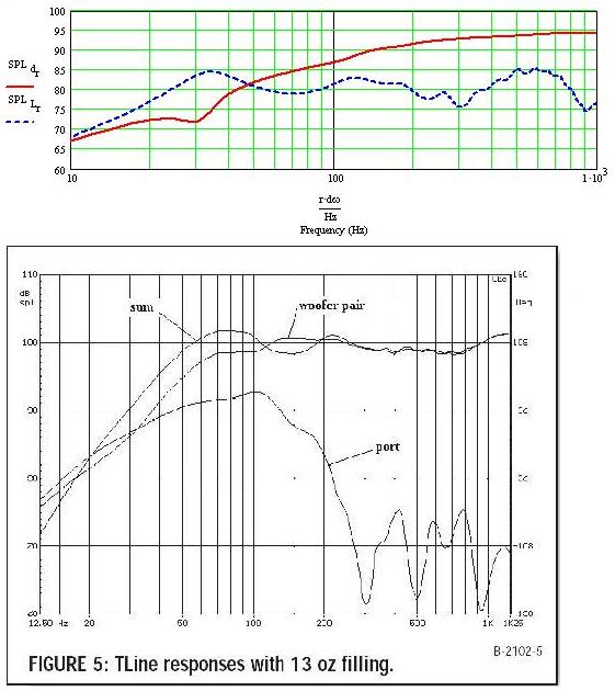

Scottmoose said:
Well, that pretty much confirms it.
That still looks like a response plot without augmentation by the rear wave exiting the TL. Take a look at the delay. In fact it looks very similar to the response plot for the W18 driver measured anechoicly alone. These measurements I have been told are taken by placing the driver in a 6 litre sealed enclosure. Surely a T/L no matter how badly designed or mismatched should best this.
Take a look at this graph from the AE article. From what I understand - this shows the measured response simulated to anechoic response of the Thor, it combines both port and driver output. It does not include room gain.
If I have misread these please could you explain.

Byrd said:That still looks like a response plot without augmentation by the rear wave exiting the TL.
The ripple in the plot comes from the changing of the phase vrs the front of the driver, so there is no way the plot can be anything but the sum of the responses....
maybe Scottmouse can post the driver & terminus response curves?

Byrd said:Dave - I am now quite confused. Could you possibly provide an explanation as to how the attached graph has come about? Is it an in room graph?. If so it is pretty flat.
The chart i was talking about was the Scottmoose sim... that is one from the aXp article, the one
Scottmoose was complaining about wrt lack of info on how it was generated.
And it is very fishy... how can port output that is some 10 dB down from the main driver output boost total response 3-5 db?

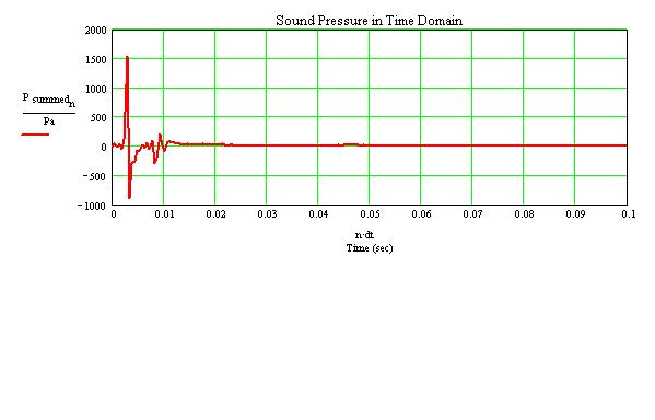

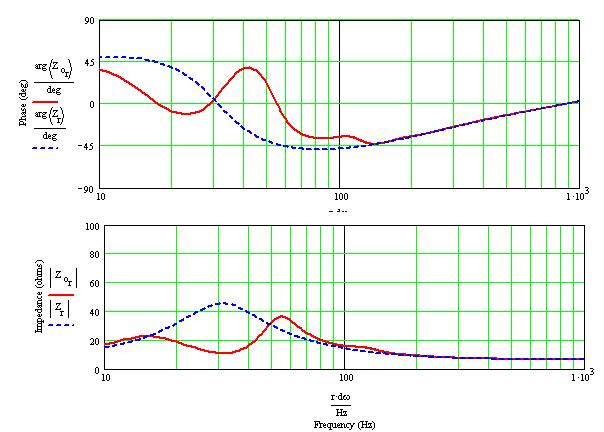

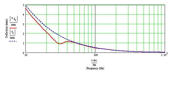

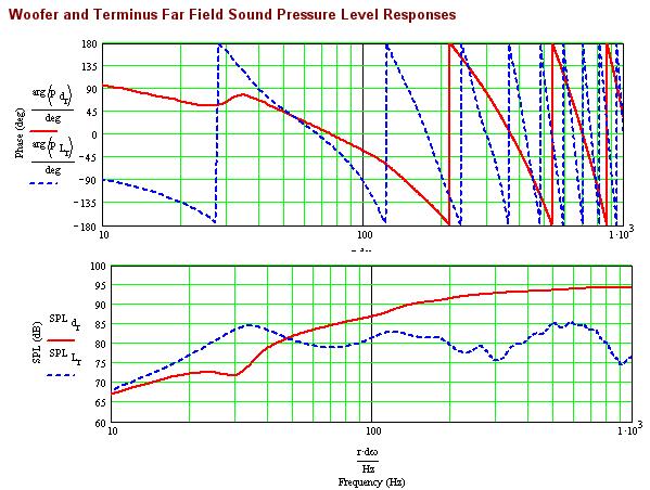

Driver & terminus response curves? Your wish is my command Dave. Coming up in the next post. For now, while I wait for my other PC, which has the MathCad curves on, a few other observations. As for the audioXpress graph looking flat, indeed it does look flat. There's a reason for that. First, note how there is nothing even resembling a jagged peak or dip in the plot, indicating smoothing, most likely 1/2 octave. Now observe the 'woofer pair' curve, which is the most relevant one, and how it sags at 100Hz. Finally, note the slight trunkating of the graph, which disguises aberations.
Joe is certainly not stupid, he is one of the great designers of modern times, but however many excuses are made for it, on the lines of 'it doesn't look too bad', Thor is not one of his better efforts. Agreed with the idea that he probably just doesn't have a whole lot of experience with TL design, though, going by the audioXpress article, he went about it in what I would consider a highly amaturish way unworthy of him. Thor's an externally handsome speaker, using some very pretty drivers, which are also very good (OK Martin: I won't give up on them just yet!), but looking at the plot, you can equal or better them in this respect for half the price. Yes, I know, plots aren't everything, but they do tell you a lot. For example that you'll need a massive boost from room gain to get down the the 25Hz frequently mentioned by subjective listeners. Fair enough, I won't argue, but that's the room they're listening to, not the speakers, which is not, in my view, ideal. Thor is a rocky design in my view. But on a positive note, compared to most commercial designs of equivelent price, they're streets ahead. Which just goes to show what a rip off commercial speakers are. It's by no means the worst speaker out there. But it's far from being the best. If you've built them, enjoy them. You've got some terrific drivers in a rather dodgy cabinet (and I hear dark mutterings about the crossover too, but that's for another day). We'll try to come up with something better for them to go in shortly. At least, being MDF, the cabinet isn't overly expensive to make, and represents only a minimal part of the material (if not the time) costs.

Why are the simulated and measured outputs different? Well, the curves are basically very similar. Did you remember to apply to the MathCad charts the +6db boost gained in system efficiency for having paralleled drivers when comparing to the measured data?
